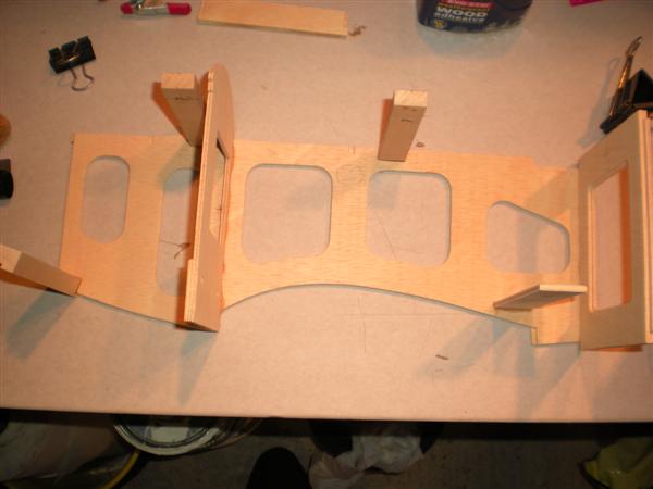

Well TFF here goes...

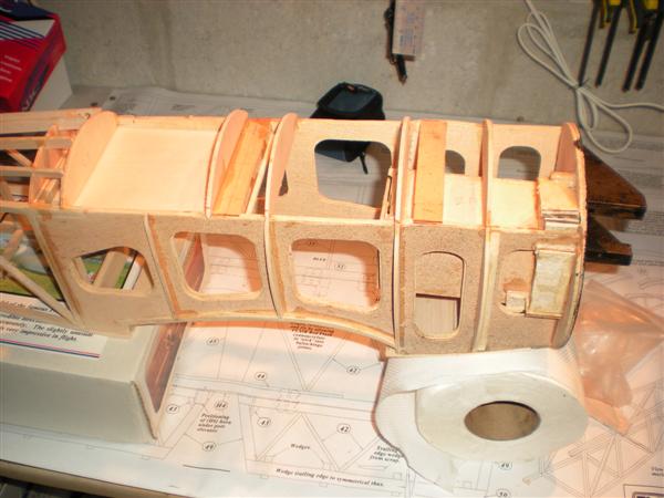

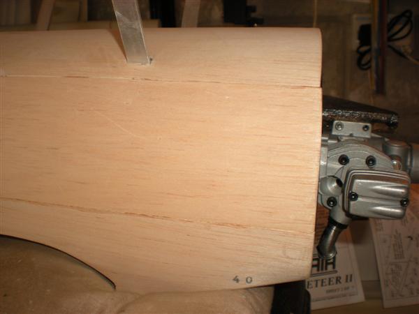

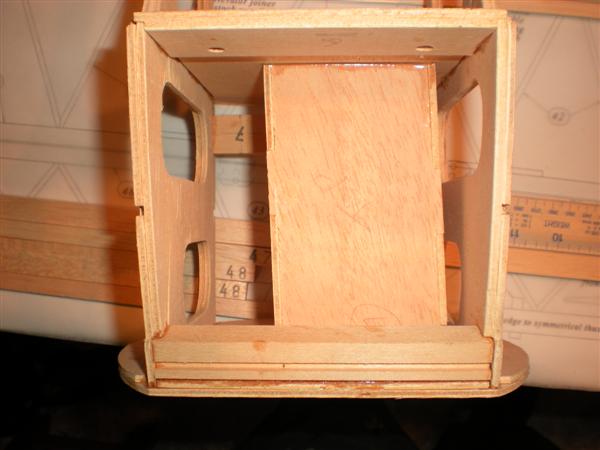

These 3 pictures show what Flair mean about left and right handed fus sides when laminating the main body........... I made sure I numbered all the die-cut parts before taking them out of the sheets.......
RE: Flair Puppeteer Build

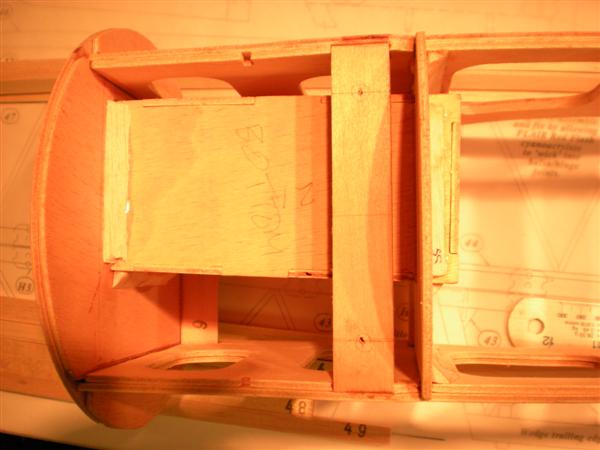

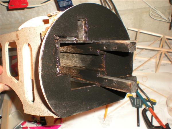

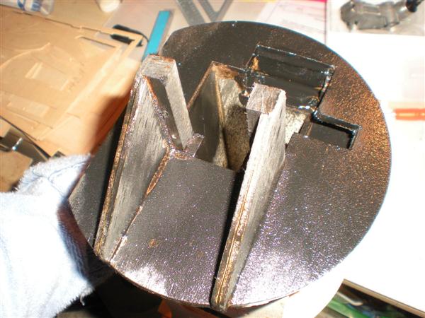

These pics show thebox in place....the plans shown the orientaton of the box sides as they appear in the plane. As long as you number the parts, dry fit first and DOUBLE CHECK the open end has down and right thrust angles at the front you should be OK.

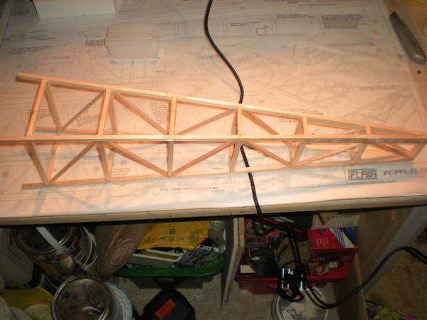

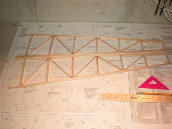

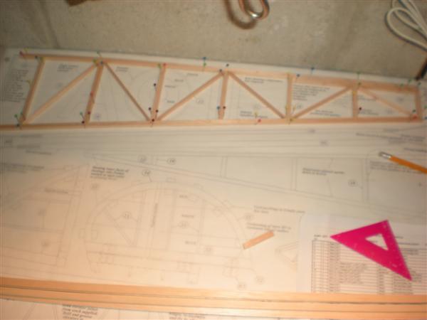

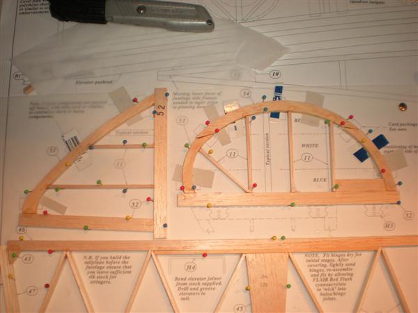

Started on the tail yesterday. Covered the plan in cooking grade grease proof paper and carefully measured and cut andd hand trimmed all the balsa. Pin it well down and I used super glue, medium thickness. Left it a few hours then carefully took out the pins put another layer of GPP on the side already built and built the second directly on top. You then have 2 matching halves. The GPP comes off quite easily and a light sanding gives you a great finish.

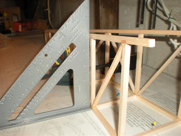

This morning carefull cut to length all the cross members sanded to fit and cyno glued them in. For reference the angle of the cross member cut is 5 degrees. Double checking that the fus sides are perpendicular to the lower cross members and therefore the "oil rig" as the plan refers it to is parallel.
I will now wait until everything is thoroughly set, probably 24 hrs.

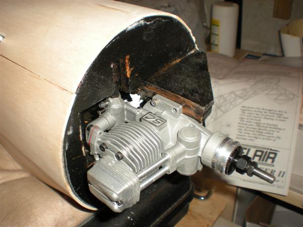

Hi

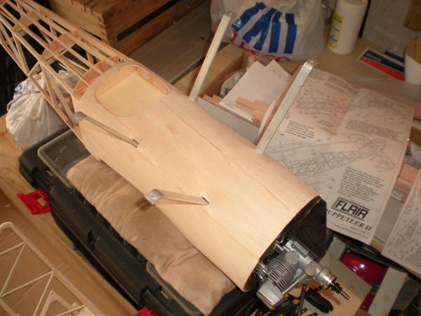

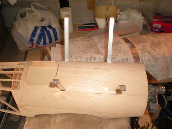

The four stroke took a bit of work to shoe horn it in, but its OK now. The cowl is cut for the exhaust and will need some fine tuning. After looking at the plans in detail for the wings and undercarriage it seems that the U/C wire legs attach themselves to the bottom wing making it a real pain to get the bottom wing off. Therefore I think it would be best to leave the wings permanently attached??? Would you agree. If this is the case then I could go the whole 9 yards ( as you chaps in the colonies would say[X(] ) and try to copy all the rigging detail.

I leave my small biplanes all together but last weekend I came in too hot and flipped one, breaking the bottom wing mount. Not a lot of damage but sure was a pain to take apart. It has music wire for flying wires. I have another with kevlar fishing string but it has stretched some so if you use some of that I would pre stretch it. I would go for it.
Vincento discussed this on the other thread. If you can manage to transport your Puppeteer fully assembled by all means do that! It will save tons of hassle and just make it more fun to pull out and fly. If you can't get the fully assembled model in the car, you might to see if you can get it in with only the top wing removed. And, definitely, you've got to have rigging on a WWI model! Besides, functional rigging will add to the strength tremendously. I also used music wire for the rigging (which is pretty close to scale for the Pup).
Personally, I wouldn't bother with the sound module. That might work with an electric motor but probably won't be heard above the sound of a 4-stroke.

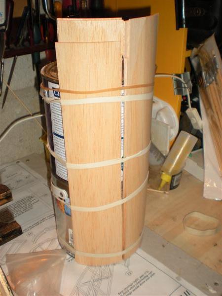

So here we are with some pictures of the fus 50% done and now forming the sheeted sides. I put boiling water on the balsa to help the curve. The sides of the balsa always curve away from the side you put the boiling water on so this will aid the bending. I will leave the sheets a few days to dry thoroughly.

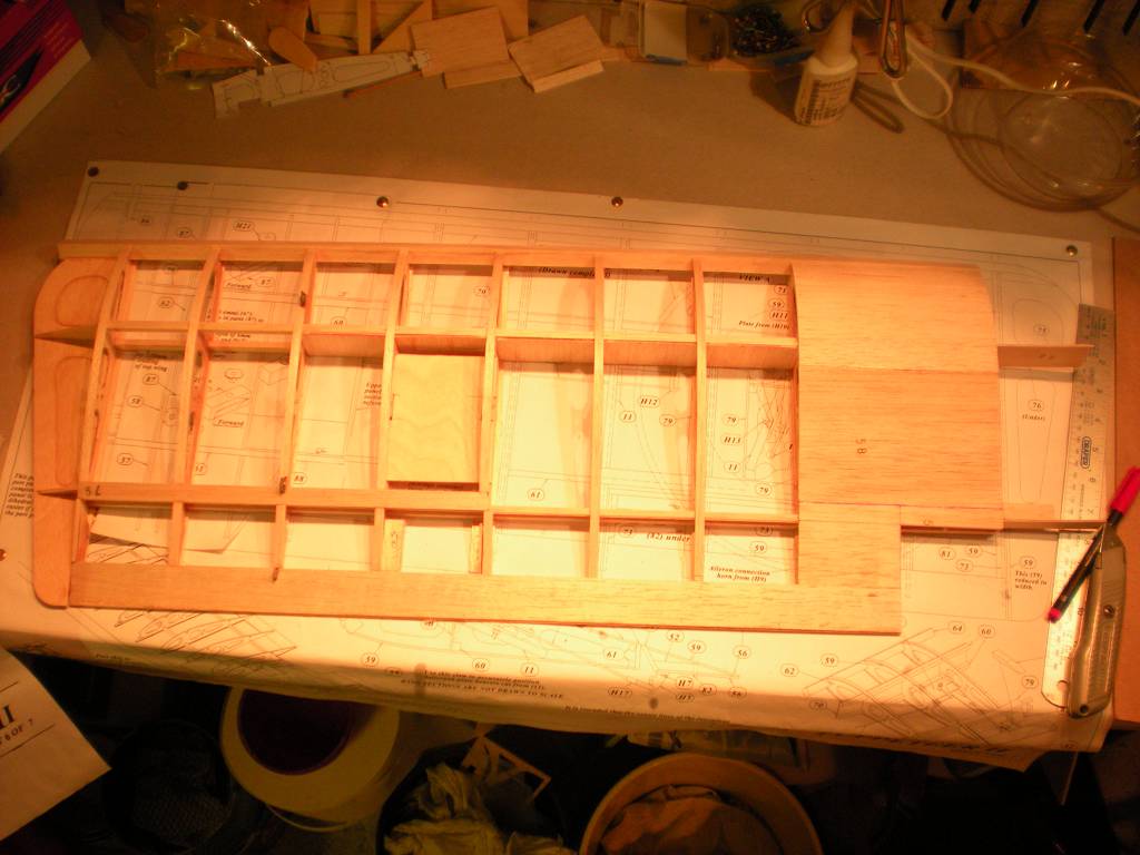

After a break for a holiday I started on the first wing half. Starboard lower one. The drawings don't make 100% clear that the aileron spacers need to be apart from the main ribs. A bit of head scratching was done but I finally got it figured out. I will post some better pictures in a day or two.
So Hols are over and I have almost finished the starboard lower wing. As you can see I will not sheet until the wings are mated and glued, I want to make sure the bracing slides in good and there is plenty of epoxy all round the main structure. Before that wing join I will cut out the ailerons from the wing....it should be easier with 2 halves.
Here's the progress.........
