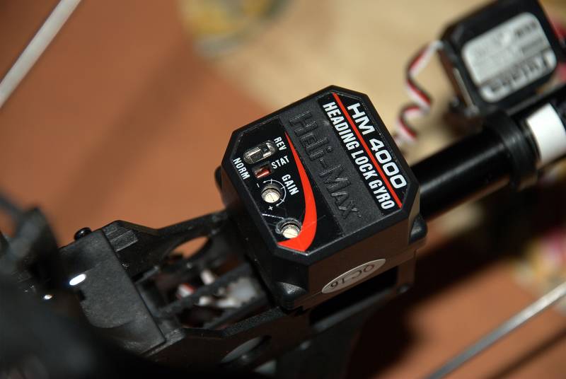

#87
My Feedback: (10)
RE: Helimax 400 3d
http://manuals.hobbico.com/hmx/hmxm1012-manual.pdf
Set up manual for the HM4000
FYI there is a hidden trim pot under the label right next to the gain pot. Also when you change gain there is going to be a slight trim drift. So find the gain setting you like and leave it in HH mode all the time. 45% on a Futaba seems to work really well on the AXE 400.
Jason
Jason

RE: Helimax 400 3d
Jason 3, How did you find out about the hidden trim pot? I havent tried it yet, but maybe this is the reason why I had to set the subtrim in my radio at 70 on channel 4 to get the gyro to center when switching from Rate mode to HH mode. Will look into it and let you know.
#89
Join Date: Jan 2002
Location: RIDGENew York
Posts: 594
RE: Helimax 400 3d
Wow, I just took apart the old HM 4000 gyro that came with the heli to look for this second trim pot and thats just what I found. Since I had the case open I cut out the covering from the inside out and put everything back together. Then I memorized the position of were the pot originaly sat, hooked everything up and tried it out. WALA, subtrim is know at 0 and the arm holds when switching between HH and Rate.
Then I turned my attentions to the AXE, I cut out the hole position to match the old gyro and turnded everythingon. Then I set my radio back to 0 subtrim and used the newly found trim pot on the radio to set the HH to match the Rate position. It only took about 1/16th of a turn to get it just right. Know I actually get the same amount of left throw as Right because subtrim isnt being used in the radio.
Truly thankful you posted your find Jason 3-Danhakl, I cant wait for the weather to get better to try it out.

RE: Helimax 400 3d
I guess I am going to have to find a local heli guy to help me out as I still can't get my AXE 400 dialed in correctly.. I have to set the rudder sub trim to R 38 just to get the gyro to somewhat hold and for the gyro sensitivity on the radio if I turn it above like 20% it won't hold at all seems like the higher the number the less gain it has. I just wonder if that new trim pot you all have found has anything to do with this. There is one weird thing is I can't get the servo arm to be at 90 degrees on the tail servo as the splines are just wrong if I take it off and move it over a notch either way it’s too much the other way. I did notice with the subtrim setting at R 38 it makes the tail servo at 90 degrees, but then the tail pitch isn't neutral, but it is centered on the shaft if that makes sense...
Electron
Electron

RE: Helimax 400 3d
From what I can know tell, this pot adjust the drifting of the gyro at neutral stick position. When this pot is moved a little to the left or the right, The movement of the servo arm drifts to the left or right. This drifting is what was causing me problems and why I had to use subtrim in the radio to stop the drifting either way. But as we all know, using subtrim changes up your endpoints as you add in higher percentages. Know that I fine tuned the gyro with this pot, to elemenate drift from center, I can know set everything up correctly in rate mode, and then switch to HH and lock everything in.
First, what radio are you using and what menu in the radio do you have activated to adjust gain?
Second, You want to set up rate mode by setting the gain to 45% on either end if your using ATV's to adjust gain. If you using a gyro menu like on the DX7 then you want to use a number higher than 50 for HH mode and a number lower than 50 for Rate mode. I would suggest starting with 65 for one position and 25 for the other. Control should be on a switch like the gear switch so you can hit it to toggle from one mode to the other.
By doing this you might know be able to find a spline that puts the arm very close to 90 degrees. Know its time to make sure your in Rate mode and hover the heli and use mechanical devices to get the tail to hold straight without any drift. You will increase or decrease the length of the pushrod to do this, not the trim in the radio.
When you can hover in rate mode and the tail stays relatively still, you can go to HH mode by hitting the switch and she should continue to hold that same position.

RE: Helimax 400 3d
Sal98,
I am using a DX7 radio.. The problem is that if I set one at say 25 and the other at 75 the one at 25 will adjust the servo when the tail is moved but the one at 75 when I switch to it does nothing. The servo stays centered but if you move the tail around fast or slow it doesn't move the servo at all... I can set one at say 10 and the other at 20 and the only thing I notice then is that the one at 10 seems to be more sensitve than the one at 20.
Thanks Electron
Thanks Electron

RE: Helimax 400 3d
That does sound defective. When I called Helimax they sent me a new one in less than a week. Also when I told them about the trim problem with this one ( that was really just that secret pot being slightly off) they said they would send another one out as well. So I,m just trying to say if you think it's defective give them a call and let them send you a new one. I know it would be easier to buy the 401 but for the few minutes of your time that it would take to call, would be worth saving the 200 bucks for the 401 combination.
