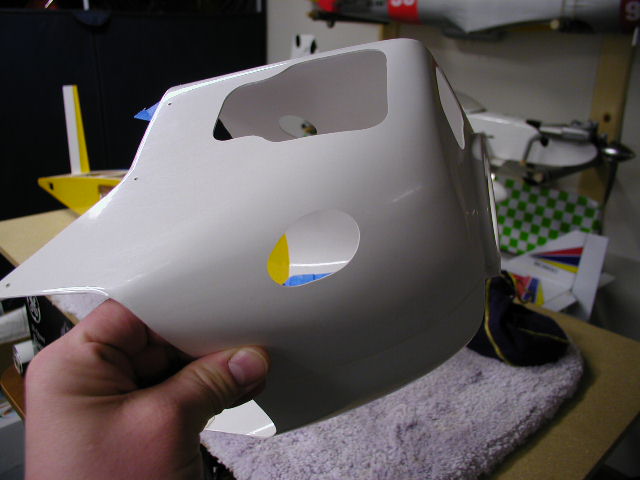

See my pic, I used Pactra Canopy tint, you'll find it in the Car section of your LHS. I took 400 grit sandpaper and roughed up the silver area to make it look like aluminum. I used a litttle too much tint, and it came out really dark, I almost bought another canopy since I spent so much time on the instrument panel and pilot, but in the bright summer sun (finally) you can see in there. If you build it and have a grass field, shim the gear. I didnt and had to improvise, I took 3 small #2 shcs and put them into the hardwood LG towards the TE of the gear, gave me the fwd cant I was looking for, only prob now is the pants got destroyed. I am going to order some Sig SE pants, they have taken so much abuse at our field. My SE is my trusty plane when I just want to fly.
The stock cowl is a pain, it was my first cowl actually, I almost threw it away but couldn't bear to part w/ the dough on a Stan's, plus, remember planes crash.

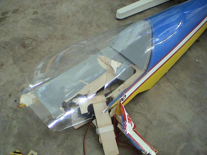

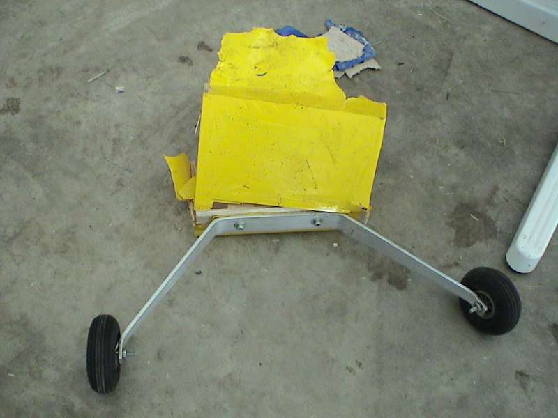

I lost my Giles last week on final approach. I had mine with a OS.61FX using a 12x8 prop. Loosing the plane was a combination of my mistake (low altitude on final) plus the snap tendency of the airplane when pulling up the elevator too fast. I will receive my new kit this week and can't wait to start building.
After reading this thread since 2002, I find too little about the snappy tendency of this airplane. I did no more than 20 flights with mine since I was still trimming it.
Could you guys that love and have had this airplane for a while add more about the elevator setup and snappy tendencies?
Sincerely,
Pedro
Sincerely,
Pedro

First, sorry for the loss. If you have a computer radio like my Futaba 9C, put the elevator on the 3 pos switch, low for takeoff/landing, center for aerobatics (mid way between low and 3D) and the top for 3D only (i.e. the high rates in the book to start). Second, the plane needs to come in hot, that's just pratice, which I am still working on too. I have one of the field experts land for me until I get used to the plane. I think part of my problem is the fact that I have so many fun fly/3D (U Can Do, Sig SE, Fun51) that land so slow, esp. the UCD which almost lands w/o any ground speed, you might not feel comfortable w/ using all the runway!
Try your ele up high (4 mistakes?) so you can dial in the right rates to keep from snapping.
Not too rub salt in, but any pics of the crash? Really wondering where it broke/why? Was it totaled? There is discussion in the thread about some potential weak points, you might want to address it in your new build.

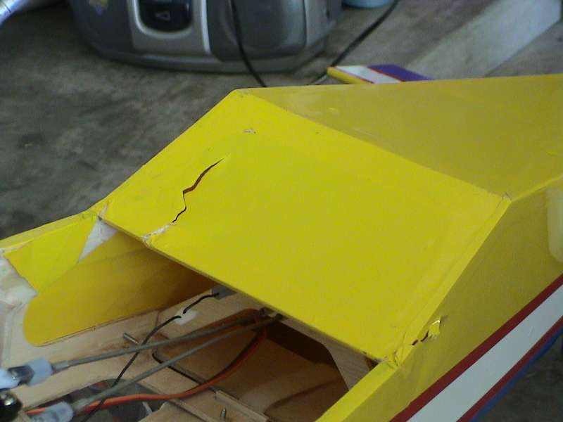

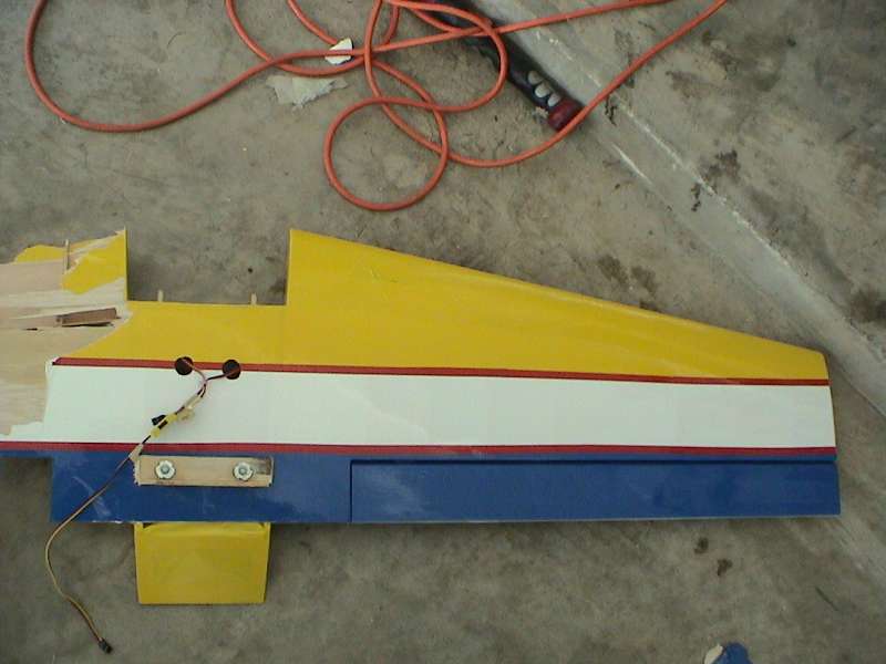

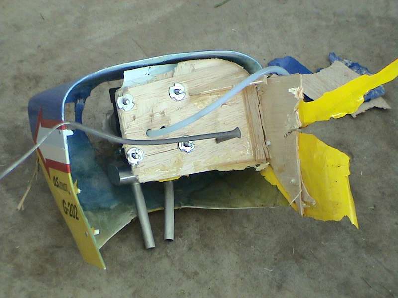

For all Giles owners, here is the result of the autopsy. The giles found ground with the nose at a 45 degree angle between nose and left wing. The tail section is completely intact. The suspect weak point of the fuse behing the wing saddle resisted the impact. Damage in that point is minimal compared to the landing gear section. You can see the right wing is also intact. The nylon bolts resisted the impact. Due to space constraints, I will post additional photos in a second post.

I used the stock PVC cowl with an fiberglass cloth reinforce. The fiberglass kept the cowl is a reasonable good shape considering the impact. We can just imagine the force of impact by observing how the hard tube of the pitts muffler was bent. The langind gear section ripped off completely. I would say the weakest point was the leading edge of the wing saddle. That point desintegrated completely.
I will start recovering all controls and engine this weekend.
Any questions ?
Pedro

I shed a tear! I looks like mine.....I hate when that happens. It's an easy plane to build anyway, so get moving! I have a question, did you thread the wing bolt block in the fuse or use blind nuts? I cant believe it ripped it out w/o breaking a bolt. Will you make any changes to the build? What enginer were you running? 61FX? It looks like some people have been running a TH75, my friend has the TH 46 and man is that engine strong! Well, gotta get to the field.......trying to get thoes pics out of my head.

RE: GP .46 Giles---Misc Stuff
Hi Mac,
I was using a OS.61FX. I was using a 12x8 prop when it happend. I used blind nuts to hold the wing. The bolts holded very well. You can see from the pictures, the block that supports the wing is still attached to the wing with the two nylon bolts in it. On this new build, I will not make any mods. I will keep using blind nuts though. But I will change engine. I think I will use the TH 0.75. Although I am a big fan of O.S.
Pedro
