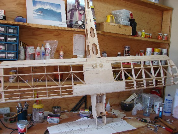

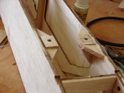

Well...I guess if tigerdude is out of the game, I'll pick up the build where he left off. This is an expensive hobby...no getting around it..I hope that tigerdude makes a comeback and completes his build.
So far, I have done what several guys have done...I took out some dihedral..and used that opportunity to add additional ply supports in the center of the wing...I think that one just is not enough...at least not the way I fly.
The shots below also show the mounting brackets that I put in the fuselage to allow the wing to be mounted with plastic bolts instead of the rubberbands. The trailing edge of the wing, around the mounting bolts was built up solid, and then I put a ply plate on the top to spread the load.

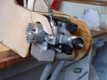

There is a shot of the engine installation...it has a Pitts muffler..which made it too wide to fit within the sides of the front of the fuselage...so I had to take the right side out...but I will cover the top of the engine which will give it a cleaner look.

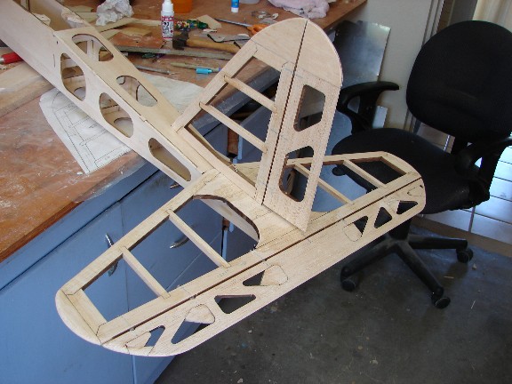

You know...this is a big plane...below is a shot of the wing on my CG Chipmunk..which is a little underpowered with a Magnum .70 four stroke. I hope that all of the people that have suggested that a .25 two stroke is plenty powerful are right.

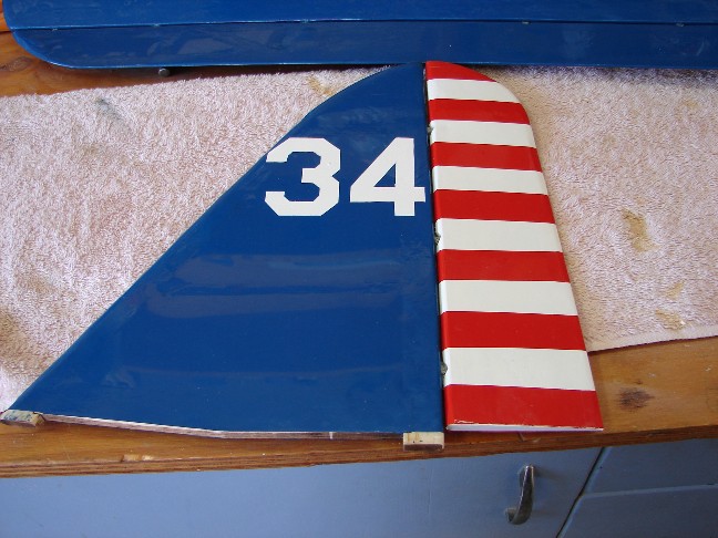

I have done some work on the tail feathers. Both the fin and the horizontal stab look unnecessarily ugly and cut off. I know that this must be to make the plane easier to cover for people with little building experience, but it does look like someone got after the plane with a chain saw. Below are shots of the tail feathers with my very easy changes...I've added a little weight to the rear of the plane..and I've lost a little of the stab area...but it was worth it.

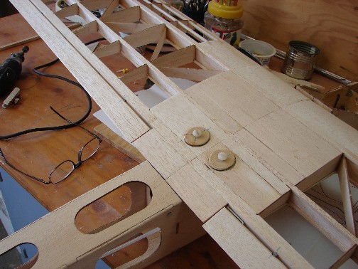

Finally I have a shot of the wing which is just about ready to be covered. You can see the mounts for the screws on the trailing edge which hold the wing down...they are not as artistic as I wanted, but I was having trouble getting the screws properly recessed..
The next up-date will probably have the radio installed....See you then...

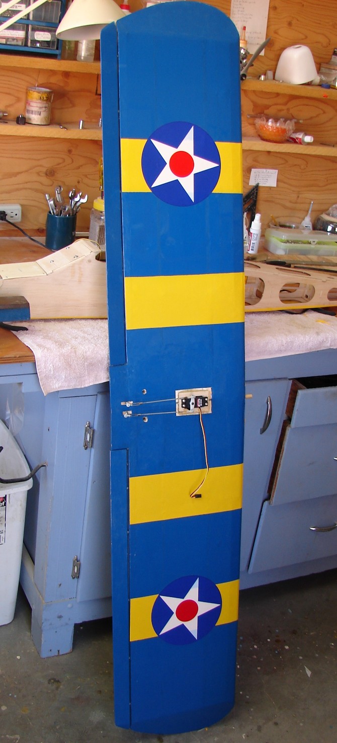

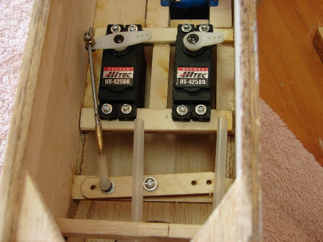

First a couple of non-aircraft related up-dates....our internet connection is running again...always an adventure here in Mexico...and our house guests have departedso...back to work

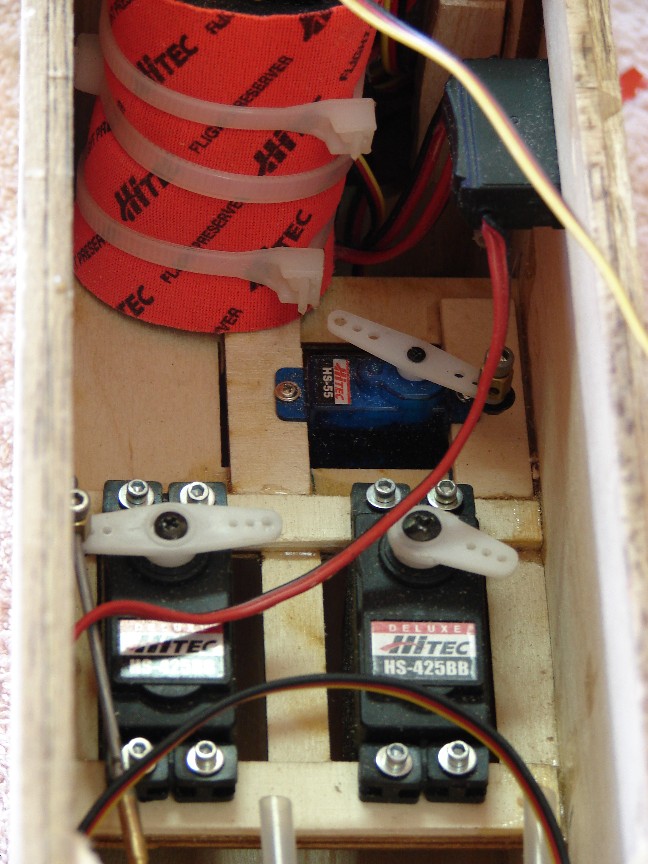

I feel a little like a Chinese worker in an ARF factory...covering is a little bit tedious. Attached are some pictures of the tail feathers. Nothing special..the numbers are just trim material, and the red and white rudder is the result of covering the rudder with white oracover and then using some red trim sheet to make the stripes...easy and it looks good.
The picture of the servos shows another deviation from the plans. The tiller bar which operates the tail wheel is designed..on the plans..to be operated by a piece of whire that goes from the rudder servo to the tiller bar. The "attachment" at the tiller bar is the problem. The plans direct that this wire come up from underneath the tiller bar..but no attachment system is provided. It appears that the designer thought that it would simply stay in place by friction...or some other magical device. When I hooked it up as suggested in the plans two things happened...first of all, at full right rudder the wire fouled the servo and limited travel in that direction...when I tried it again, the wire fell out and locked the rudder in a full right position...good luck landing it in that configuration.
I could have worked out a system for more securely attaching the wire...and I could have rebent the wire to a more useful shape...but why bother. It was literally easier to build a new linkage out of ball links and 2-56 wire. It is much more secure....entirely slop free...and it looks good.
Next update will probably have the wing done...I'm working on covering the ailerons now...see ya...

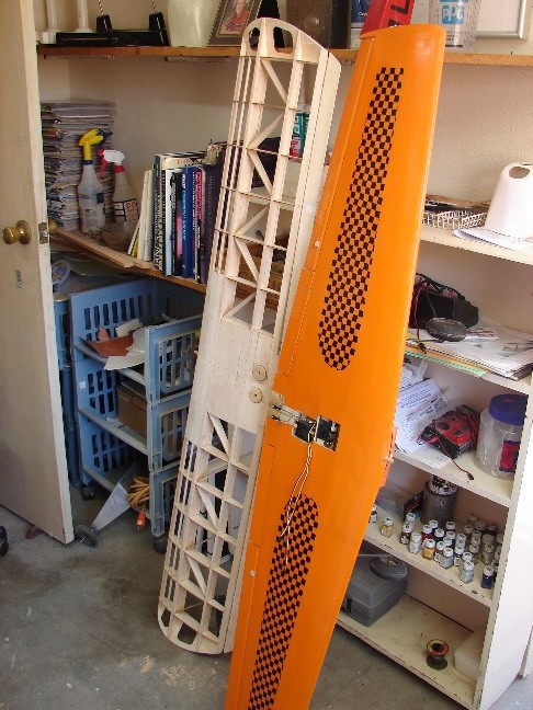

Time for another update..actually these updates are determined by how fast (or if) my internet connection is running..if its working well..I'm happy to put stuff up.

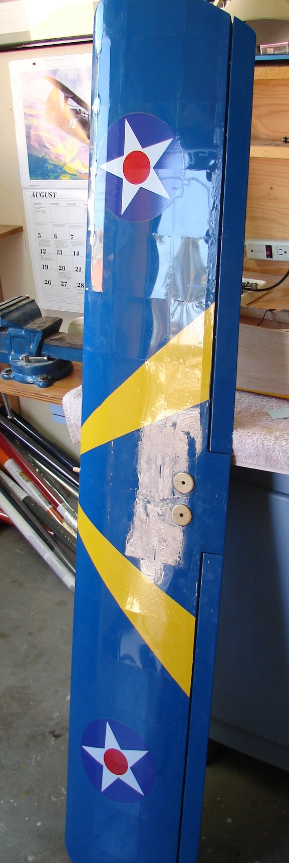

The wings are covered and ready to go..again I am struck by the size of this plane. I have never seen a plane this size for which a .25 engine was recommended. Below are some shots of the top and bottom of the wings...I did discover that for attaching trim, the solution sold by the monokote people is hard to use. It seizes up right now. IMHO ironing the trim on is MUCH easier. Live and learn.
The servos and receiver are in as well as the fuel tank. There is a lot of room inside the fuselage for your equipment. I put the battery in the recommended location...all the way forward against the firewall. I have had a quick and dirty look at the balance of this plane and it looks pretty close...probably a little weight in the nose...
From the pictures below you can see some changes on the front of the plane. According to the instructions/plans the windshield is to be glued in place. I wanted to make it removeable so I could more easily get to the fuel tank. You can see that it is held in place by three 4-40 screws and blind nuts. The hatch which is supposed to be removeable is attached by four small sheetmetal screws. Both of these pieces will be covered over so that to access this area I will have to cut the covering. I hope to end up with a relatively accessible area and still be clean and neat. We'll see...Next update will probably have a completed fuselage...

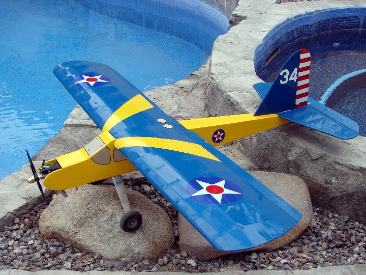

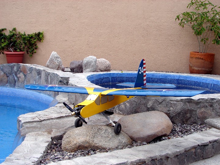

This is the last up-date. I finished it up with a few more changes. I substituted larger wheels for the suggested 3" ones. Where I fly it is a little rustic and it is not unknown for me to need to land in the dirt...so I have larger and stronger wheels front and on the tail.
Attached are two photos of the finished product. I did not post a picture of the underside of the wings which has two, broad yellow stripes running from the leading edge to the trailing edge on both sides of the wing. Anything to help me see.
I read the instructions for the TT .25 engine and it was suggested that this engine doesn't need much break-in...so I ran a little less than a tank through it...and today I went to the field to go flying. The control throws were set as per the instructions and resulted in a very midly flying plane almost difficult to turn...but probably much harder to get into trouble.
It taxied very nicely for a tail dragger and I was able to cleanly take off without incident in a 10mph cross wind blowing 90 degrees to the runway..,.for my skill level this was impressive...on most days this would result in the wind getting under a wing and rolling me over. On the other hand I was concentrating very hard so as to not crash my plane in front of the local club members.
After I stopped shaking I noted that it needed a fair amount of down trim on the elevator...but maybe I started off with too much up-trim...anyhow when the flight was over the trim that I had imputed was not much more than a 16th of an inch...by the way, when I balanced the plane it needed weight in the front but my heavy prop nut from Higbey created perfect balance.
The landing was also in a cross wind but I kept it on our fairly narrow strip...all in all a very nice day...one more note... the Pitts style muffler is wonderful...the plane required absolutely no clean-up after the first flight...I'm not building anymore planes that don't incorporate this style of muffler. This is the end of this thread for me...anymore up-dates will be on the crash page.
