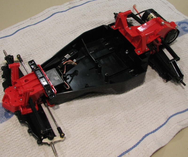

Here is the rear gearbox attached to the chassis tub. Rear shocktower is that huge red thing. I also took a pic of the underside of this - attentive readers will notice the black skid plate that now covers the bottom of the red gearbox.

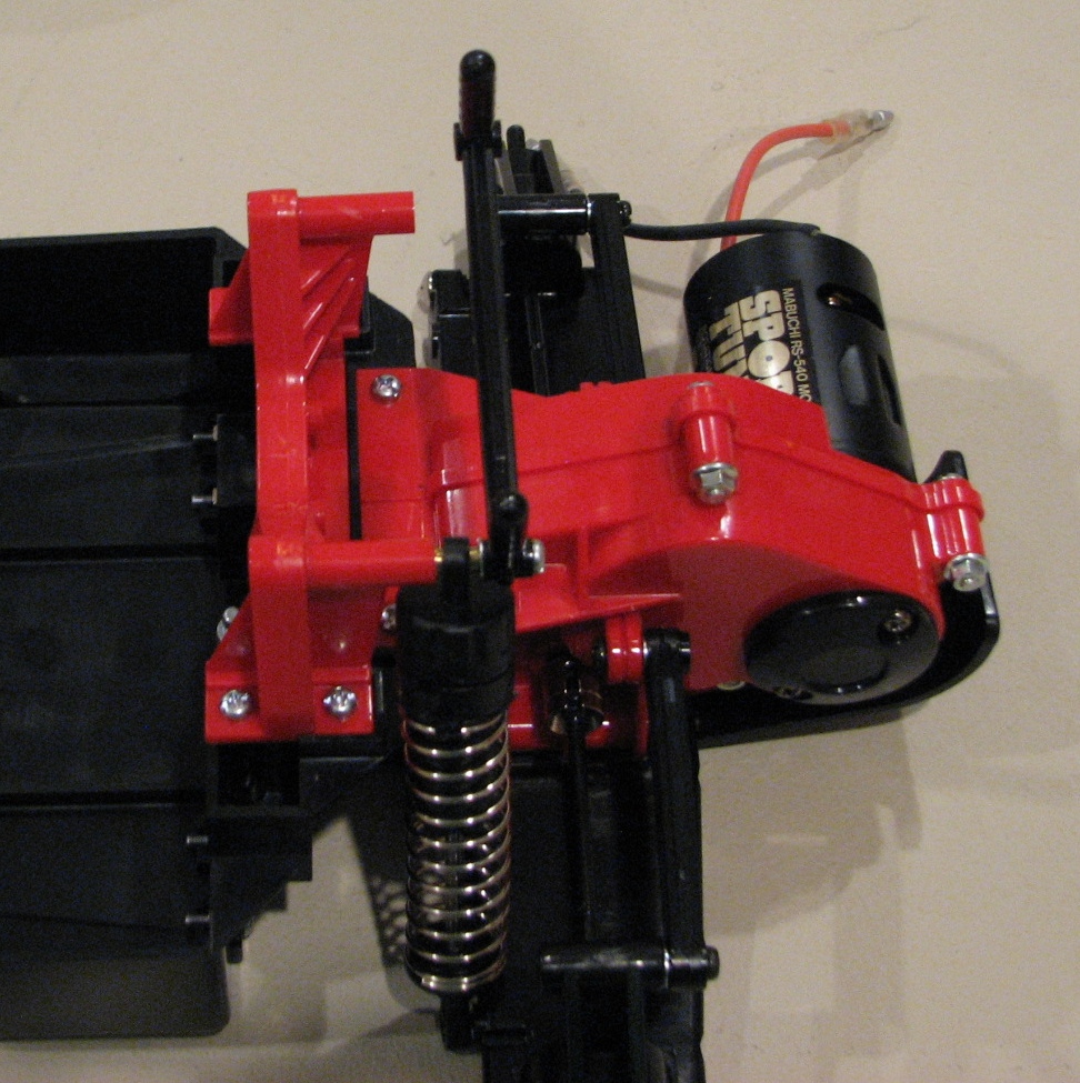

Here's one thing I noticed that was odd - while attaching the rear gearbox to the tub, the instruction had me put 2 of these rectangular black pieces onto the rear/bottom of the tub. They attack with a screw/nut combo - I've boxed them in red here (both on the outside of the tub, and inside in the 2nd pic).
Why the heck do these exist? From what I can tell, nothing attaches to them. What am I missing here, in understanding this?

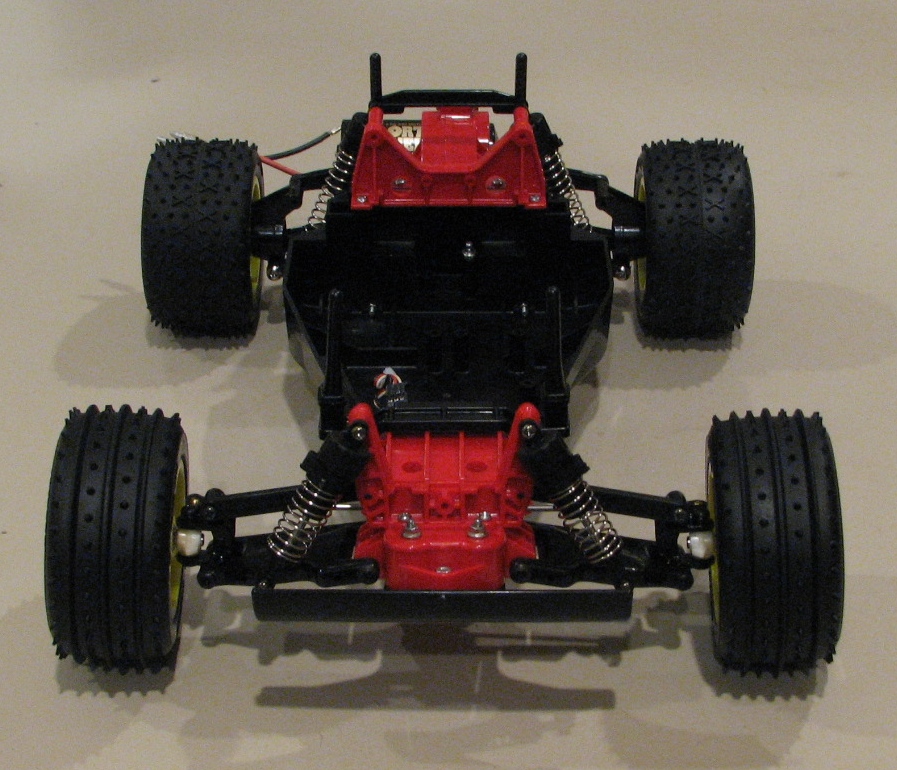

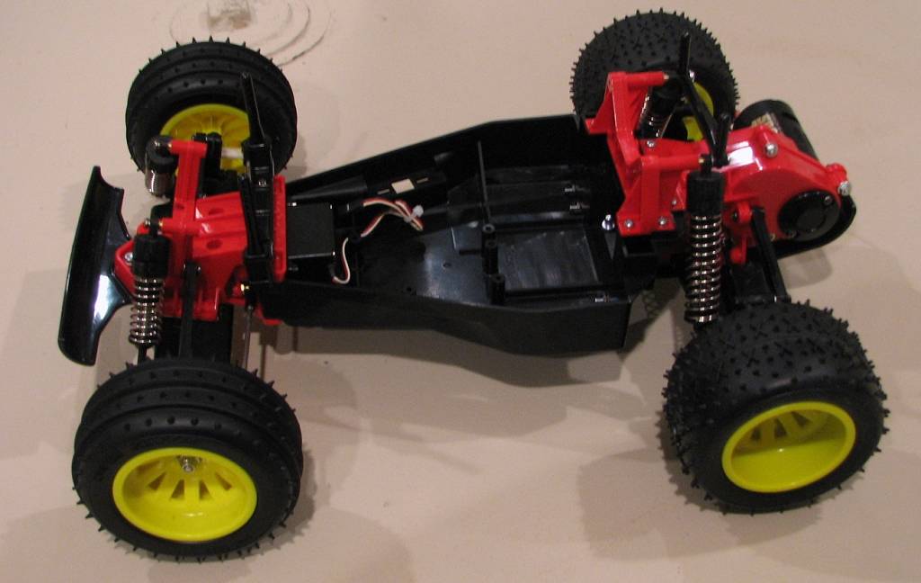

And here's where I'm at thus far. Shiny, isn't it? Tons of room in there for ESC, Rx, and battery, and well protected due to the tub chassis. I will try to use a Novak XRS I have lying around, but last I checked, it was dead, so that might not happen. Will muck with it to see what's up.
I'll have to double-check my steering linkage - looks a bit off in the pic. However, I noticed that as I lift the front suspension up/down by hand, the front turnbuckles toe in/out a LOT. Is this what we call vicious bump-steer?

Man, I don't know what that is about.. ! I might have left mine off.. I don't remember if I put that on mine.. (remember, I did not build mine new from kit..)
Not quite sure what they are for just by looking at it!!

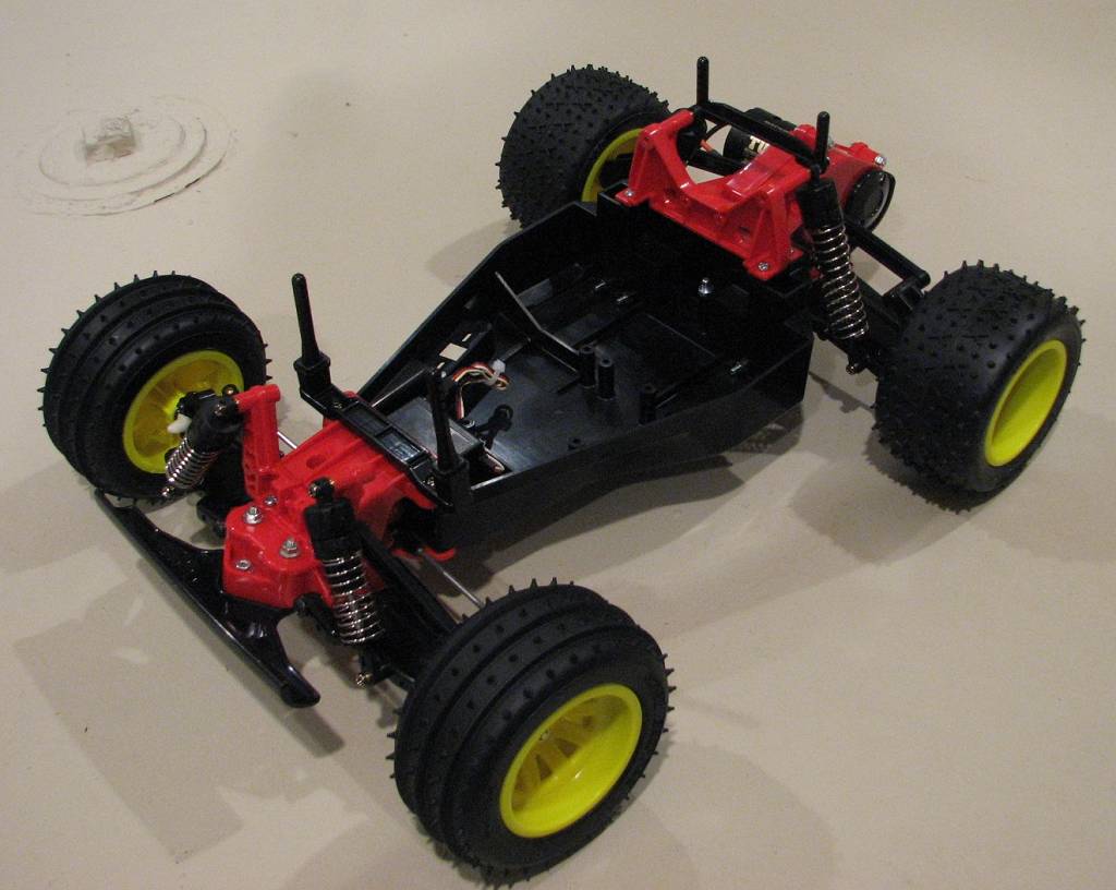

Here's a shot of the front end, with the body posts on. Also, a shot of the rear as I started to put those posts on.
The back seems weird, since you run a screw through the post, then the shock, then into the chassis. So the rear posts are kind of floating out there, and you'd have to remove them to get the rear shocks off. Wacky...

Wheels are on! We got ourselves a roller. I used rubber shielded bearings in the fronts (which the rear carriers also have, along with the tranny). I will glue the tires down later.
Also just ordered a Futaba MC401CR ESC to power it:
http://www3.towerhobbies.com/cgi-bin...6&I=LXTLM6&P=K
Will use a 6 cell NiMh Elite 4000 pack, and the Sport Tuned motor for power...pics to come later.
