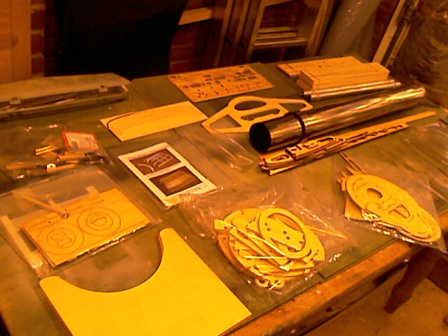

OK, first thing to notice is that for a 68" wingspan model this plane has an impressively large fuz!
(er, not sure this picture has come out?)

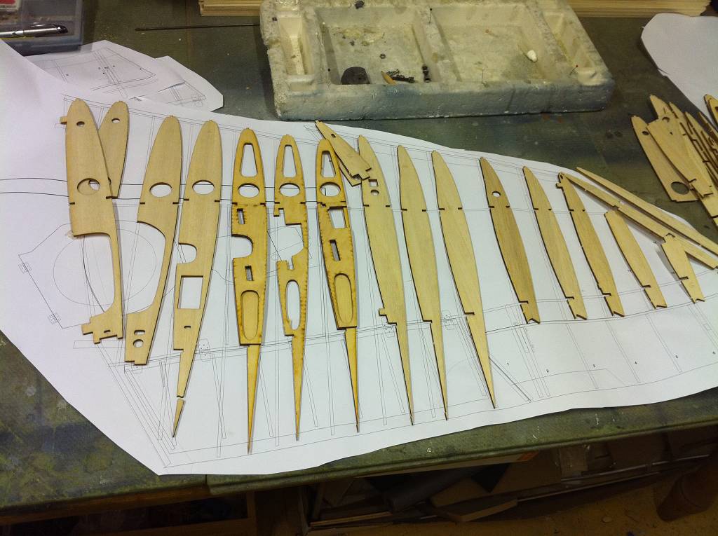

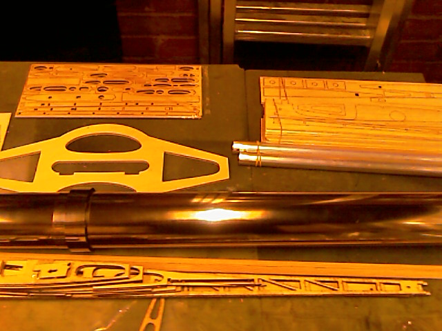

The parts all seem nicely cut and well packed etc, the only gripe on initial inspection would be that the jet pipe supplied is only single walled. I’m new to turbines, but I’ve never seen a single walled pipe and have been advised to buy a double walled one.
The little model is the Corgi Hunter and shows the colour scheme I’ll probably go for.
The retracts are non scale, but the wheels look nice!

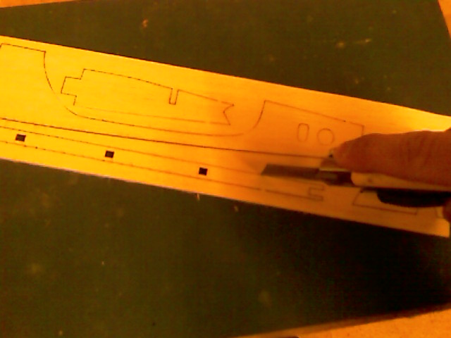

OK, first cut!
And first glue joint! (dated as 10th May 2010)
And very straight forward framing up of the tails.

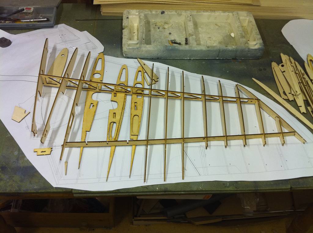

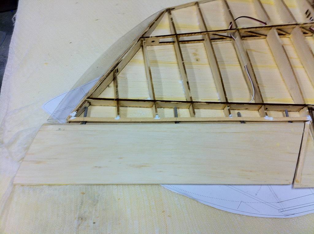

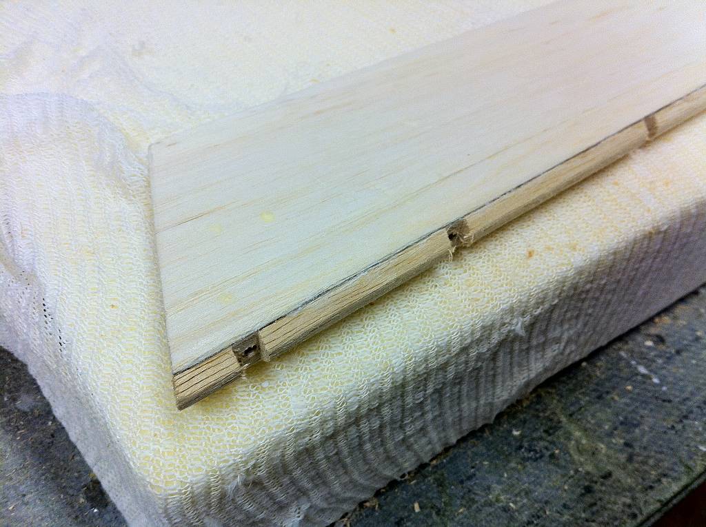

Wing construction is fairly standard, except the spar is a kind of ladder structure. The main advantage of this is that all the ribs can be slotted in dry.
The disadvantage (for a builder like me) is that while a traditional spruce top an bottom spar holds the wind firm in two directions this ladder spar can allow the tip to move backwards and forwards while gluing and I let mine move backwards by ¼” leaving my spar a bit bent. - I spotted this and was able to pin it straight while sheeting the front portion of the wing so no permanent damage done!

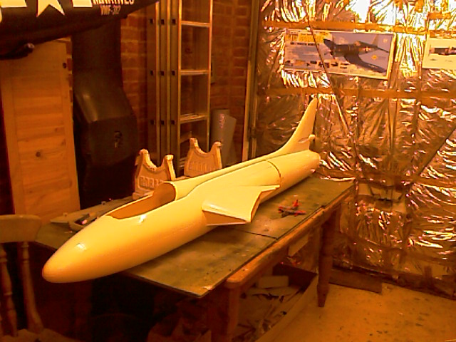

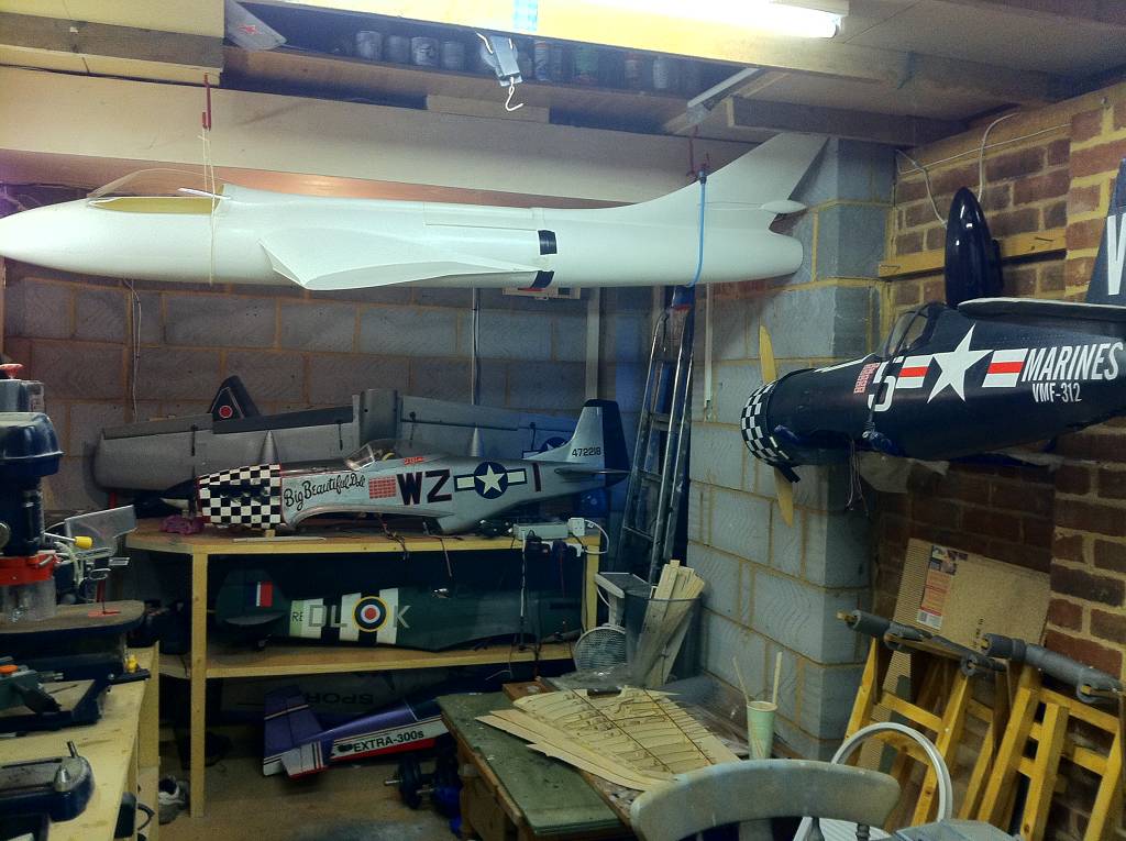

As mentioned before, its quite a big fuz, but I think I’ve found somewhere I can store it! - God knows where I’ll put the next plane!

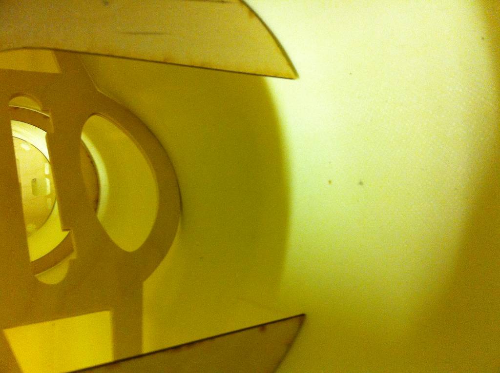

Just playing about dry fitting all the formers in the fuz and the first thing that becomes apparent is that the formers in the nose and tail will have to go in first (as they wont fit through the hole in the middle formers) - Note, this is NOT what is says in the instructions! - But then I always tend to build to the plan rather than follow the instructions!

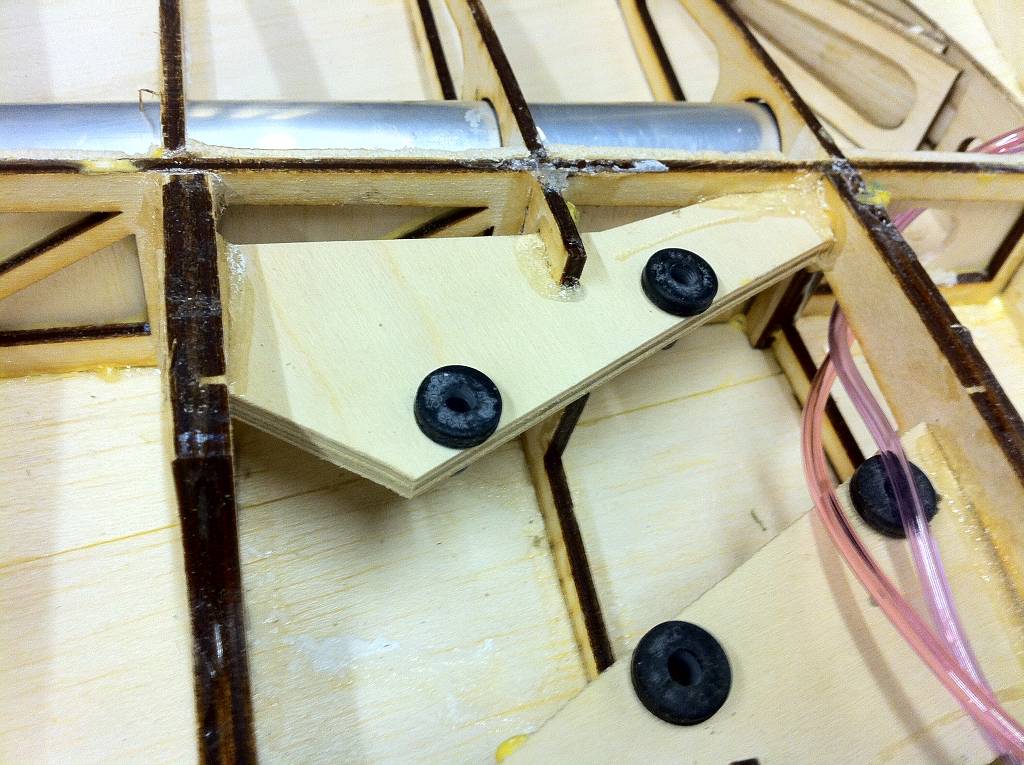

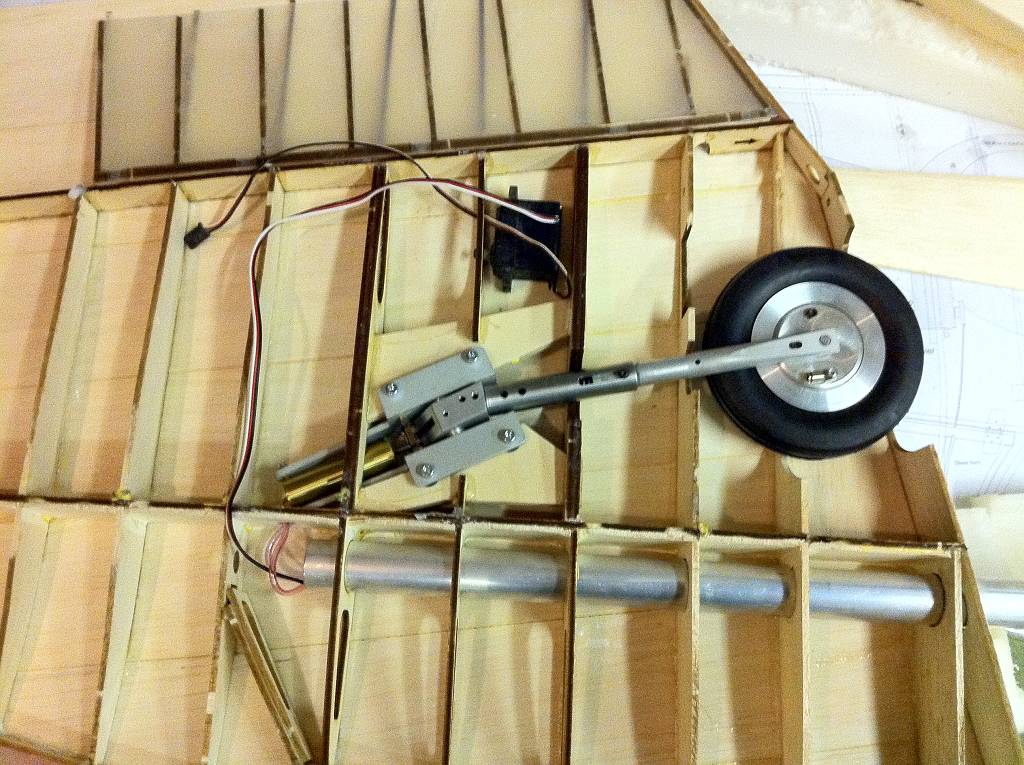

The retracts are mounted on neat little rubber grommets - I’ll remember these for my next build!
Retracts went in ok, but initially I thought that the angles were all wrong since the wheels pointed at a funny angle when gear was down!
…several minutes of head scratching later I remembered that the wings are swept and that the wheels will have to point in a lot just to be going straight!

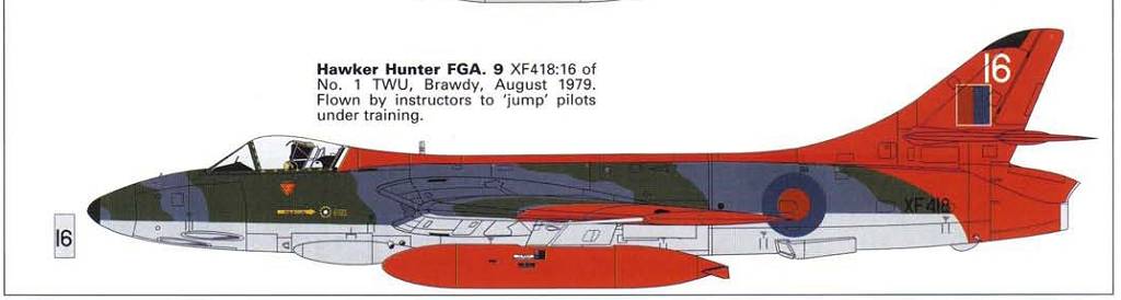

I'll be balsa sheeting the wings and probably doing it in the RAF camo/red tips scheme (I think its a training scheme)

There you are Dave. Here is a side view of the plane. Unfortunately I was not able to find a multi view picture of the plane. This one is taken from the WARPAINT series on the Hunter.
You are tracking along now!

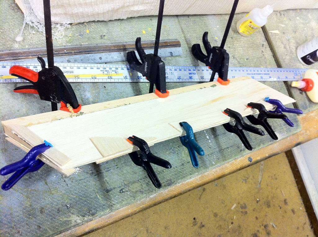

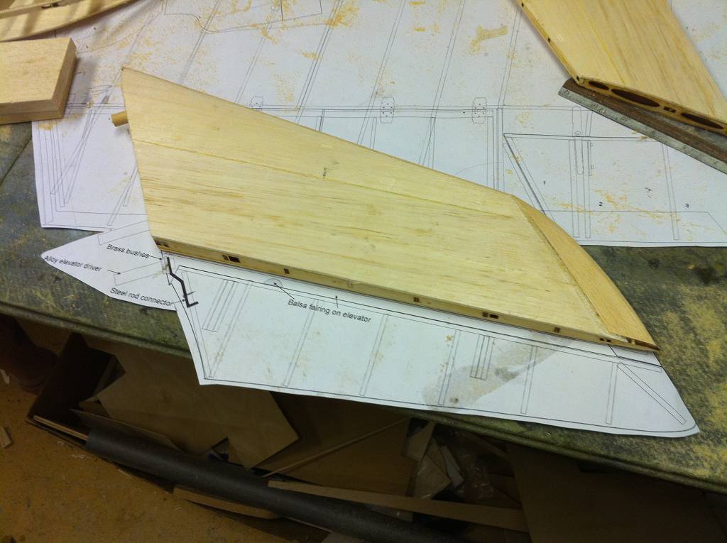

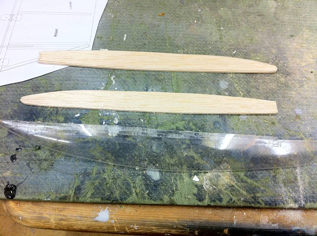

The tail sheeted and with the tips added - Note, the kit provides molded tips for the tails, but they are so small I just shaped them out of balsa (much quicker and easier)
Note, I always cut the plans up into each component - I don’t see the point of trying to build the tail on the very corner of the building table with the rest of the plan hanging over the table just because that’s where it is on the plan. Much easier to just cut the plan up so I’ve got a wing shaped plan, a tail shaped plan and a fuz shaped plan etc then I can build them on any of my benches and orientate them in the most convenient way.

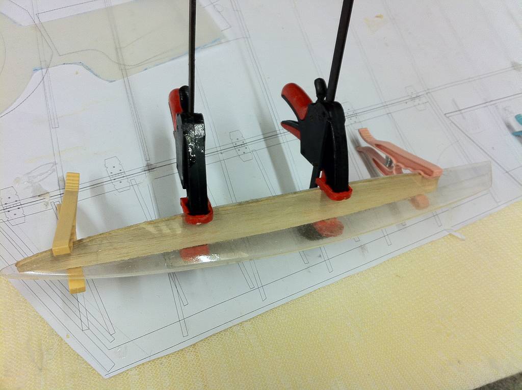

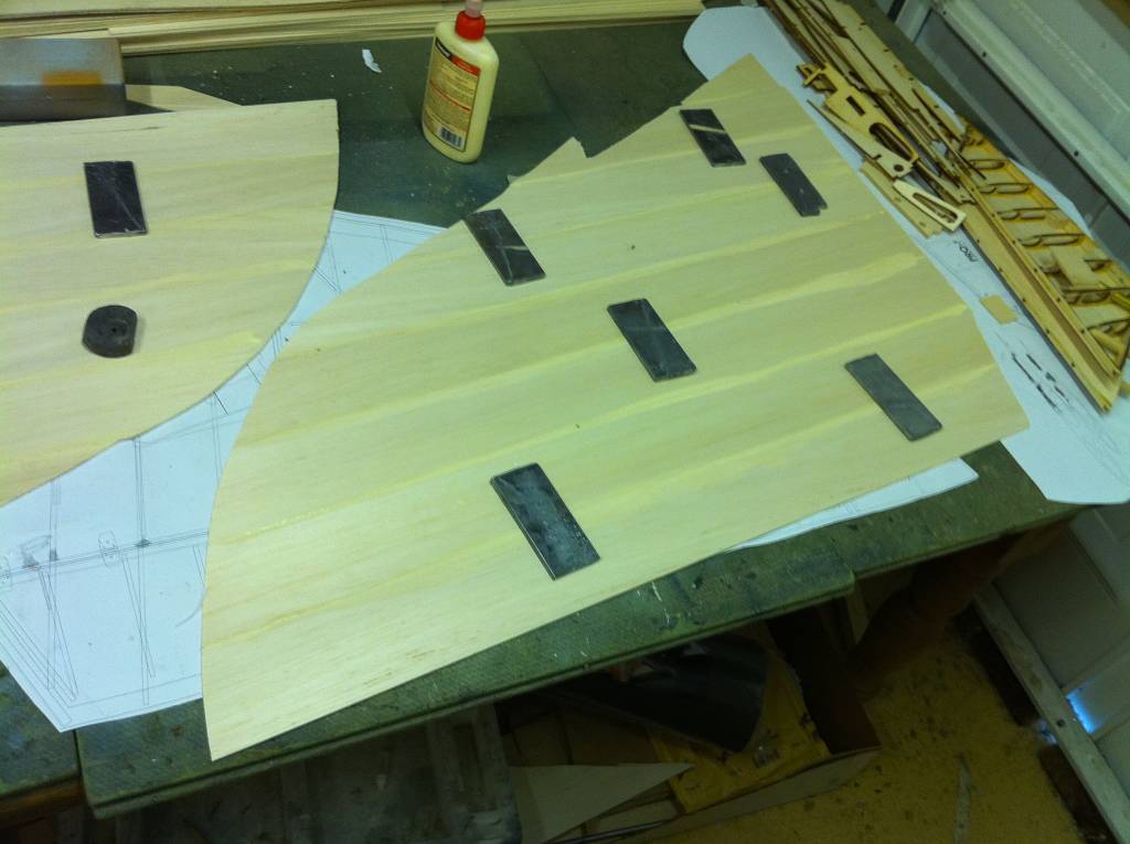

For the wings I used the supplied moulded tips, these are glued to a balsa rib and then glued to the tips - But, my tip is 1/8” thicker than Mick intended (as Ive got 1/16" balsa sheet top and bottom) so I had to make up a pair of thicker ribs to compensate. The plastic tips had enough flex to fit the thicker profile.

The aileron with it’s counter sunk hinge slots.
Next pic is the dry fit, note, it does actually fit better than it looks in this pic as the wing trailing edge hasn’t been cut down to size yet.
One thing it did highlight though is that due to the sweep of the aileron you can't just push the hinges in as the inboard bit of the wing is in the way. I’ll have a read of the instructions to see if Mick suggests how to over come this problem, if not then the preferred option at the moment seems to be to leave 1/8” gap then slot the aileron in at 90 deg (ie full deflection plus some more) and it will just about go. Then fill the 1/8” gap after aileron is is in place.
…I’ll have a think about it, there must be a better way, but I’m open to ideas.
