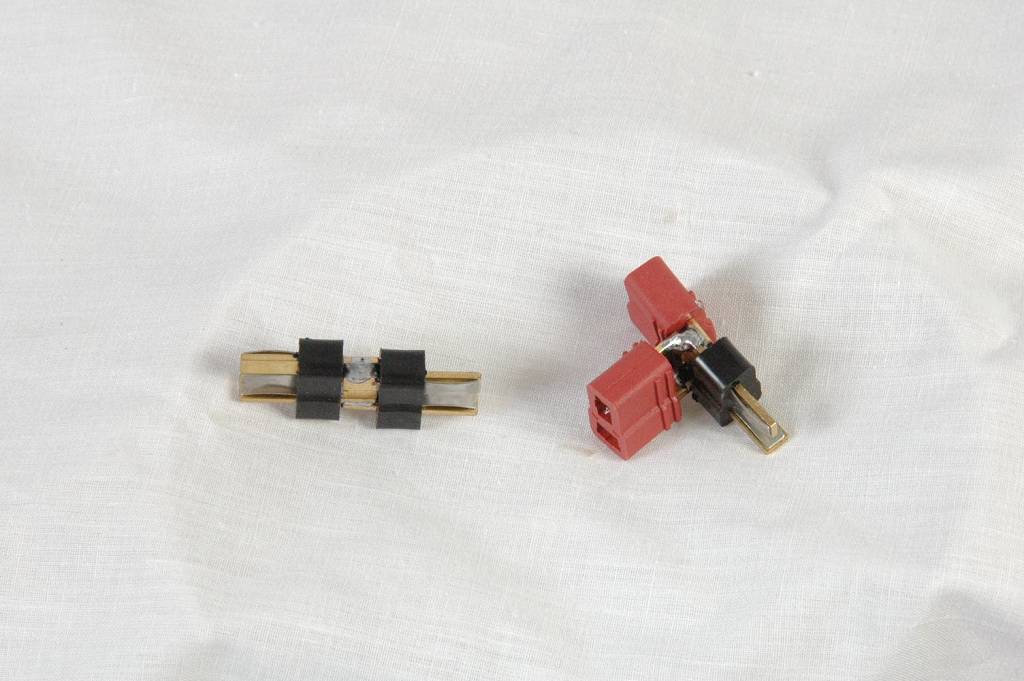

#150
RE: What allows Kingtech to use diesel where others say you can't?
Here's another option for you to still operate the ECU with 2s LiPo but jump start with a higher voltage pack during the start up. This was the config that I did the flights at van nuys the other day, obviously after some liquid tape to insulate.
Barry
