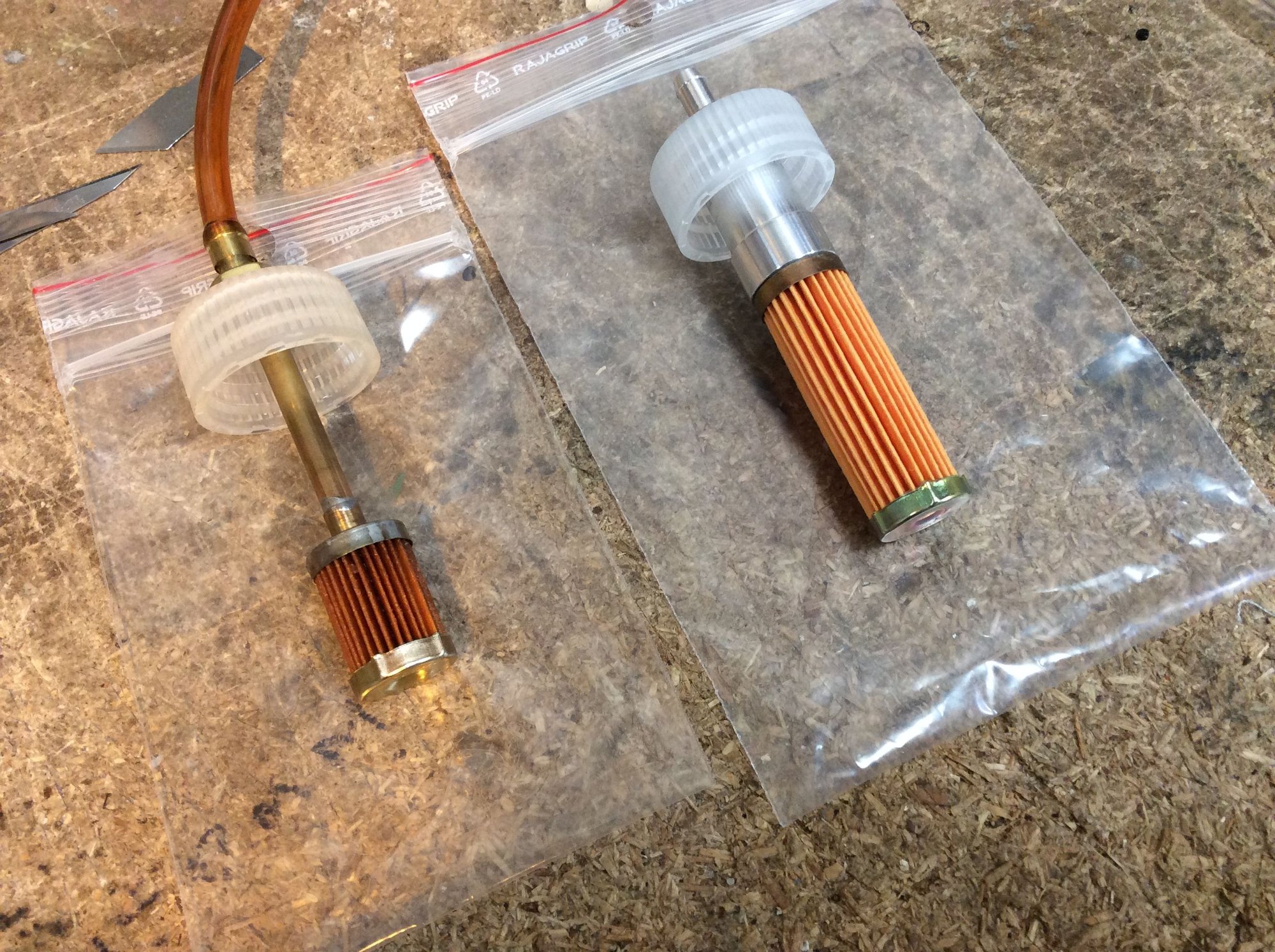

That looks like a MAP and they have a built filter. The filter helps to prevent debris and air from getting in the turbine.

No one really answered the question! Distance to the turbine is not an issue, but proximity to the main tank feed and fuel pump is.
It’s not ideal having a joint in the feed line, or really using Tygon on a suction line where the soft tube will collapse slightly.
Clear SMC tube is best for that job.
lastly why would you replace a better system with a BVM type bag! The MAP traps now have screw on, threaded pleated pickups that take 5secs to change.

suction no problem, temperature no problem. A harder clear 6mm tube would be better and as CARS shows keeping the length of tube as short as possible is best. 6-10” is acceptable
