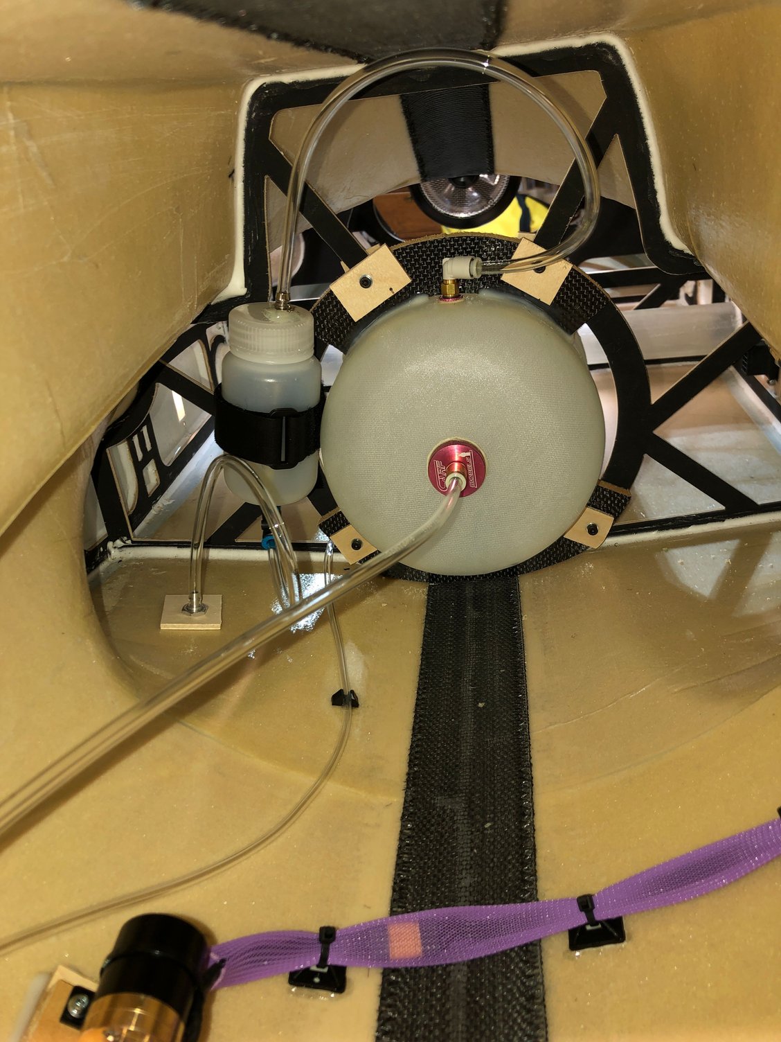

Update on my fuel venting problem.
originally my vent pipe ran from the bung in the DuBro tank to a simple nipple in the fuselage bottom. I used the small Tygon tube. In the photo below the vent tube is behind those wires.
Following your suggestions, I added about 15" of the larger Tygon and looped it up and around, and down to a forward-facing vent.
That seemed to cure the venting. However I cut the extension much shorter, only 5" or 6" extra Tygon, but still looped it up high, and that worked fine too, still no sign of venting.
Then I tried looping the excess down and around, and still it wasn't visibly venting, but looked neater.
So my next step is to replace the tape covering the U/C wire which has been discoloured by the venting fuel and oil and see if I have cured the problem long-term. Thanks for the advice/suggestions.

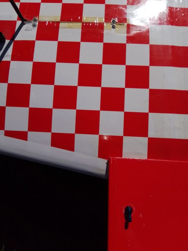

Originally Posted by RCFlyerDan
Having the vent exiting to the rear creates a Venturi affect. This simply isn’t done, even on full scale, due to your results and issues.
Yes, I agree. But this vent of mine is forward facing. See the other photo, of the underside, with the wing leading edge showing

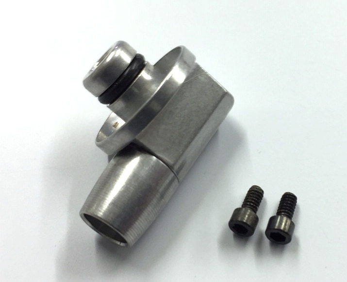

Yes, thank you. I assume you mean the FV-6 @ $28.80
The fitting I used was a cheap thing from Hobby King, and more importantly, already in my stock. I mounted it forward facing in place of the simple up/down double nipple.
I like to use a nipple as, to avoid spillage in the car, after flying I fit a vent blocker (with a 'remove before flight' flag).
