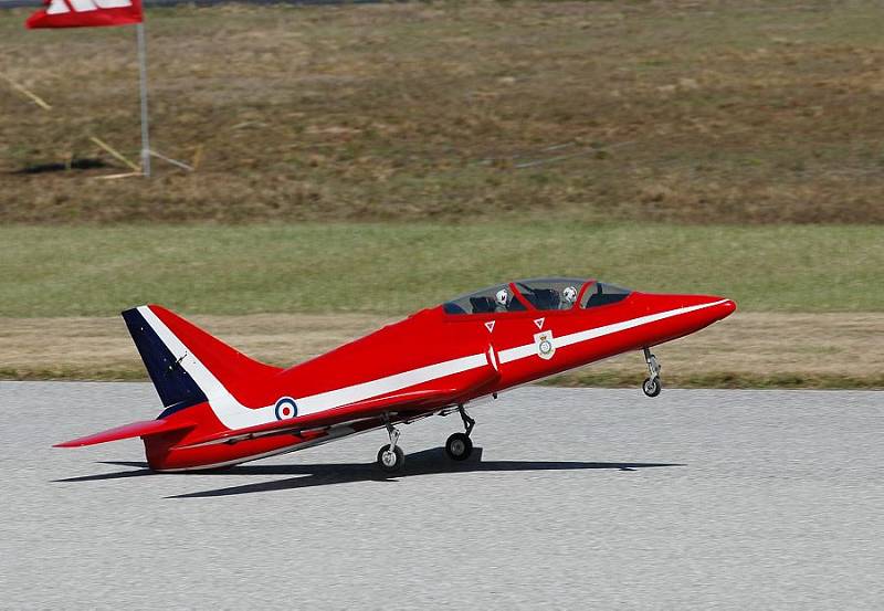

BirdofpraY
My Feedback: (31)
Join Date: Mar 2002
Location: Lady Lake, FL
Posts: 1,004
Default RE: Feibao Bae Hawk
I had a P70 in the first Skymaster Bae Hawk which is the same size as the Feibao and it flew very scale. It had plent of power to get off a paved runnway and would do it in about 450ft. I did not add any of the geardoors so that I could keed it very light. The vertical performance was not that great and would fly around 180MPH, Very clean airframe.

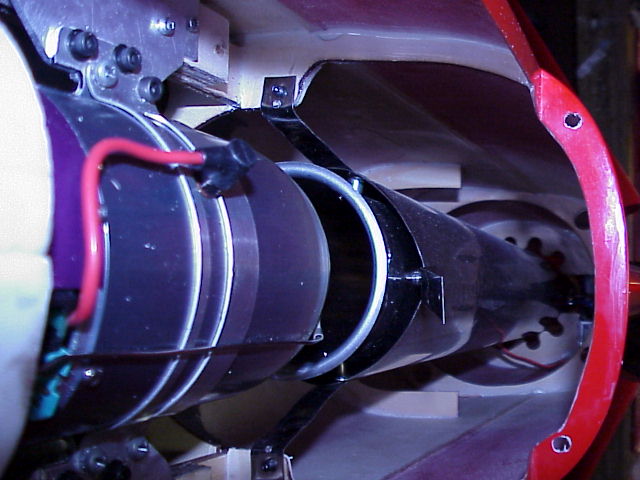

Old 10-01-2007, 03:31 PM
BirdofpraY
My Feedback: (31)
Join Date: Mar 2002
Posts: 1,004
Here are a couple of other pictures of the Hawk as you can see no gear doors in the picture in flight. If you are going to build with a P70 watch the weight. If I were going to use that size of a turbine I would go with a Falcon from Artes it puts out 22lbs of thrust and it is the same size as the P70. Also keep in mind that the FeiBao Hawk is a little heavier than skymaster. My original Skymaster Hawk weighed in around 21lbs.
