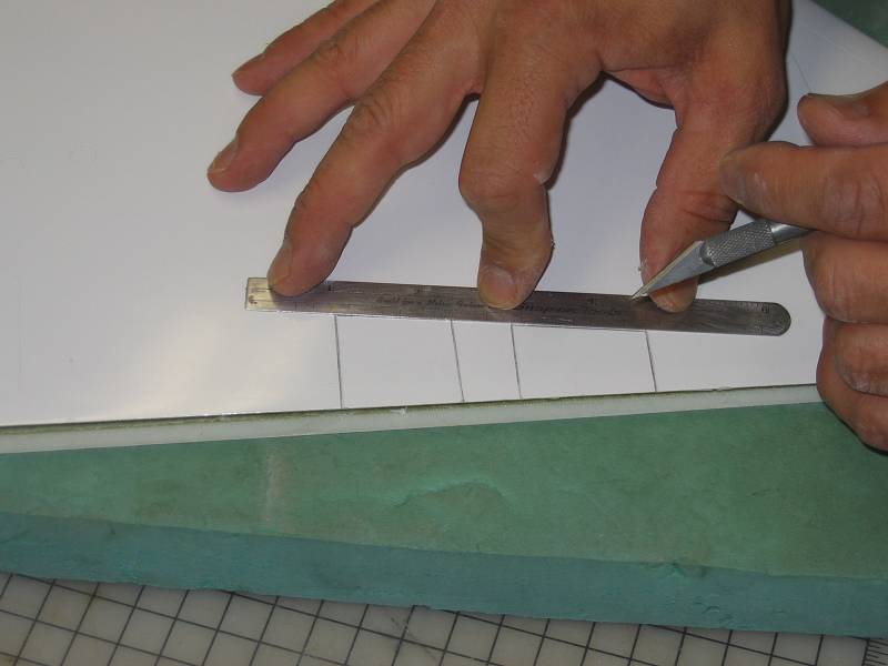

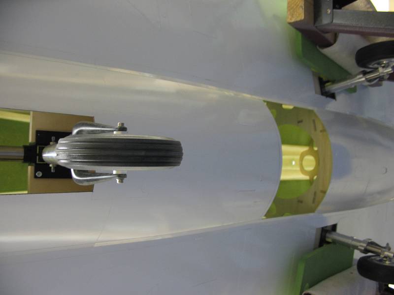

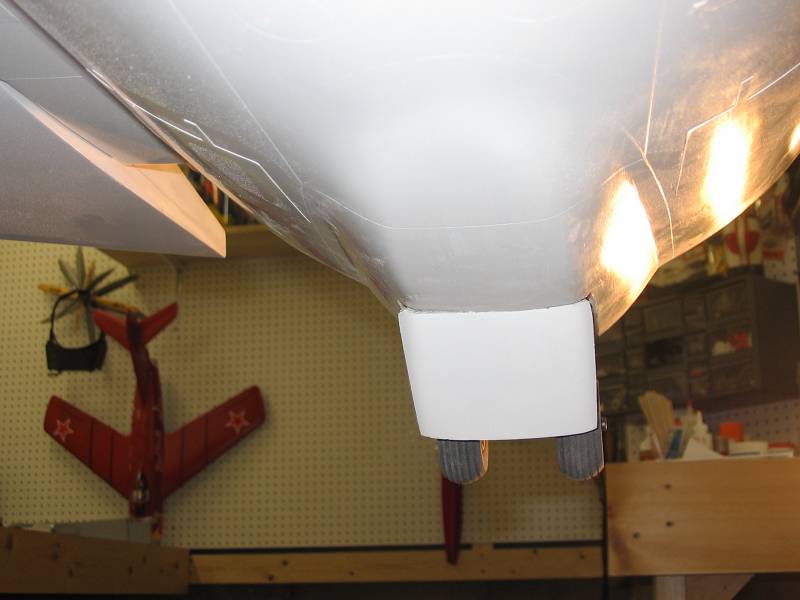

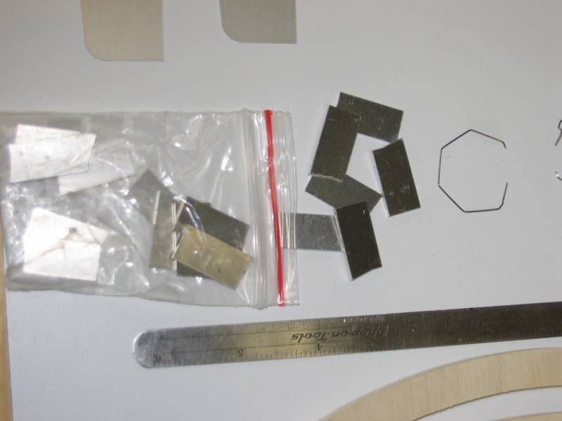

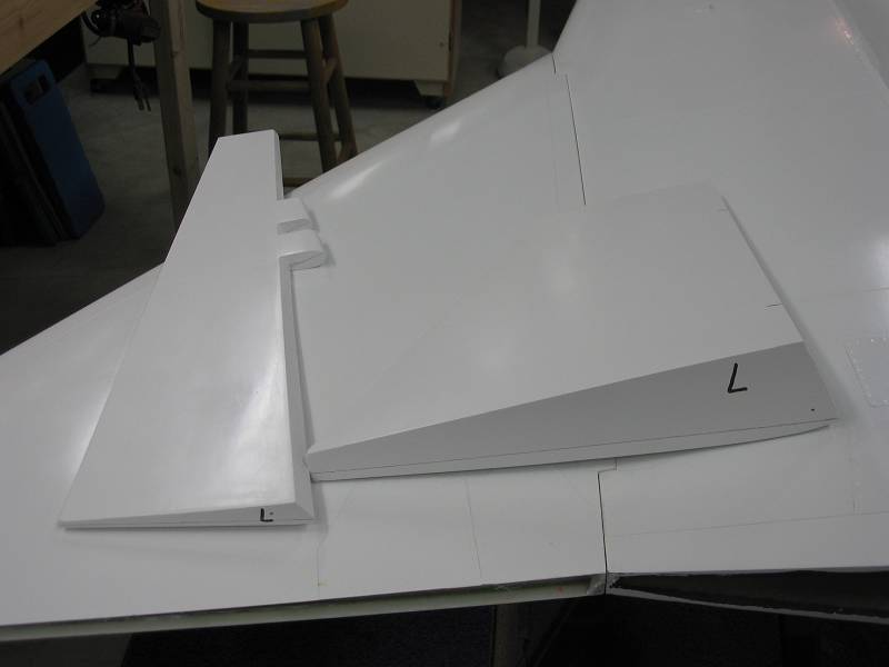

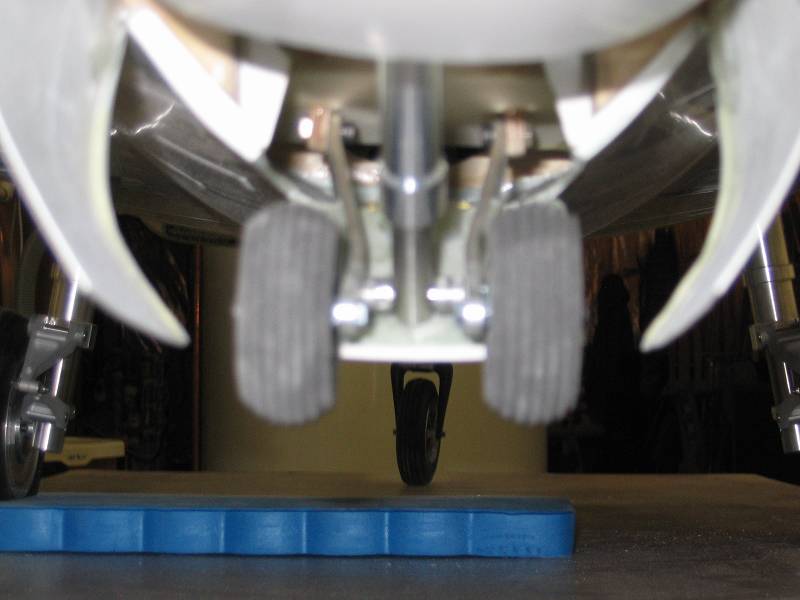

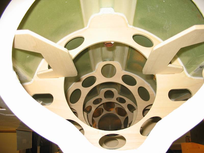

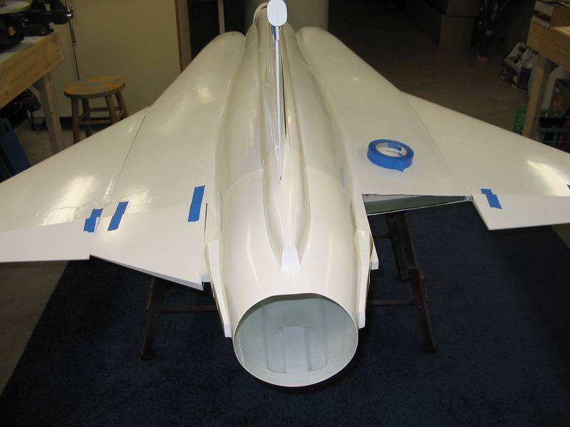

Here are some photo's of todays work;

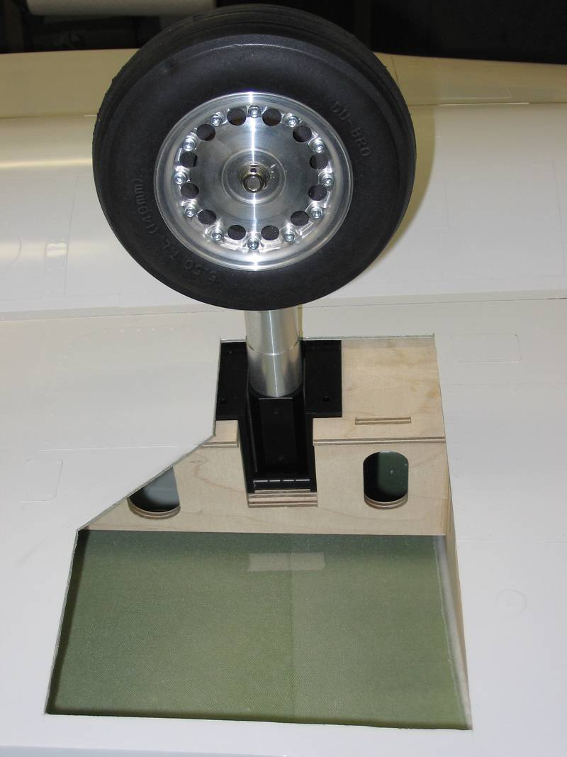

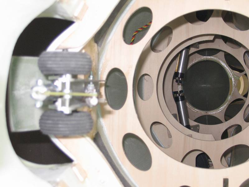

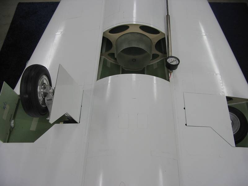

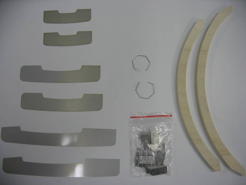

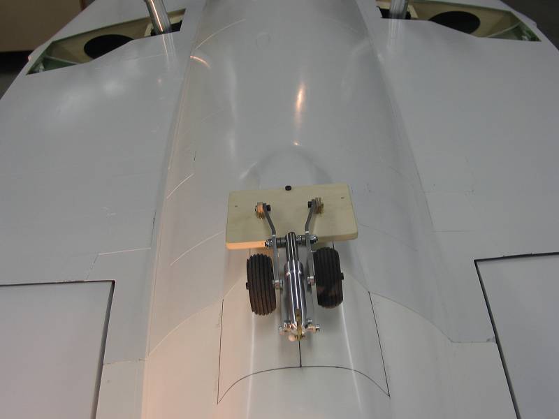

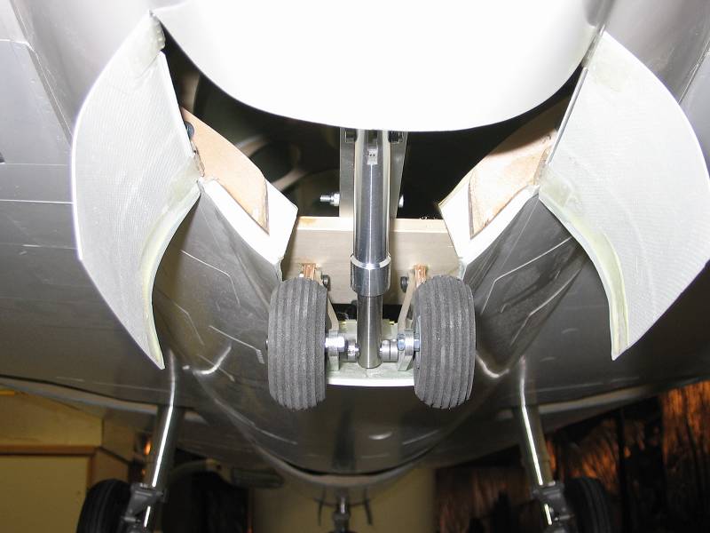

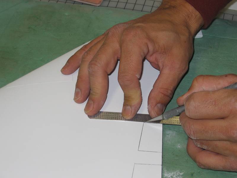

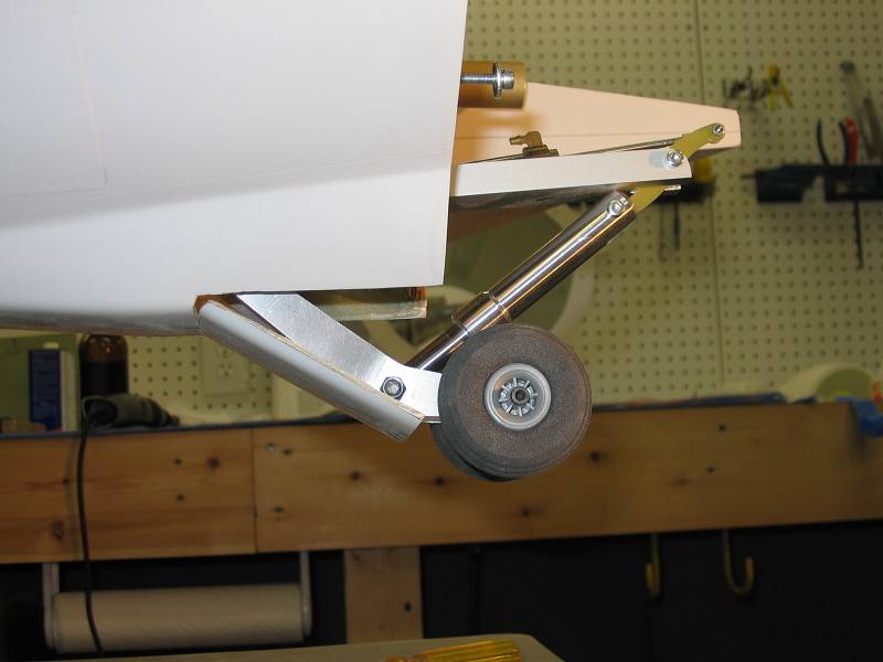

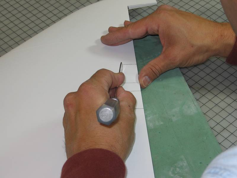

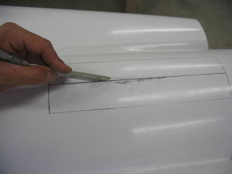

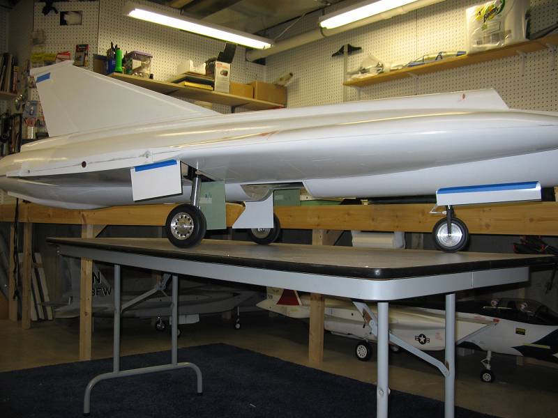

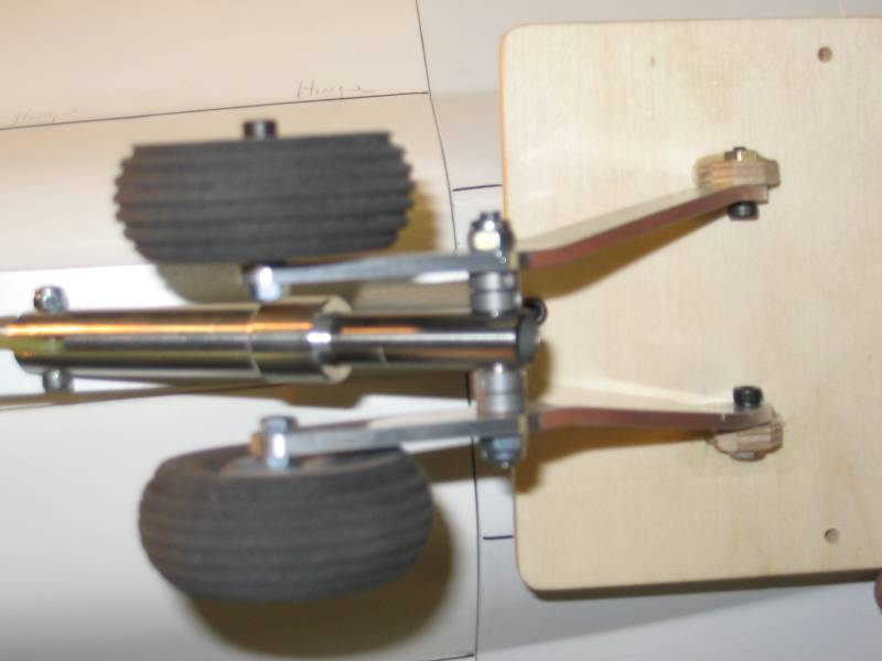

Hey Guys,
Today I was able to cut all the door panels out for the main and the nose gear.
It took some doing with the straight-edge and a few #11 blades, but I was finally able to get a clean enough line to switch to the razor saw to do the final cut-away from the fuselage.
The landing gear was a simple bolt-in affair once I cut the doors out.
In the morning I will begin cleaning out the remaining areas for the flight controls and sorting out the correct hinge clearence for thier movement.
The Draken inner main gear doors are mechanically attached to the struts, the outers will be air-ram operated.
There are also four (4) speed brakes around the aft-fuselage area I hope to duplicate useing clever hinging and air-ram to deploy. I'll have photo's of that as I go thru tomorrow's building session.

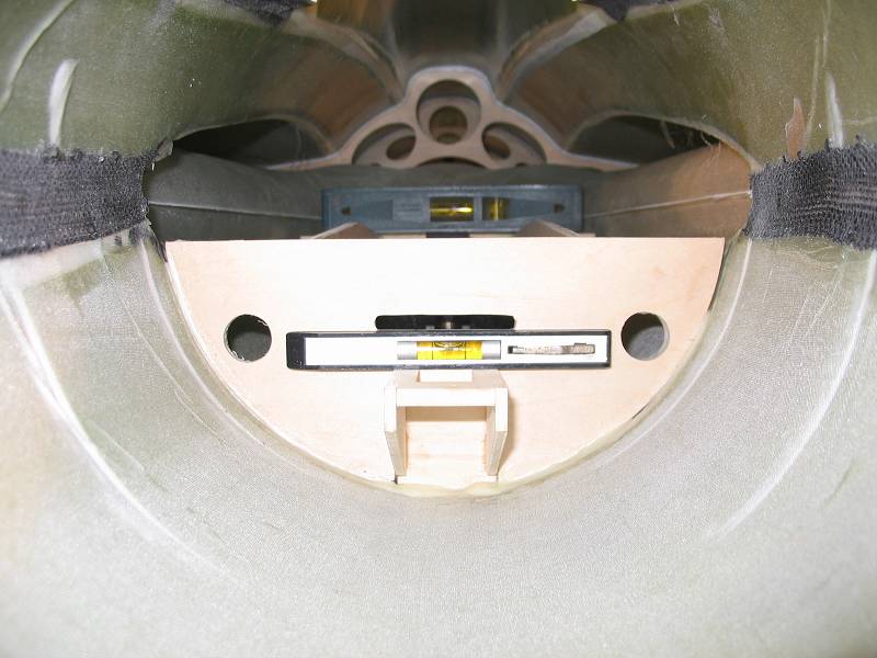

Hello Arizona!
Have been distracted for some time, but I'm back now.
The CG for the Airworld Draken is indicated by Mr. Peter Liebetrau to be at 35mm ahead of the wing/fuselage contact point.
For most delta type platforms, this works out to be just forward of the main gear center mounting point. Thanks for the kind words of encouragement.
Good luck on your build, I will be posting photos of my ongoing build as well.

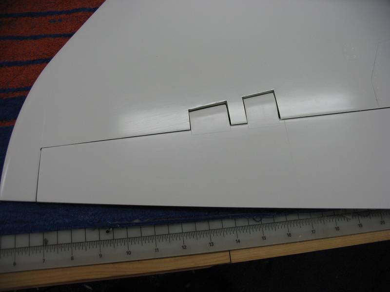

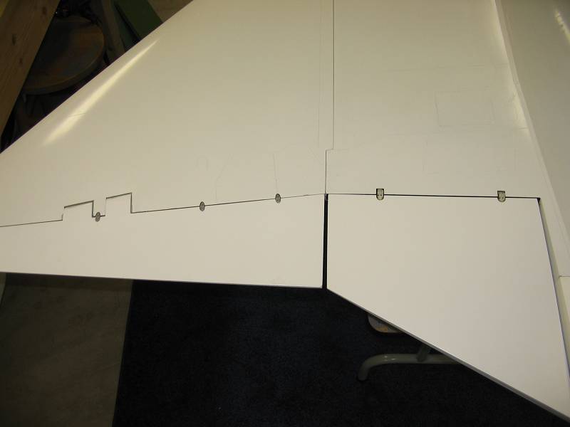

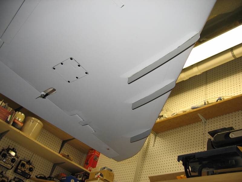

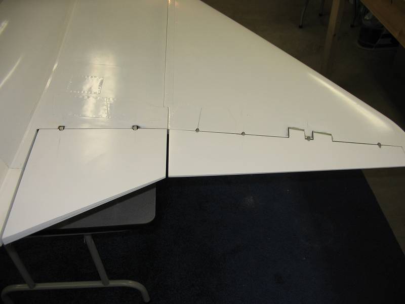

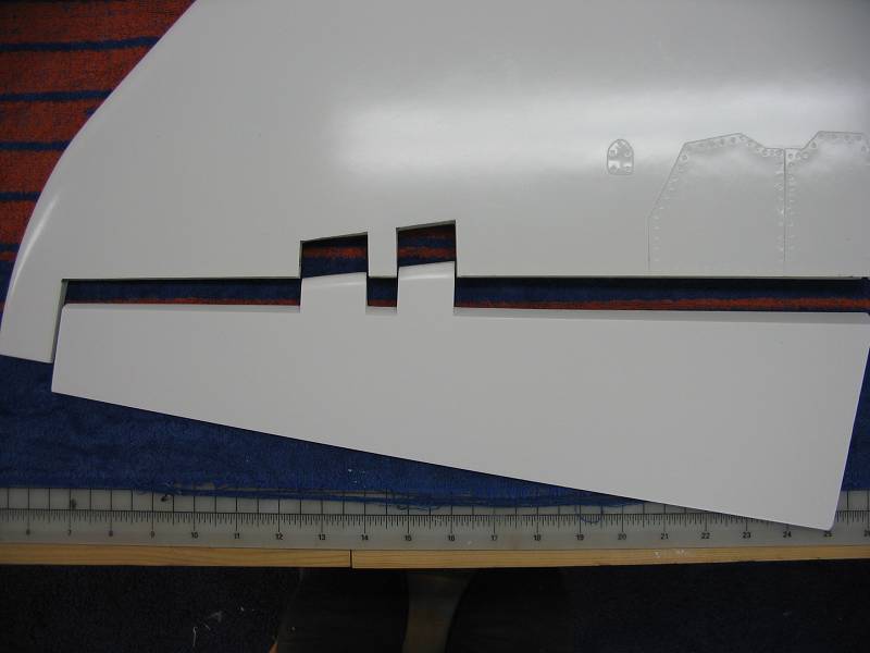

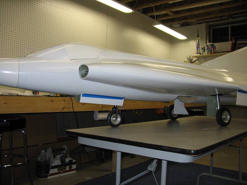

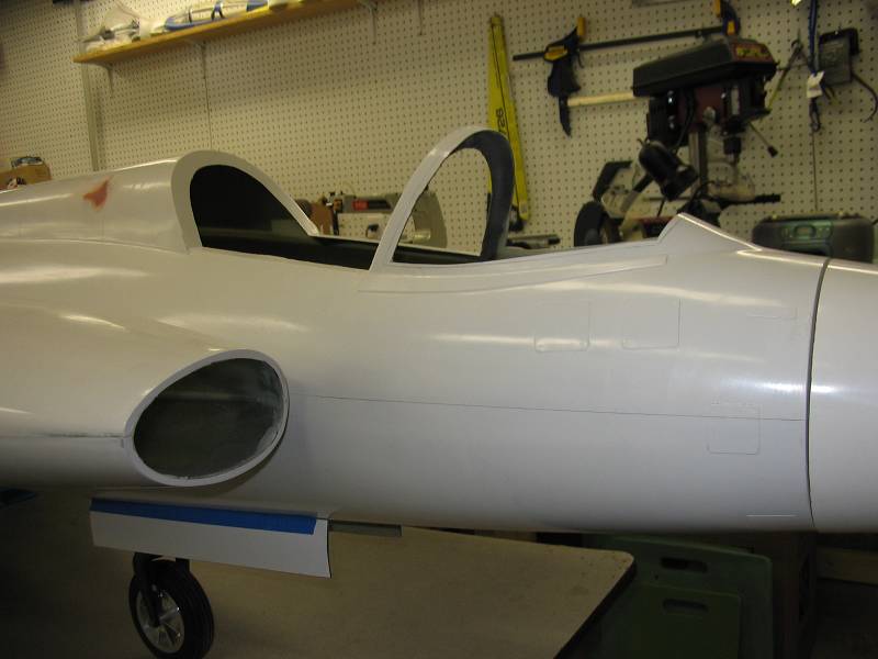

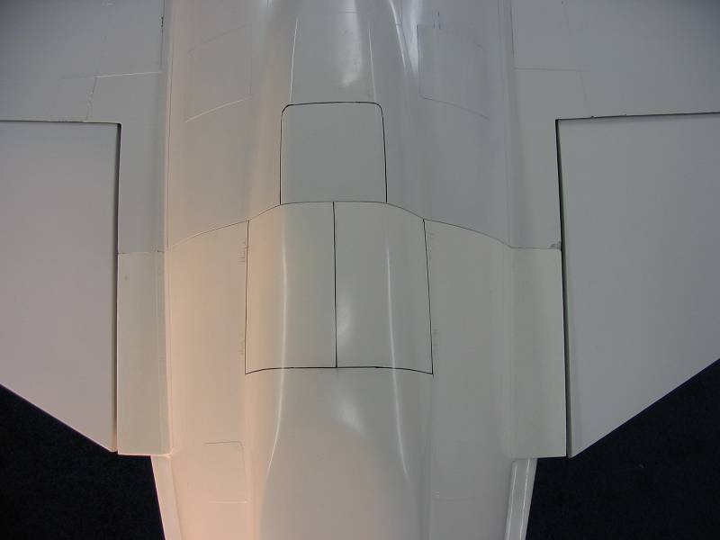

The next few pictures of the aileron horn cut-out and the fitting of the to the wing.
Also, the forward fuselage avionics bay for some of the service units onboard the jet. The rear shot is of the main engine mount, yes, its true, the turbine for the Draken is mounted in the most rearward aft location in the fuselage! In the end I may need a short lenth dual wall exhaust tube for the gases to exit the last 1-1/2 foot of aft fuselage!
Perhaps the most profound moment for me is the fact that the Draken is now sitting quite nicely on her own gear!
I will be installing the nose gear steering servo forward, then the wing aileron flight control systems in the next few days. The elevator/trimmer system will be constucted concurrent to this for proper alignment of the trailing edge of the jet.
Here are the latest shots of the Draken.
Man she is huge!!!!!!!!!!!!

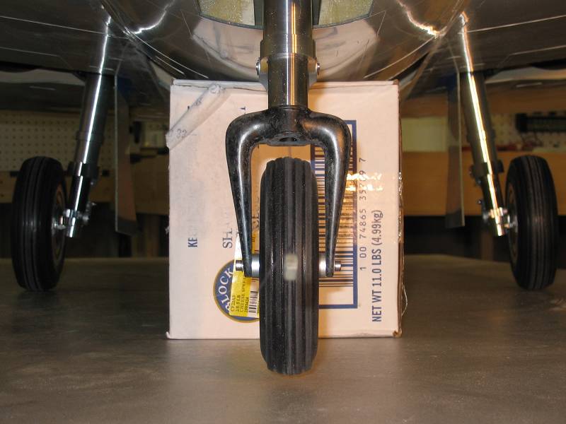

Take a look at all of those gear doors! Not only do I have to get those moving in correct sequence, but to compound the issue, I also must have four (4) aft fuselage speed brakes open durring the landing phase of flight too.
Looking forward to getting the first flights, should be very impressive!

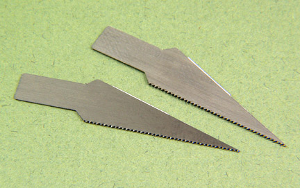

Frank,
These blades work great for cutting all those openings. They are only .010 thick too!
http://www.ares-server.com/Ares/Ares...oduct&ID=14346

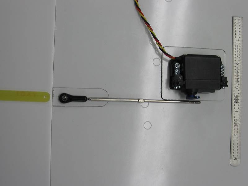

Hello folks,

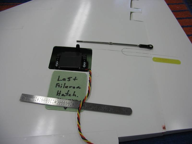

Here are some updates with regard to the Draken progress.....
The first shots of the wing aileron control system and servo hatch install. Following this are photo's of the soon to be finnised cockpit. The wing lower vortelons have been installed to aid in high-alph laminar flow issues durring the take-off and landing phases, or for that matter, any other high AOA attitudes durring flight.
Enjoy...................

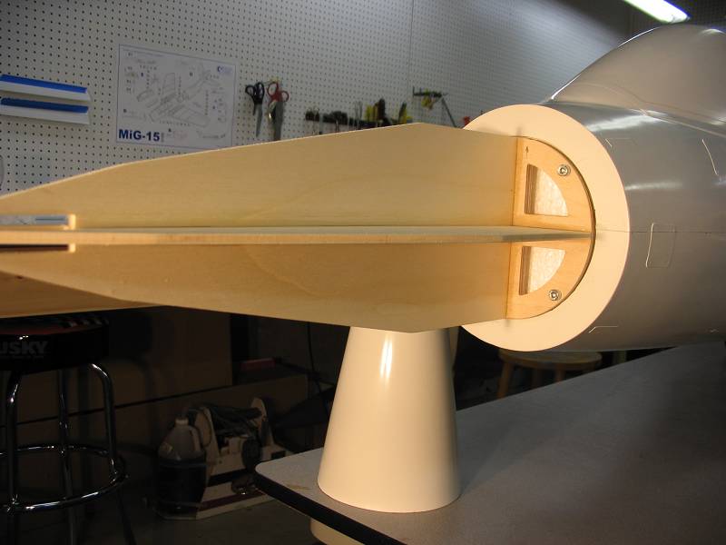

Hello Folks,
Here are some of the latest pictures of the Draken aft fuselage work.
Had to ad an entire rear former to absorb the tail wheel loads that are possible during the landing and take-off phase, I thought that I should add two, forward and aft fuselage were it breaks for transporting. You can see this work, and also the primary panel line outline were the tail wheel will be installed.
After cutting and mounting the tail wheel, it was appearent that I should bolt the aft section on with a spread pattern to keep a tight and strong aft section during flight. The eight bolts also absorb the wieght of the aft mounted thrust tube that remains attached to the removable tail section.
Here are the photo's.....................

Here are more pitures of the Draken build tail section...................

Some more shots aft end of the Draken with the tailwheel in the up and down position.........

Default RE: The new Saab J-35 Draken arrived!!!
Great job Frank !
What hinges are you using for the gear doors ?
Good luck on your project.
jef

Hello Florida!
I am actually useing the Dubro large type for the tailwheel doors. I figured I would use stuff hanging on my shop walls rather than braving the -4 degree temps outside!
This would be the only application for that type hinge as the rest of the jet will require heavy duty metalic/carbon type that are offset to handle the required geometry.
Thank you for the kind words, see you in Florida during the April Top gun program.
Stay warm,
Frank.
