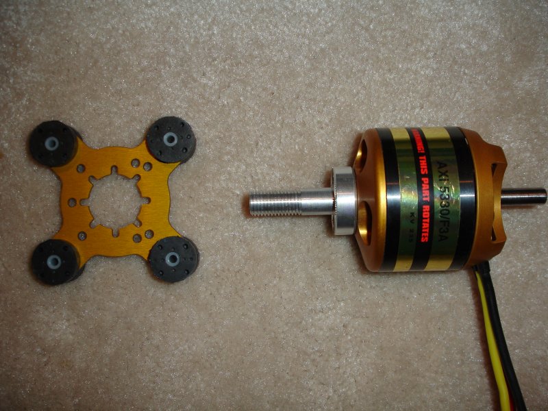

My intent is to make it electric but not using one of the 2 options they show. I am Hackered out to death (they sound like blenders, might as well be glow) and the Plettenberg is one ugly-***** motor. No offense to anyone that has one but I expect form AND function, the form portion of the pletty seems to be missing (are those burn marks I see in the picture?). Again, not to offend, from what I read it is a good motor but I've decided to go with the Axi 5330/F3A, the Jeti Spin 99 and 2 x FlightPower EVO 5000 6S2P (series) for a 12S pack. I know, I know, 12S is a little high but I already own a large amount of TP 8000 4S packs and EVO 5000 6S packs, I can't mix and match and 8S isn't going to cut it so to try and use what I have, 12S is where I plan to start.
I'd like some tips from the guys who have built one of these bad boys already, my experience is limited with large and composite/glass aircraft so if you can help me out and avoid an issue later, I'd be obliged. I read the manual 3 times, I feel I have a grasp over sequence, the areas I'd like advice are stab servos (mount via hatch as they do or in the end with a hole cut into the fuse to accept), rudder assembly (seems to me it would be easier to glue the rudder end piece in before mounting the rudder to ensure proper glue coverage and bond) and finally, motor mounting (I've got a Budd Engineering Electric Soft Motor Mount coming). Oh, I also plan on using a DX7 radio, I have had one for 2 months now, been flying it in my Fliton Inspire 60 and LOVE it, this would be my first composite/glass installation though.

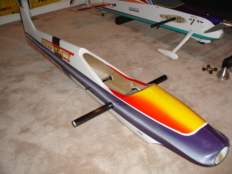

....no it is not difficult, but it is a secret
Motor at -1,5 degree( down pull) , wings at +0,2 degree ( LE is higher than TE ) and tail in 0 degree. You also need at least 2,5 degree right pull on engine max 3. Your Impact flys with the same alignment figures as my Elaine. I made precise measurements and then you do not need adjustments going out on the first flight. Only small clicks on elevator and ailerons. A horizontal laser beam and a piece of paper taped to the fuselage does the trick ....
Mail me if you are still in doubt of how to

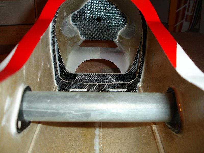

Jack,
I wouldn't be put off the Impact because of the need to set up the incidences etc. Afterall if you were building a model from scratch you would have to do it. Adding wing and tail incidence adjusters certainly gives you some insurance because if you get your measurements wrong you can almost guarantee getting a flyable model by making some adjustments.
Don't take the centre tube markings as gospel. Here is my method: start by opening up both marked centre holes slowly until the wing tube (not the socket) is a tight fit in the holes. Assuming you have the gear formers in and the gear bolted on set the model on a level surface and use a laser level to get the fin vertical by shimming under one gear leg end. Now fit the wing tube and use he laser level to check if it is truly horizontal and perpendicular to the fin. If it isn't, keep your best fitting hole as it is and gently open out the other hole at the top or bottom as required until the tube is level. To take up the gap, remove the tube and run some medium cyano onto the edge of the hole and hit it with kicker. Repeat this until the gap is taken up and the tube is a snug fit and perfectly perpendicular to the fin. It might take a few goes cyanoing and removing material to get this right but it is important.
Now slide on the wing panels and begin adjusting the roots for a snug fit against the fuz sides as per the kit instructions. You need to keep the wing pretty much at the correct incidence by reference to the incidence marks while doing this. Once you have the panels snugged against the fuz sides you can now check for correct fore and aft wing tube alignment by measuring from the wing tips to the top front edge of the fin using a length of non stretching material such as kevlar kite string or even thin wire. If the tube has to be adjusted use the sand and cyano method this time on the front or rear of one hole. I must emphasise that the amounts of material that have to be removed are very small to make a significant change out at the wing tip. Once you are happy bond in the tube sleeve and reinforcing rings as per the kit instructions. I fit two Gator wing adjusters on liteply plates in the fuz on the rear incidence pin positions. I then fit the matching sleeves in the wings using small pieces of carbon tube to fatten up the Gator sockets to fit in the premade holes in the root ribs. If you do this it is essential to install the original incidence tube and load spreading rings inside the fuz just forward of the adjusters to brace the fuz at this point.
Fitting the tail tube is as per the above but use the wing tube as your datum. I made my own incidence adjust setup using old type Gator wing adjusters. The pics show my first model which used two adjusters but the second model used one spaced out on a balsa block. It works just as well.
Malcolm

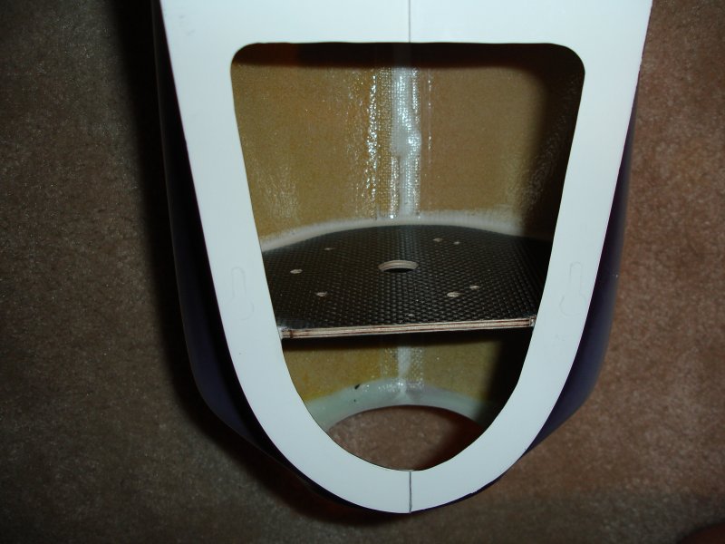

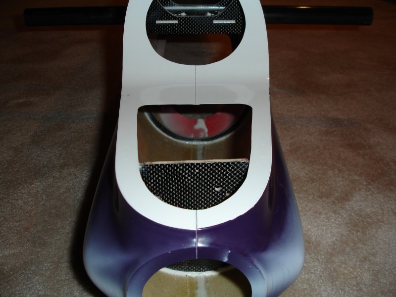

Malcolm,
Thanks for the tips regarding wing/stab incidence, I have made some build progress (if I could only quit my job, get a full-time nanny for the 5-year-old and hire some help around the house for my "honey-do" list) and have gotten the bulk of the cutting, sanding, aligning and gluing out of the way. I am working slow simply because I have limited time and I am still absorbing the manual, some other builds I have viewed online and the info I am getting here. I went with a solid, non-adjustable wing mount (glued main and pivot tubes) and am considering adjustable incidence for the tail as you have done.
I have a few questions if you don't mind me taking advantage of your Impact experience?
1.) Do you think I need reinforcing around the firewall? I used AeroPoxy and used the included firewall from the e-mounting kit, I know this is strong but I am considering gluing in the second firewall (it's the one used when mounting a hacker, to hold the rear of the motor) and some spacers between the two to really "lock" in that area. Waste of time or worth considering for the extra 4 ounces?

Here are some pics, nothing too far along yet, just the basics and core parts...
Jack
2.) My kit didn't come with a stab outer tube, not the tube that inserts into both stabs but the one they show in the fuse between the 2 reinforcing rings. Now it appears that they simply intend that I glue the reinforcing rings in the fuse and slide the tube through to mount the stabs (the holes are fit right for this 10mm tube), it just seems to me something needs to hold the fuse apart back here (without the outer tube in the fuse you can push the sides in a bit) and I would lke to know if you went with the outer tube as show in the manual or have the one I describe?

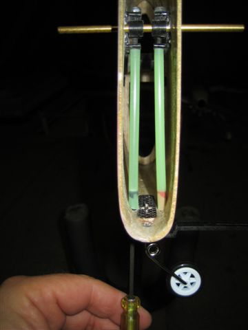

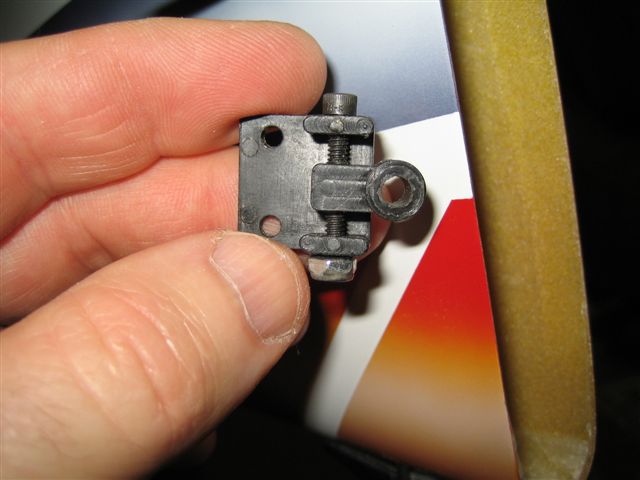

3.) The pull-pull setups I have seen (only 2) show a slot cut for the wire to exit the fuse, I don't want a slot and would rather use a sleeve where the wire exits the fuse (aligned as best I can so there isn't much side-to-side pressure on the wire), is this acceptable? Any concerns?
4.) Do you recommend gluing the tail wood in before gluing the hinges (after a perfect dry fit)? Seems to me gluing in the entire thing in one-shot will be harder to get good glue coverage. Any tips?
Jack

Jack, I would be concerned about adding an extra 4oz. The Aeropoxy will hold that firewall just fine. In fact, the soft mount is not going to do much for you except add some weight. It is a good product but I don't think you have the weight to spare. I know a friend flying the Impact with the Axi F3A and it was flying at 11 1/2lbs so it is tough to make weight with this combo. Although even at 11 1/2lbs it flies fantastic.

1) I agree with ual767 you don't need to reinforce the stock bulkhead, I used it for my Plett outrunner installation and it is fine. I also don't think the softmount will do anything but add weight but assuming you positioned the bulkhead with it in place you are going to have problems removing it now. I am also a little concerned that you haven't any air outlet holes through the bulkhead. These are needed for proper cooling.
2) You absolutely must have an outer tube to hold the sides apart as you describe. This being missing or damaged seems to be a feature of many Impact kits. Its easy to make one as the finish on the outside is unimportant. Wax your tail tube and wind a thin strip of glass cloth round it for several layers impregnating with 30 min epoxy as you go. When cured slip off and trim the ends.
3) Like you I didn't want slots and installed a small piece of plastic tube through the fuz sides where the cable exits. This has been fine on both my models.
