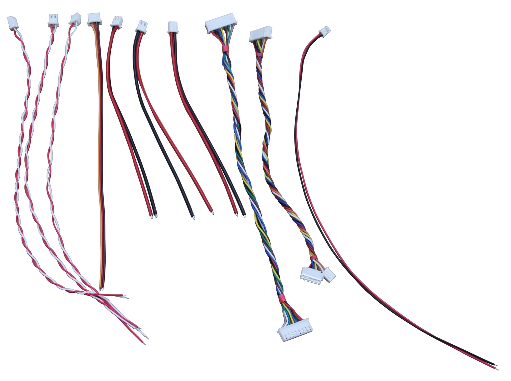

The wiring is the same as for the RX 18 so you will just need a wiring set for that. Ali express and ebay sell these sets for about $10. They come with the power connector wires, two motor connectors, the turret connector wire, and the receiver board wire (three wired conectors on both ends)(and maybe your smoke/sound wire can't remember). Assuming you have the old solder TK01 board, you have to cut your old wires and splice them to these new wires to plug into the receiver (either RX18 or 2.4 receiver). if you go with the RX18 you will need to buy the seperate receiver board, that the antenna wire comes out of.

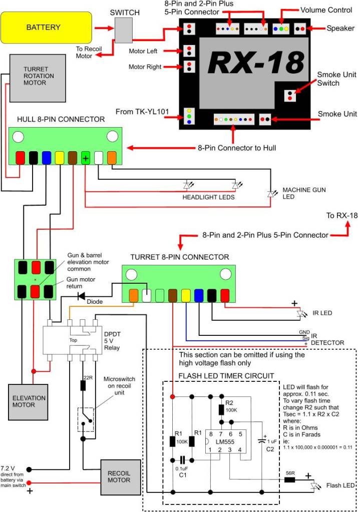

Thank you for the responses but I'm hoping to find someone who has done this conversion with the matorro king tiger. The wires on this model all have plugs and I'm wondering if they will plug right in?
Thank you Dan, I'm going to order parts I need and take a shot at it. The only thing I did notice is that the 8-pin plug going into the upper hull is soldered on the board so I will have to order a wire with an 8-pin connection on both ends.
I know for sure Artistic Hobbies has some wiring kits, and Immortal Hobbies should have some too. If not they can both get them if you need it. The part number is TAG120611 and includes most of the wires you need.
Generally if I need to do an electronics upgrade, i upgrade them not swap them out for something only marginally better. there are options for the RX 18 but their 2.4 version isn't it. look at some of the other options out there since you will be replacing the main system. Dan has a really nice RX 18 system with excellent sound . Don't just settle for a linear swap, Upgrade it.
I should have been a little more clear in my description. The tank is not working. The headlight blinks but the tank will not start. I tried changing the crystals and the transmitter and batteries nothing worked. I am just looking for a backyard runner on a budget. I ordered the rx-18 non 2.4,receiver board and a set of wires for $50.00. Hopefully I will get it up and running soon.
Alright I received the Rx-18 today and installed it. The functions in the lower hull are all working properly but unfortunately nothing is working in the upper hull. The machine gun and headlight only come on when I push the joystick to the right. Looks like matorro wired the upper hull completely different then heng long did. I will have to rewire it and connect the wires directly to each other. My question is what gauge wire does the heng long rx-18 use? I'm a little new at this so sorry for all the questions. Thank you John

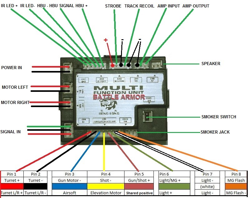

So, finally got the Heng Long V5.3 board and Matorro top / bottom hull working with connectors and everything going well, then after two minutes magic smoke from board. Really? Seems like upgrading this tank is more of pain and cost then its worth. Guess it will be static model. Only thing I can think of is the slow turret motor and barrel. Those functioned fine and really saw smoke after doing the barrel up and down. Perhaps too much of a load on board. I guess I can try swapping out both the turret and barrel from original to Heng long ones and see, but now were talking about another $70, not worth it.
Join Date: Jun 2009
Location: Greece, NY 14612
Posts: 17
After some time later, further discovery is when the BB unit was actuated, that is when the smoke started. Got it on video hearing a slight pop noise not related to BB unit followed by white smoke coming out of the hull. I had the recoil pins set with a jumper as well. Thinking the Matorro BB unit was to much juice/power for v5.3 and caused a part to pop on the board. BB unit no longer fires or recoils. Can physically see the scorch mark. Just a theory. All other part function still, just not BB. Maybe, get a new board and not use BB and convert to flash or drive it and forgot about the barrel firing.
