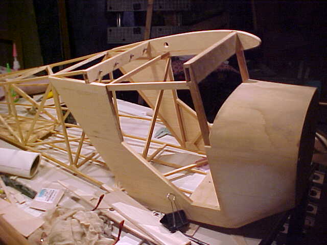

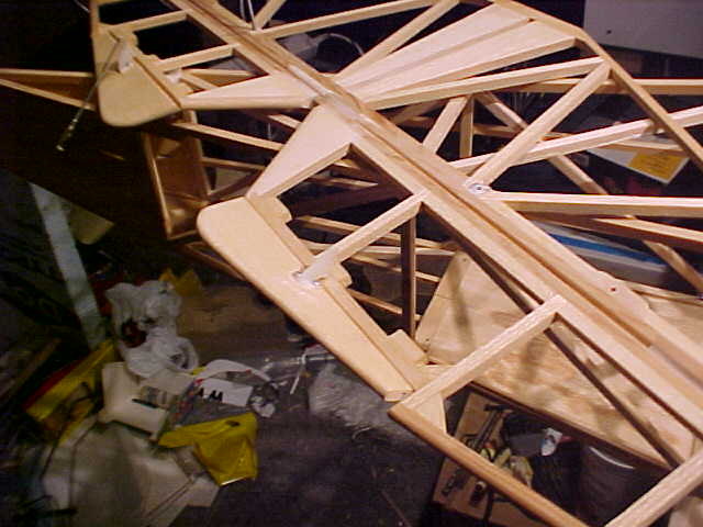

Ok That was supposed to work .The first picture is an incomplete fuse, which may seem easy but I have always found it easier to cut pieces together when there are more than one the same. As you can see where wing fastens isn't there on the one side and you can see the new wing .
Maybe its a location thing ,you being on the prairies lol ,but I think this is quite a large plane As you can see with the wing on it spans nearly 8' the fuse is over 14" wide. I will definitely be using a 148 engine or bigger on this plane

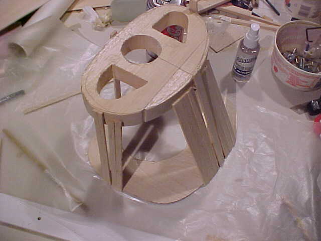

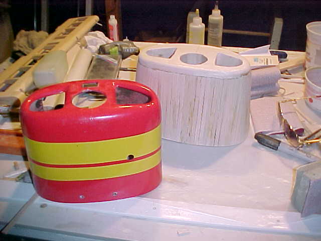

Hey where'd that Gee Bee come from ( thought I'd add a pic of it sure as shooting someone would ask what it was in another pic) As you can see this plane comes with Booster tabs . Can be built with or without them adds a nice finish for that real scale look. Not sure I would have put them on if I had built this from the beginning but they are there now so will have to do it on the wing I built.This is not a plane you would want to tackle as your first scratch build but it is quite straight forward. Once I get the wings and fuse completed will start on the cowl and It shouldn;t be that difficult no more than the rest of the build at least

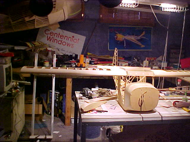

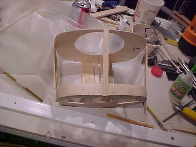

Well I got most of the wing and fuse finished off Landing gear looks like it could be a problem to fasten will take some pictures maybe someone has a good idea Now on to the cowl ,this will take some time and a whole lot of sanding maybee even more than one try at it.The original plans show it being built on the fuse with longerons(lack of better word)built in to the fuse as an aligning point. as you can see from my pictures only one is on the plane the other has been broken off. So I decided to build it on the table using some cross lines a little eye alignment and a whole lot of good luck I hope. The picture shows the plywood cowl plate and the balsa face plate with 4 balsa sticks glued to hold it in the place I felt was the right spot. I then started adding thin strips (planking)to fill in the space. Removing the sticks that were used for alignment as I went along

Funny, I was just doing a websearch for some good Swick photos for paint scheme ideas when I came upon this thread.

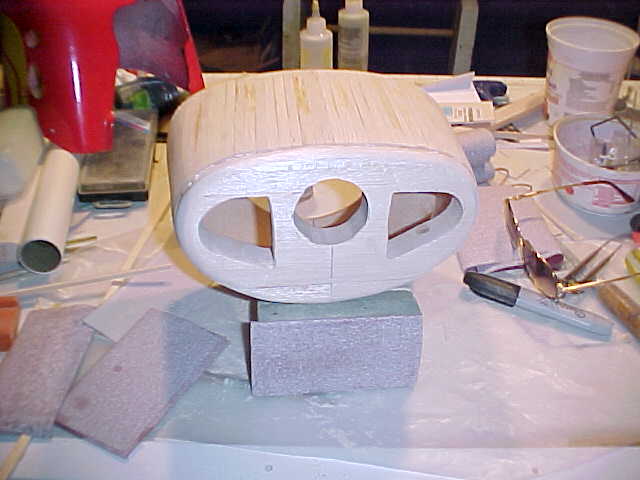

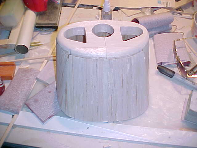

I have had a set of Jim Simpson Swick plans that have been hanging in my rafters for a few years now. I blew them off and unrolled them the other night. It's been hang'in in my 'craw' for awhyle now so I made up a materials list and hit the Lone Star site. Hey, They take PayPal now! Spend'in $ online keeps gettin easier and easier...
I plan to attempt the built up cowl. If I go Gas it'll be my first

Hey way to go I think its a great plane , would Highly recommend a wing jig if ya have one .Do you have the build instructions with the plans even though they are quite vague. Yeah wooden cowl the only way for a scratch build mine looks a little crude but as I went it looked a little bit better . I will epoxy the inside along with some Glass cloth but that won't be until engine is fitted to the cowl. Here are some more pics of the cowl. Yup that is a glass cowl right beside last photo Its about 1/4" to narrow on each side at the firewall and not quite round enough . So I made a wooden one what do you think

That cowl looks fine. Exactly what I have in mind...

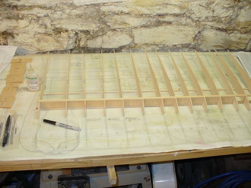

OK, my box of wood arrived and I promptly wiped off a bunch of balsa scraps from my building board. I have layed out the wings flat on the plans.
The plans show and instructions indicate some dihedral. The article sez to invert the fuse w/ the wings plugged in and to shim the center 3/4". In attempting to plan for this angle i find no reference to it anywhere. And the spars protrude straight out of the wing without any angle.
I'm assuming that there is 'slop' in the spar-box to allow for the dihedral? It doesnt appear to have that kind of 'play' to it rather the spar fits quite snug. Where would the 'gap' be addressed? The root rib or the attachment on the fuselage?
The spar only extends one rib deep into the wing. Would there be any advantage / detriment to extending it one more rib deeper? (2 ribs deep) Just seems that I may be a weak spot with only a couple inches of adhesion in the wing itself...
