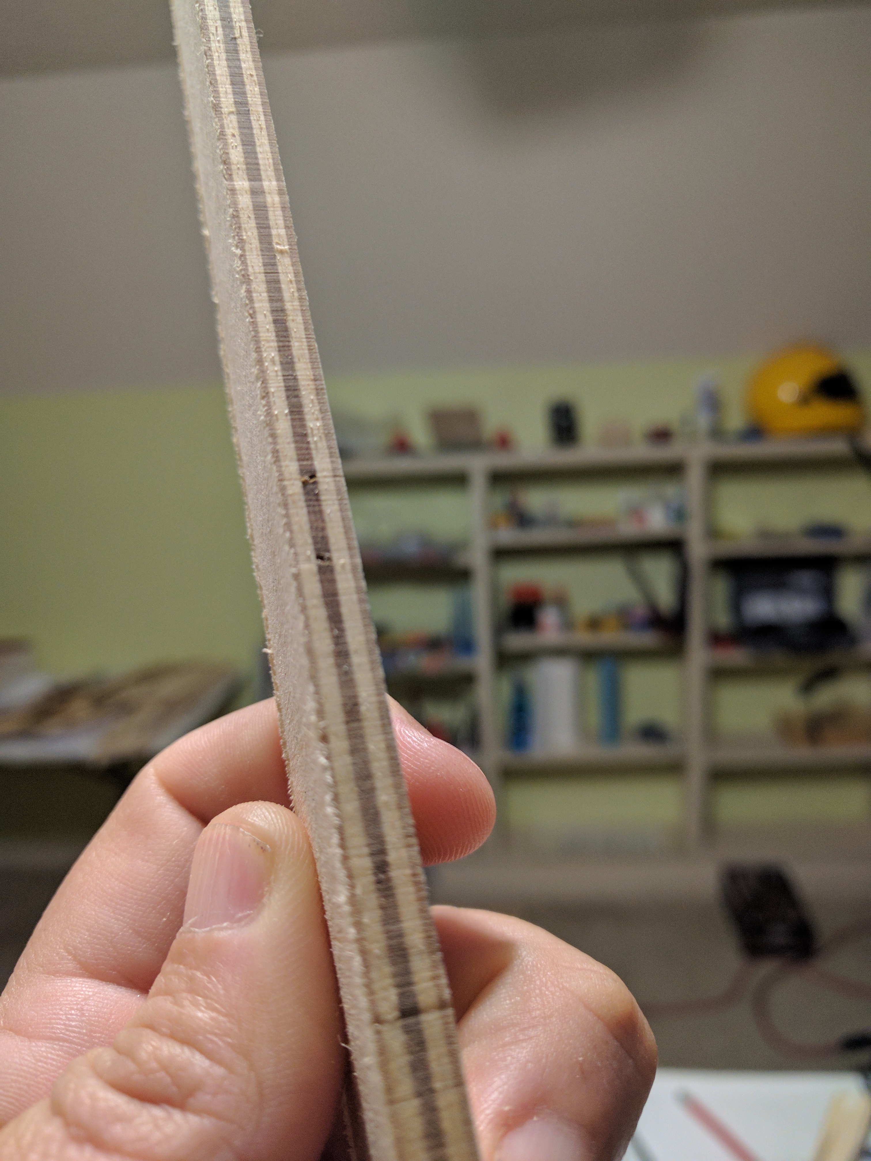

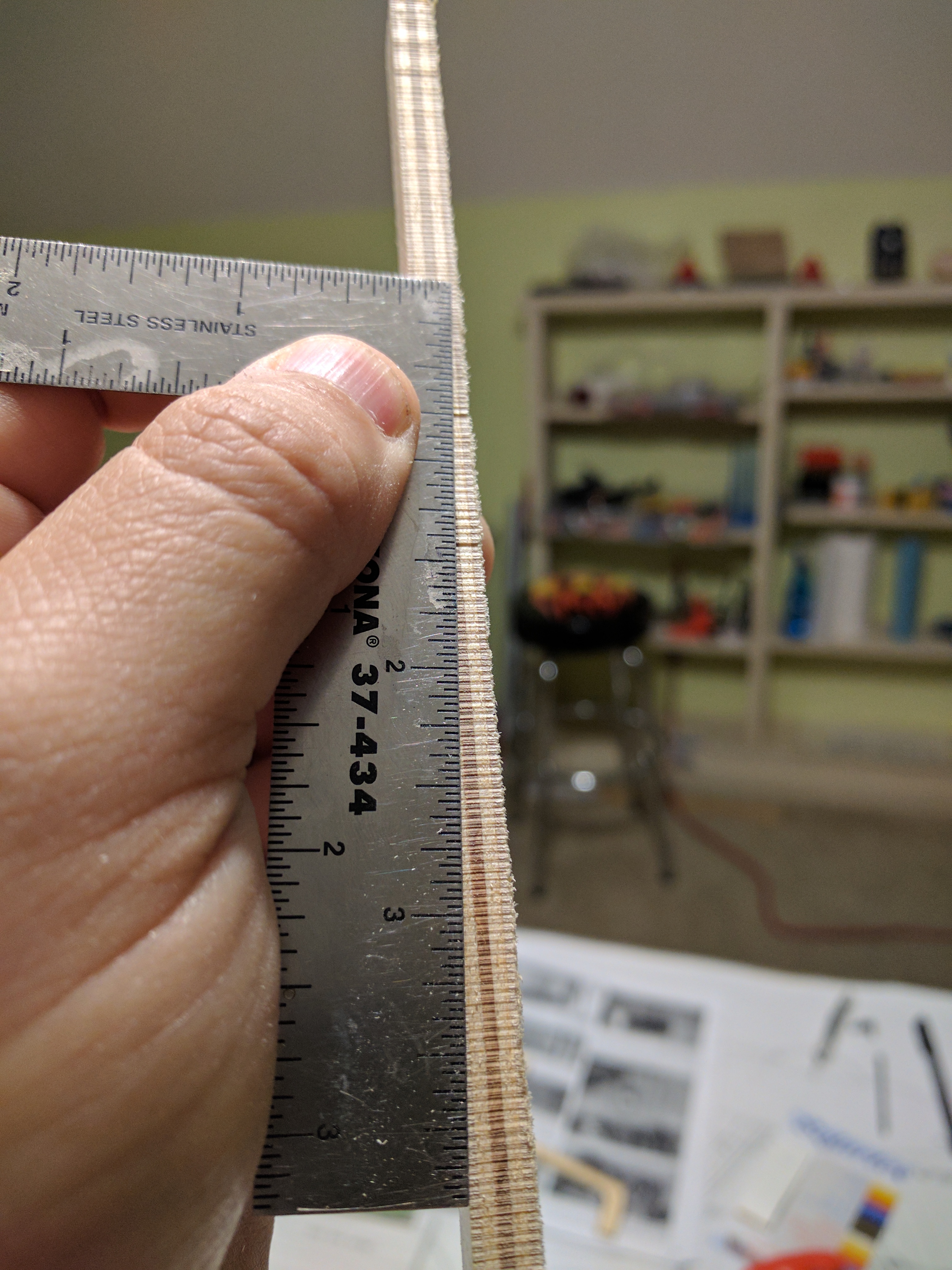

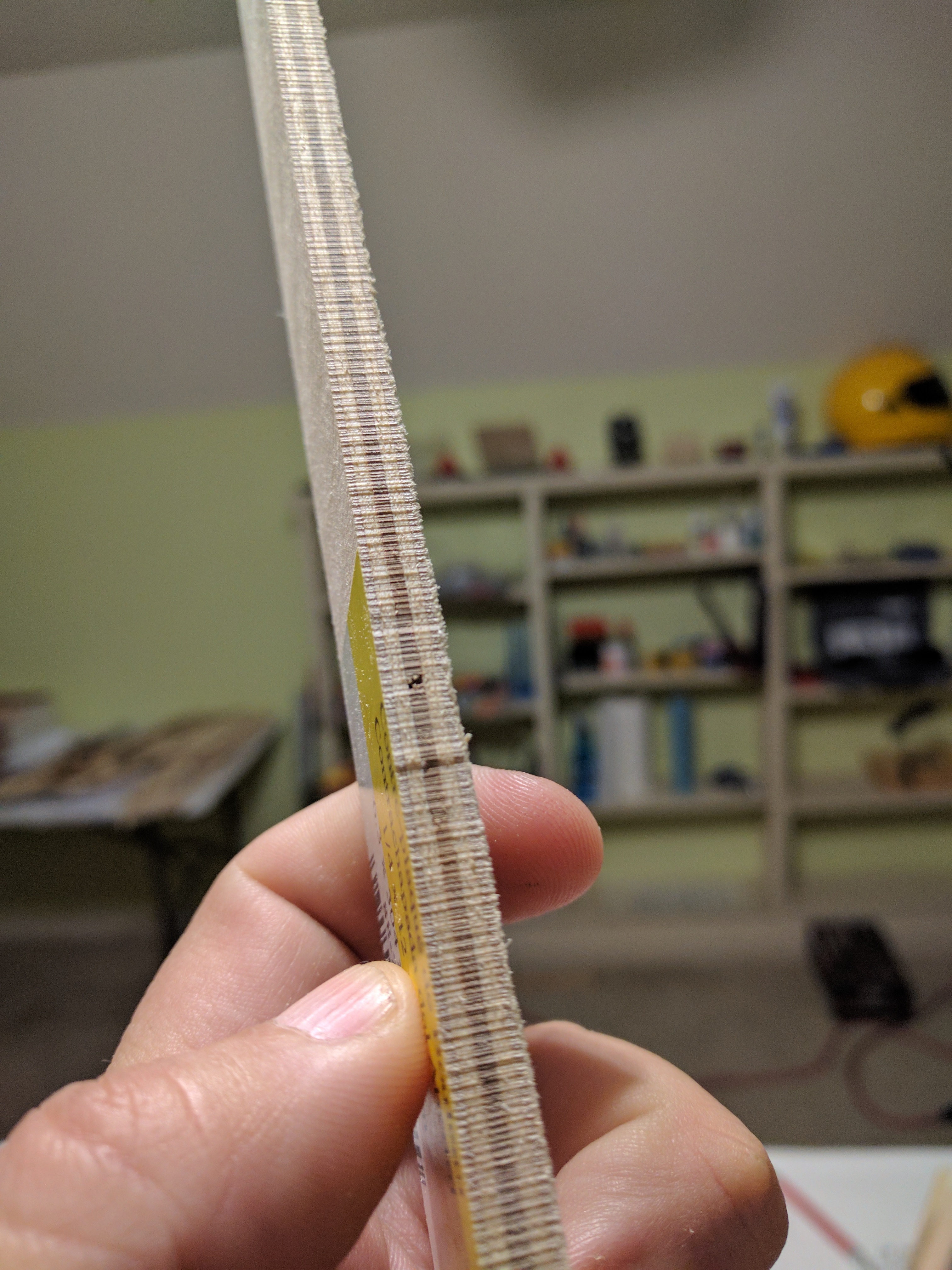

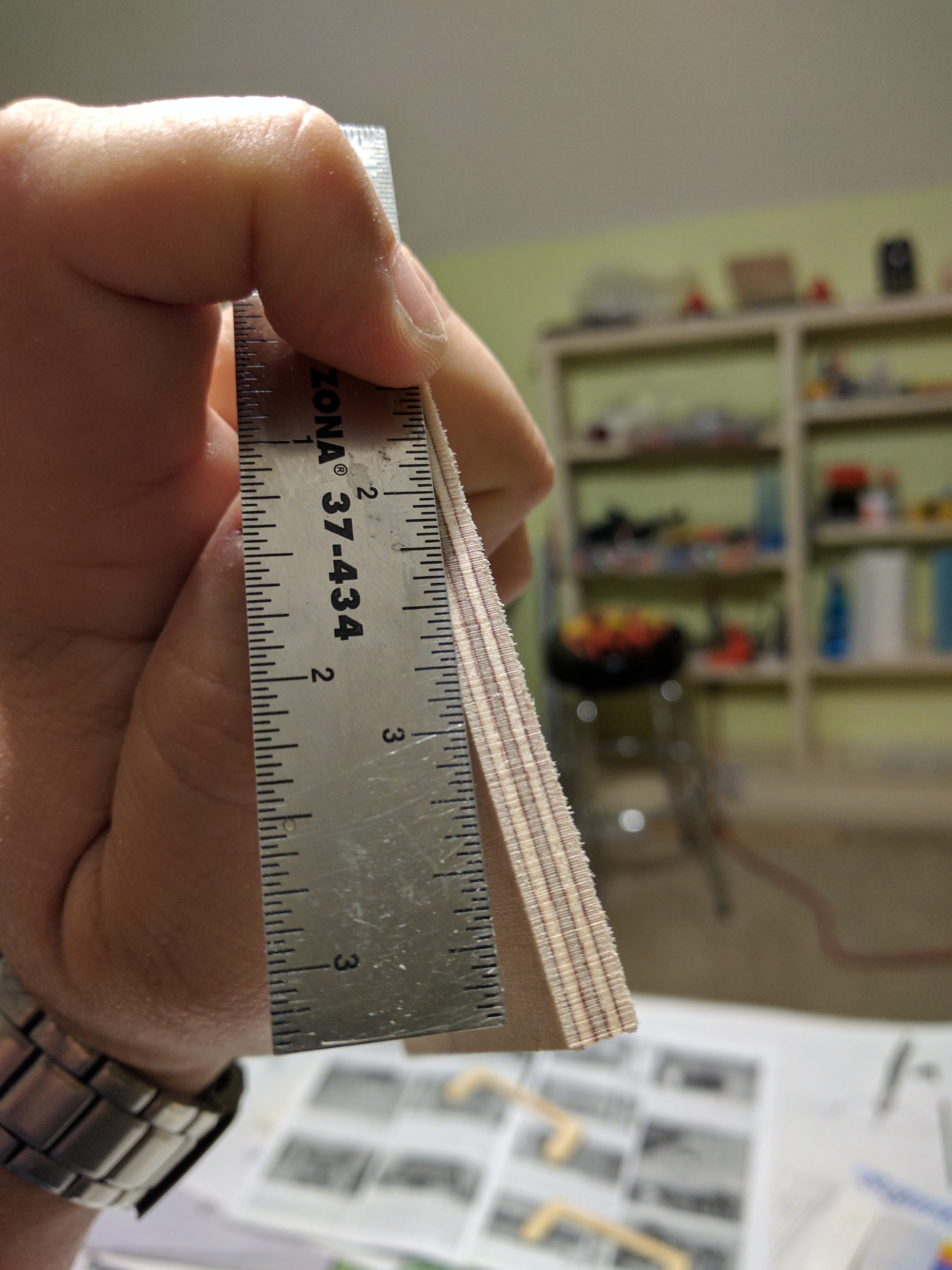

Here's what I'm getting (pretty typical for all the blades I've tried:
This cut was with another new blade installed, a 3/16" 14TPI Raker. This cut is better and for me is close enough that I can just kiss (maybe french kiss...haha) it with sandpaper on a block and go. I was kinda surprised as I wasn't expecting a coarser pitch blade to make a better cut. All the other blades though seemed to have kinks in them around the welds where as this one runs really true so maybe that has something to do with it. There aren't a lot of high-quality blades (ie. Timberwolf et. al.) that come in higher tooth counts in a 70 1/2" length. This blade, like most of the others are Magnate sourced from Amazon, two others were Powertec.
I will try dressing the teeth a touch but this is absolutely workable like it is. Thanks for the ideas fellas...

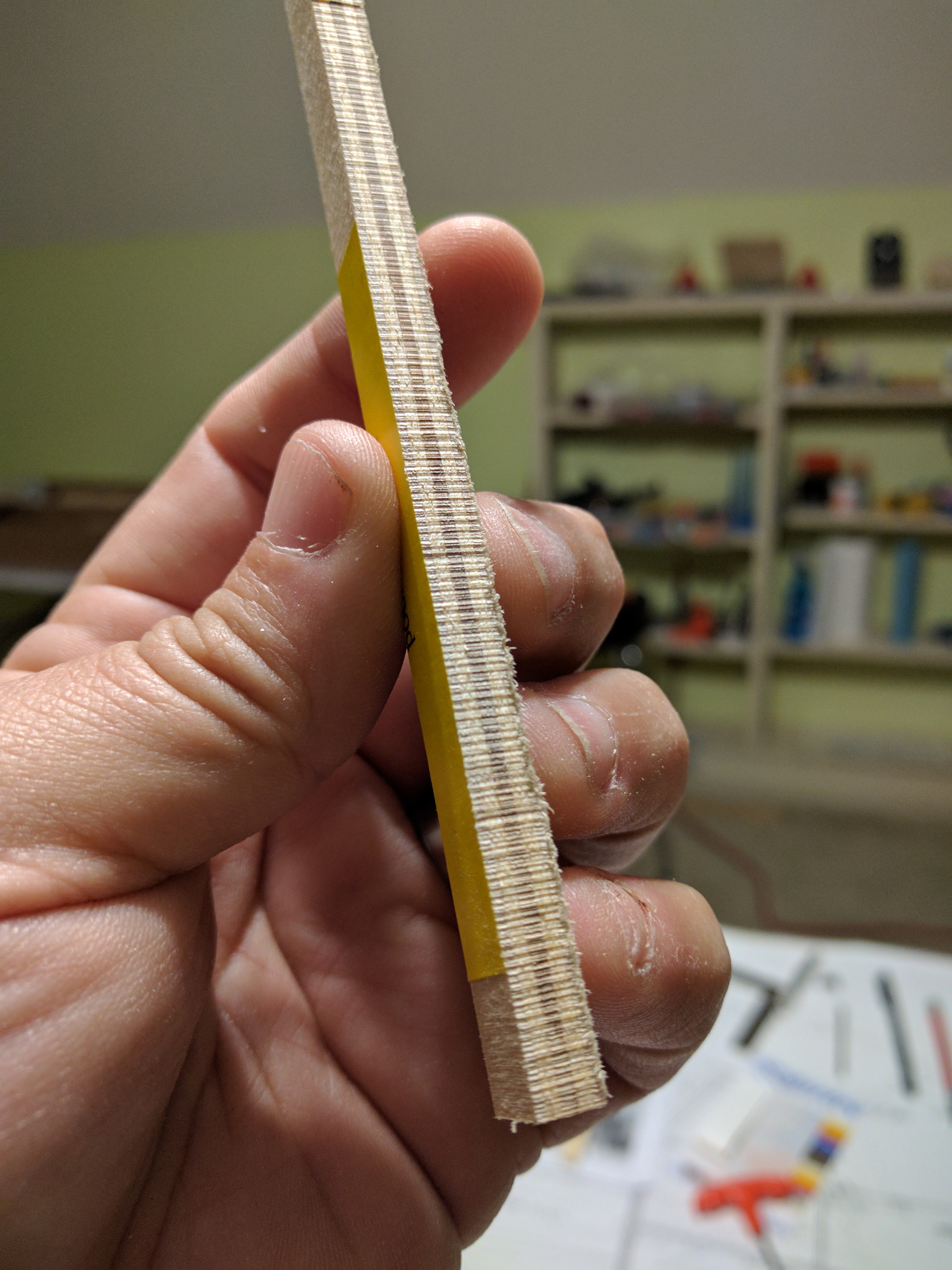

Not ditching the bandsaw now. Check this out.
These were both cut from the same piece of wood with no other adjustments. Pretty conclusive proof that dressing the blade ever so lightly with a sharpening stone works better than I thought it would!

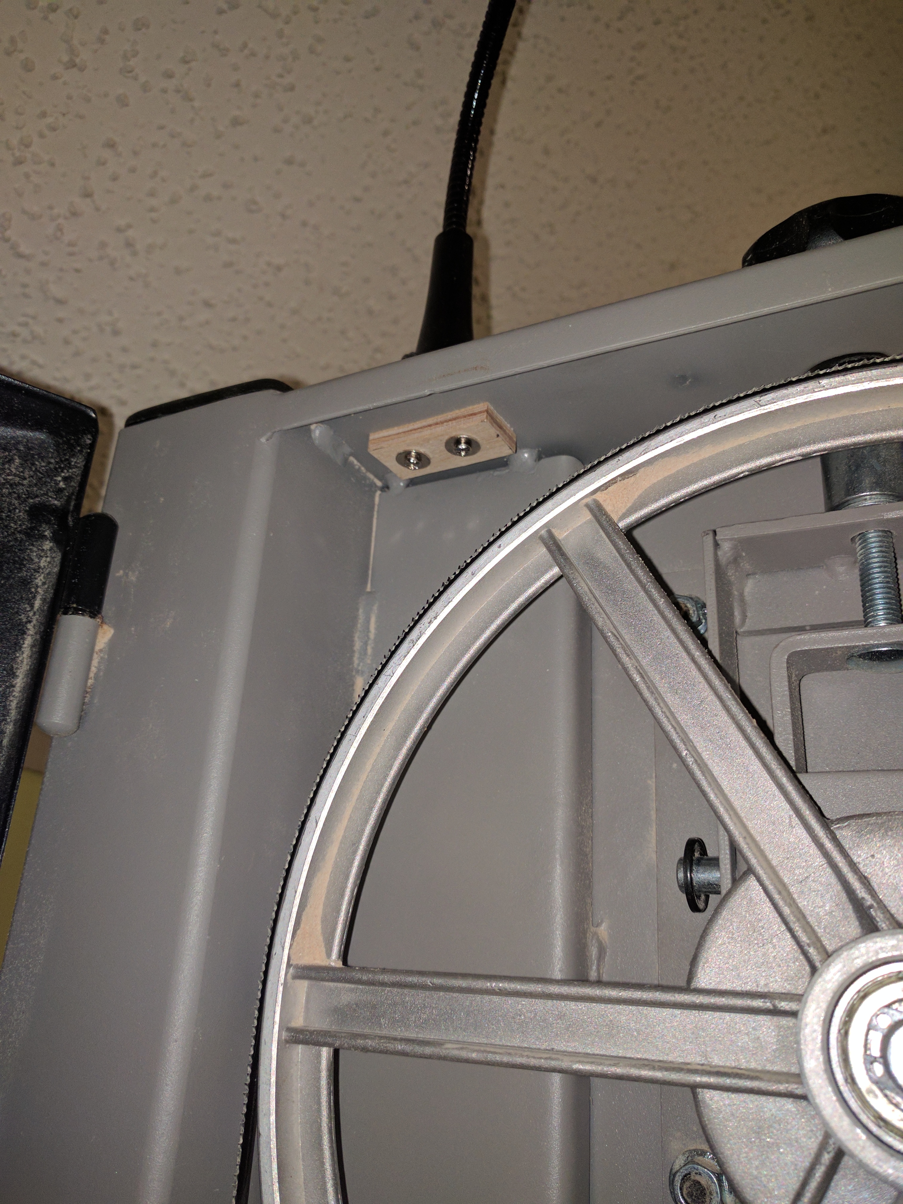

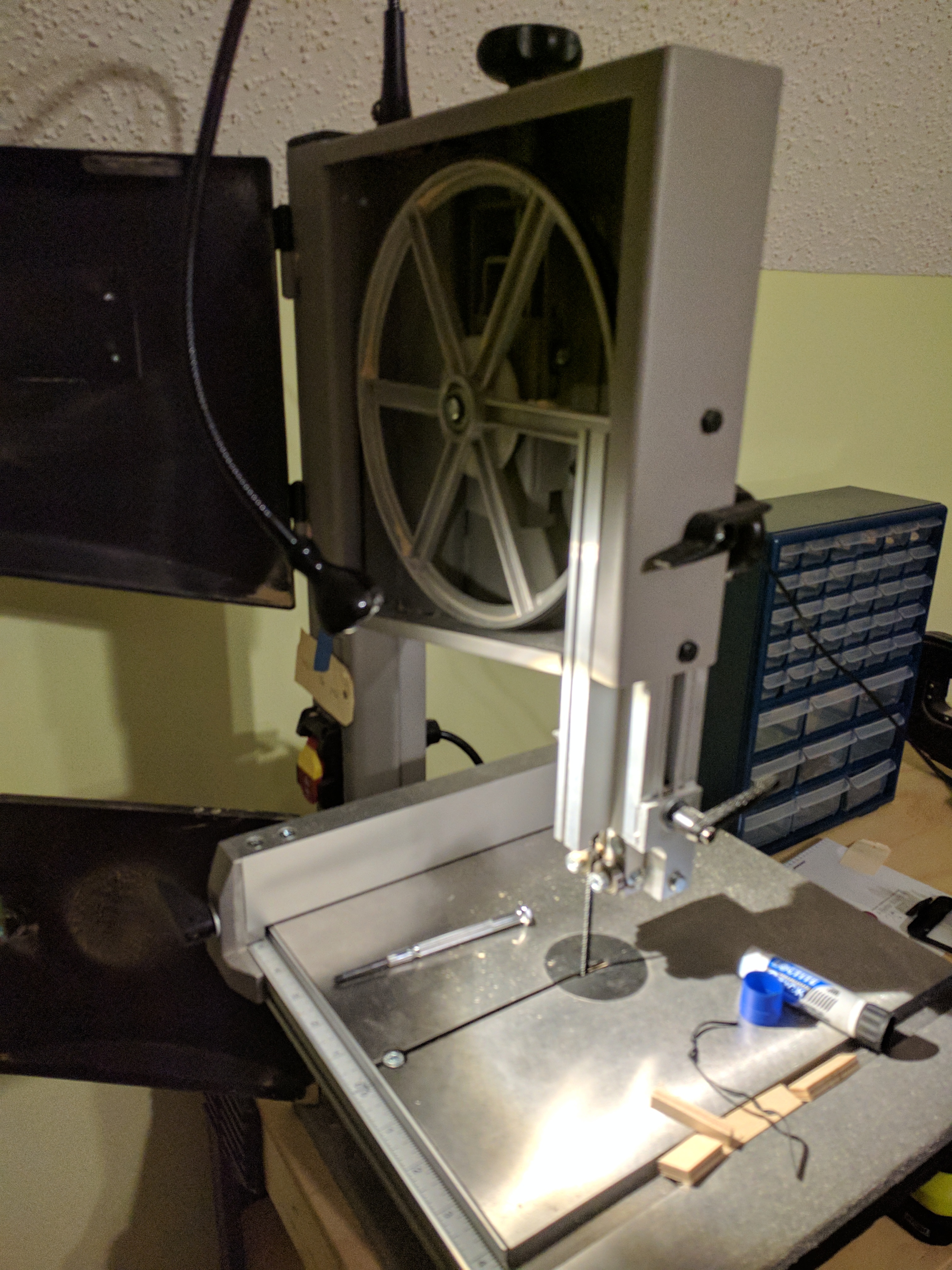

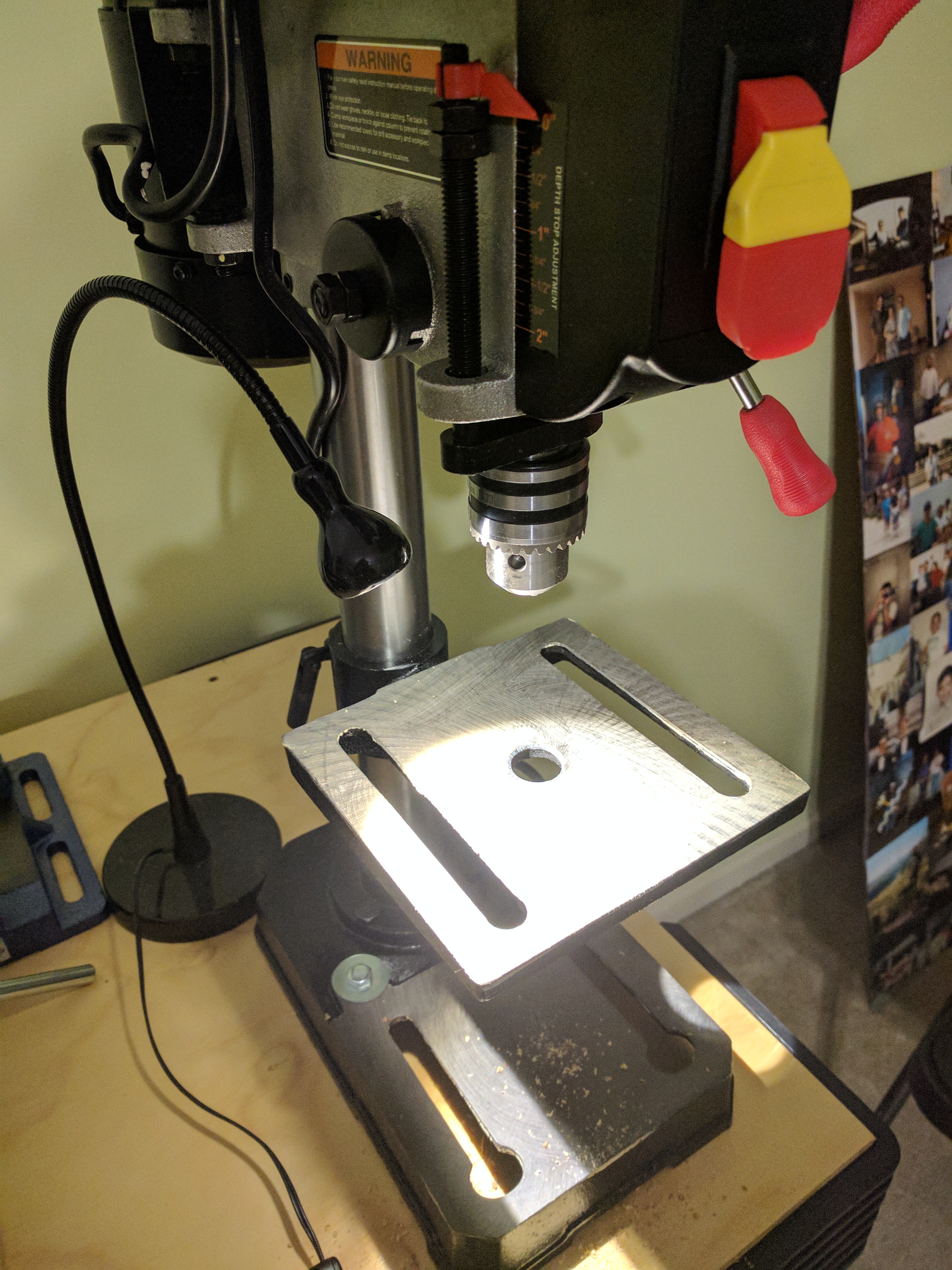

So, this saw didn't come with a built-in light so I spent $15 at IKEA and just built one in for myself...
Pic1: I bought two lamps. This is what it looks like set up as intended.
Pic2: I ditched the base, drilled two holes in the frame, and added some plywood (there were stand-offs for installation to the base that I didn't want to take the time to remove).
Pic3: The work area illuminated. Not bad for 15 and 15 (dollars and minutes).
