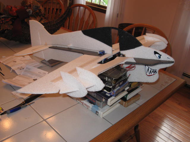

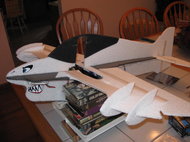

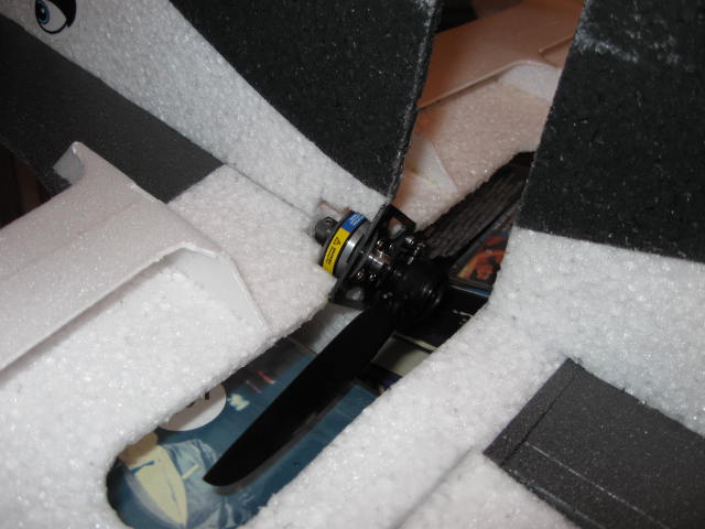

Thanks Fernando
Fantastic! Glad I found someone who has some time flying a 4D. I originally wanted to put a VPP unit on my Bug which is 6 oz but people are saying its too small with only a 23.5 wingspan. I have three planes , Trying to save a little using planes I have, that I was thinking of adding a VPP unit into but everyone thinks their tooo small. My Bug 6oz was first choice my Slick Extreme 6oz second and my Yak 55 3D third. The Extra 260 with showstopper VPP and 370 hollow shaft motor fro E-flite was my next choice and I priced out all the parts. I guess you used the 20 amp ESC Elite makes? I don't know if it has a governor in it or if its needed with this. Does the 260 fly good for you?
Here is a pic of my Bug if you think I can use the 370 motor and showstopper on it with a better ESC and heavier VPP servo let me know.
I have even had some suggestions to get a mid motor plane but hard to find in the US.
Do yo have any pics you can share? Thanks Ron

Hey no problem darticus,
I think your best choice will be the Slick Extreme because the electrifly Yak 55 3D will be to heavy. But even the slick dont look to strong on the nose, you can try to reinforce it. The extra 260 fly very good I have it a little on the heavy side since I fly it outside. I did have to reinforce all the CF so they will not pop out in fly or in a landing. You can use the E-flite 20-Amp Brushless ESC it dont have governor, is not necesary to have it but with it it will give you that extra help of preventing the ESC
from overpowering the sistem by regulating the rpm. I have the BL-12 for my RCU bipe and have a Phoenix 25 by castle creation for the extra 260 both have governor. I also have the e-flite 10-Amp Pro Brushless ESC I use it with the extra with out a problem but you have to be careful to not over amping the sistem by giving to much pitch. My opinion, the extra or other planes will do better than the ones that you have, you can still try with the slick but you may have to reinforce it good. I have some plans for a mid motor plane that you build your self, if you want to try it. The materials may come close to what an ARF plane will cost you. Think of what plane you will like and let me know Ill be happy to help you choose the sistem. I have some pics Ill try to post them soon.
Fernando
Fernando

I think I want to follow you. Maybe I should search out an Extra 260 the 370 hollow shaft motor the showstopper and that Phoenix 25 by castle creation that you said has a governor in it. It sounds like this works. I guess the BL 12 ESC by great planes would also be good as it has a governor. So I think I'll be a copy cat and do as you did.
I'm using a DX7 Spektrum radio that I would have to set up for this and get an extra 6100 receiver. I'm not a great flyer but think this will be interesting to try. Send any info you can my email is [email protected] if you want to email.
