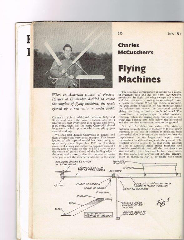

Construction
Construction is quite simple, with the emphasis on strength. The blade and stabilizer are of sheet rather than built-up, the motor and balance arms are of spruce, and the hub is reinforced with 1/16th plywood. The motor arm is inlaid into the lower surface of the blade, the reinforcing plate double-glued over the joint, and the whole bound with silk or other light cloth. This area is then virtually unbreakable, and also a good flat surface for the balance arm to bear against. You can, of course, glue or even bolt the balance arm in place, but Charybdis is much easier to carry around if the arm is detachable.
The blade is simply a 2' x 2" lath of 1/4-in. medium sheet balsa, shaped to a constant Clark Y section. No wash-in, no wash-out, no dihedral breaks; the squarest, easiest wing you ever made. Use a template to maintain section accuracy. Don't try something with undercamber instead. McCutchen tried both undercambered and curved-sheet airfoils, and found the resulting Charybdis to be unimproved, at best, or just plain unstable, at worst.
The stabilizer struts are 1/8th hard sheet sanded to a streamline section. Use plenty of glue and perhaps even some silk reinforcing at the strut-to-stabilizer joint, the only vulnerable area of Charybdis. The stabilizer itself is also 1/8th hard sheet, but is given a lifting section. Be careful to set it at an angle of at least -50 or -60 relative to the blade, as this is most important.
The motor pod is so designed mainly because it looks good. The streamlining probably helps a bit, but is really unnecessary. On the other hand, it does provide a solid mass behind the firewall (if you can call it that) and a little more weight. (The Cox 010 is awfully light.) The 1/8-in. plywood firewall is inlaid into the motor arm, and the pod itself built up from the same 1/4-in. stock used for the blade, or anything else in the scrap box, then carved and sanded to shape With the motor inverted, as shown in the photos, the mounting screws bear through into the spruce arm instead of the soft balsa. Add a wire guard loop if you think it necessary, but the prop generally seems to be enough protection for the glow plug even when landing on bare spots.

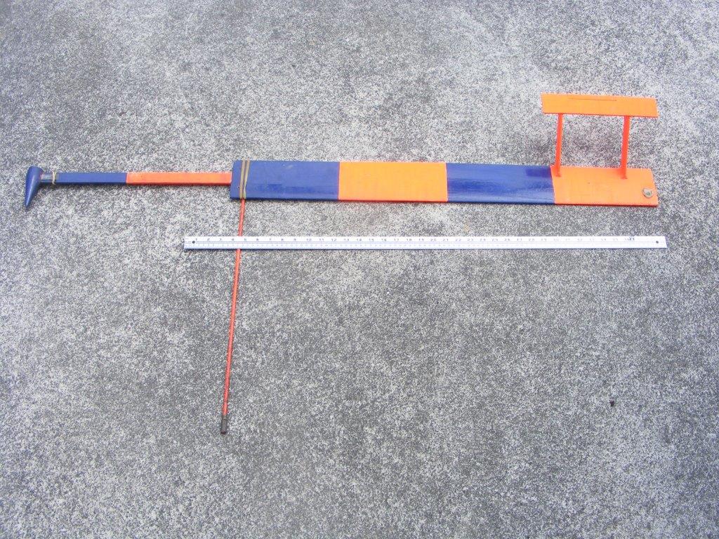

Got yours built yet? Go 4 x 30-32" for an .049, stick with the stab negative incidence recommended - 5-6 degrees. That's the magic.. torque the wing into positive angle of attack on climb, autorotate on descent.

They are bizarre, but actually quite user friendly - get it about right and off they go. The Russians held the helicopter duration record for ages with one - in the '50's, 60's Russians and Brits and who else would build these things with built up wings and small diesel engines with central tanks.. and fly forever. Too much fun not to build one. It's a 1-1/2 - 2 hour build plus finishing touches. Run a Sure Start on pressure, solves the centrifugal fuel delivery nightmares. Depending what engine/tank arrangement you use, I've had examples where the engine had to be almost choking on fuel before I could let it go. Others needed only a minor offset. Helps when you take a couple of minutes to plan ahead on the fuel system..

Actually technically they're 'McCutchen flying machines' after Charles McCutchen the American postdoctoral nuclear physicsstudent at Cambridge University who first created them in 1953-ostensibly as the result of a bet in a pub to design the simplest stable powered flying machine. The 'Charybdis' was a nod to one of the two legendary monsters believed to live in the Straits of Messina between Siciliy and the mainland; Charybdis was a whirlpool that could swallow ships whole....
Attached are scans of the original article published in Aeromodeller the July 1954 issue
