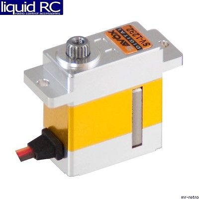

Old 12-27-2016 | 12:41 PM
Pond Skipper's Avatar
Joined: Dec 2009
Posts: 2,826
Received 7 Likes on 7 Posts
From: Texas, TX
Here is one to help with that warm and fuzzy feeling.
http://www.ebay.com/itm/Savox-SV1232...YAAOSwvzRX1hxp
Savox SV1232MG Micro Digital Servo 0.05/69
Price:
US $99.99
Old 12-27-2016 | 03:26 PM
Joined: Dec 2005
Posts: 716
Received 38 Likes on 36 Posts
From: La Florida
Too bad he only has two of them....
Old 12-27-2016 | 04:36 PM
Joined: Dec 2009
Posts: 2,826
From: Texas, TX
http://www.ebay.com/itm/Savox-SV1232...sAAOSwyQtVrp3u
This guy has 8 of them $61.80 ea. so for a mere $494.40 your all set with 8 servos... not as greedy on profit / with free shipping.
