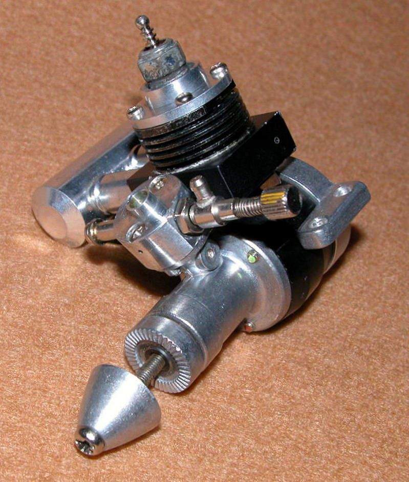

I have an .061 that I purchased a 6x3 prop for based on instruction sheet that came with motor. The hole in the center is bigger than the screw that holds it on. Can I just use brass tubing to make a bushing to fit or is there any commercial nylon spacers available? The screw that holds the prop on is the same as that of an .049 cox. I am also having difficulty locating a pressure fitting for the muffler. Any suggestions? I know Cox has props that fit their shafts, but someone has to have run into this issue and resolved it. The prop I have is an APC sport 6x3.

Actually the G-Mark prop screw is 3mm metric: M3x0.5 which makes it a bit smaller than the Cox 049 prop screw which is 5-40 thread-and 1/8" diameter. There are plastic bushings available from APC that can be used for bushings-but brass tube is just as effective-you may have to telescope a couple of sizes to match the prop ID with the screw OD. A 6x3 is a good match for the G-Mark-which peaks around 19, 000-so about 3000rpm less than a Cox TD 049-the APC with its relatively narrow blades is a very good match. If you haven't run it yet-my advice [and I own about 6 of them!] is to run it in gently-these are nice engines-but they take a significant amount of running in compared to a Cox. If you give it just a token Cox style run in, you will be disappointed with it in use.

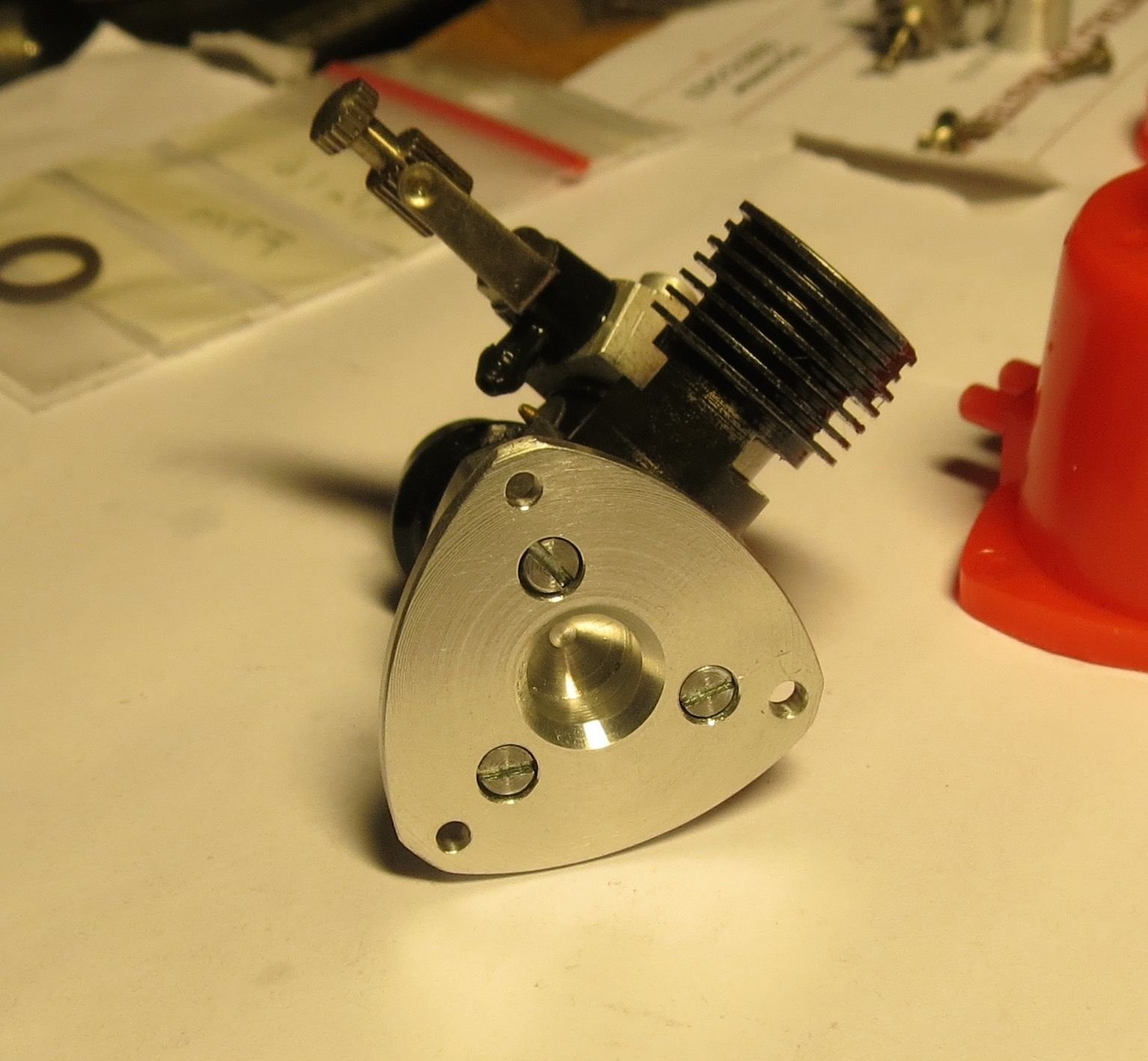

so I have had absolutely no luck on finding a 1/2a size exhaust pressure fitting. I am probably going to build my own radial mount out of aluminum bar stock as well as I have not been able to come up with anything there either.

I suggest you try a 4-40 pressure tap-you will probably find them on one of the cl stunt or cl racing websites. People like Joe Klause of Kustom Kraftsmanship and Fox used to manufacture them as accessories-but these days they are a bit thin on the ground. As an alternative-if you have a lathe-or access to one-then a cheap way is simply to drill out a brass machine screw to a suitable ID, thread a nut on and solder it, and cut off the screw head-it won't look terribly elegant (unless you machine off the threads above the nut)-but the fuel line will cling on just as well if you leave the threads on.
The G-Mark ..061 radial mount is easily copied-it is simply flat aly sheet attached to the engine with the original backplate screws...the originals are not very common-nor are the plastic ones for the .03-but not hard to create a copy. I will draw my one up, and scan it (with a suitable rule included) so you can print it out full size as a template. The UK's Mike Billington did the only published test on the G-Mark 061-published around 1985 in 'Aeromodeller'.....to the best of my knowledge there has never been one published on the .03. If you have the means-and the inclination, Billington indicated that the engine responded well to more nitro-but needed cylinder shimming to increase the exhaust timing to properly benefit from this-and likewise an adjustment to the head insert depth. Reading between the lines-the head itself could benefit from a bit better design-either to take an insert, or a Nelson or turbo plug.

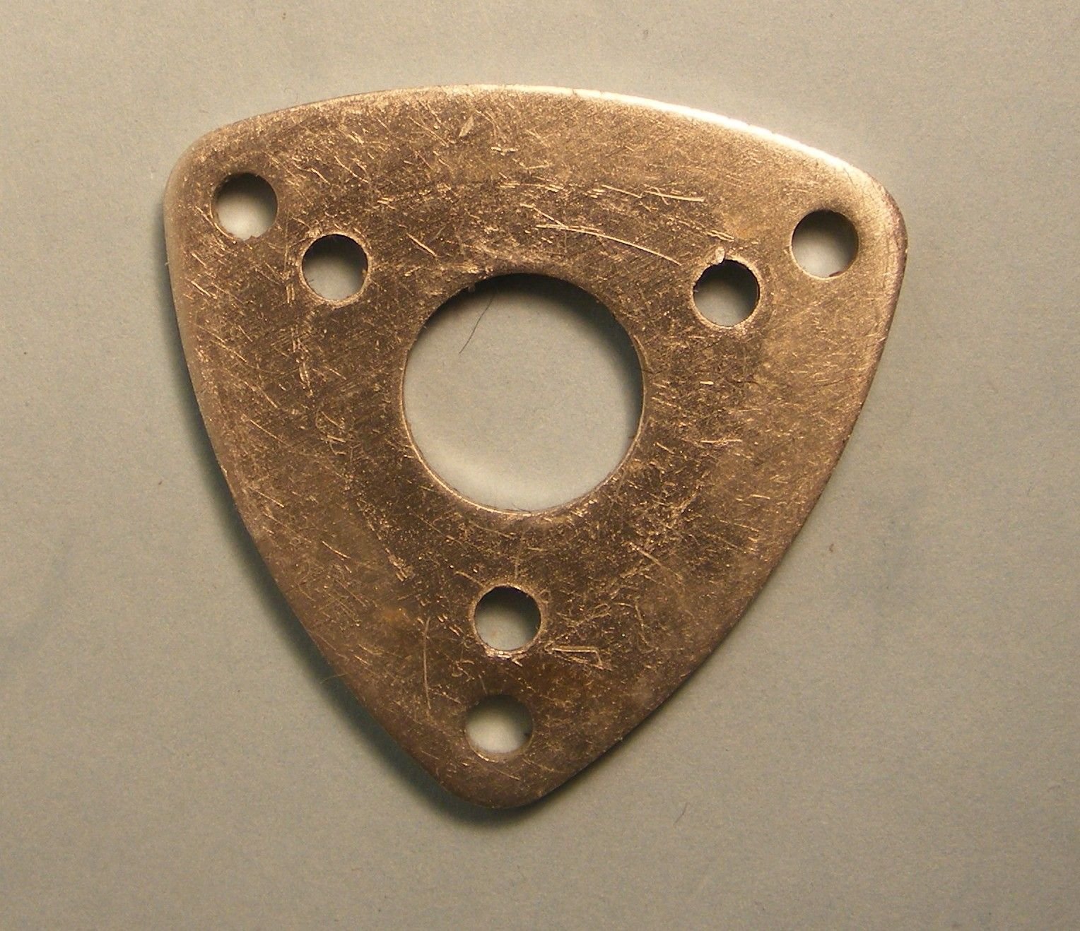

I thought at one time I had found a 4-40 pressure tap from radical rc, but I’ll be darned if I can find it again. The drawing of the mount would be amazing. So the screws are long enough with say 1/8” aluminum to use stock ones? There would be a countersink in there the depth of the screw heads, so it wouldn’t actually be that much.

OK here it is-very rough. The material is 2mm thick alloy-the centre hole is 10mm diameter, and the inner 3 holes in a triangle match the backplate mounting screw location. The mount has been stamped or edm cut, judging by the edge marks. A thin slice 2-2.5mm thick from a piece of 35mm round bar would give you a suitable starting point. All holes are 2.8mm ID. These inner holes are counterbored 4.2mm (11/64" nominal) on the firewall face of the mount to provide clearance for the screw heads [this need not be done if you use countersunk screw heads...in which case obviously you countersink the mount to seat the screws flush. Obviously-depending on the thickness of your radial mounting flange you may have to use longer backplate securing screws....

i shaved a bit off the mount drawing by making a crescent indentation between the ears. It seems that the triangular mount is way over engineered. The thought crossed my mind to shave the beam mount ears off the crankcase to save some weight, but it won’t be that much and with the possibility of that being designed into the case for structural support I decided for now to leave it alone.

The drawing looks good for the .061, one just have to be careful with having enough bolt length for the threads in the crankcase. I wouldn't bother with removing the regular engine mounts, there is hardly any weight to save there anyway.

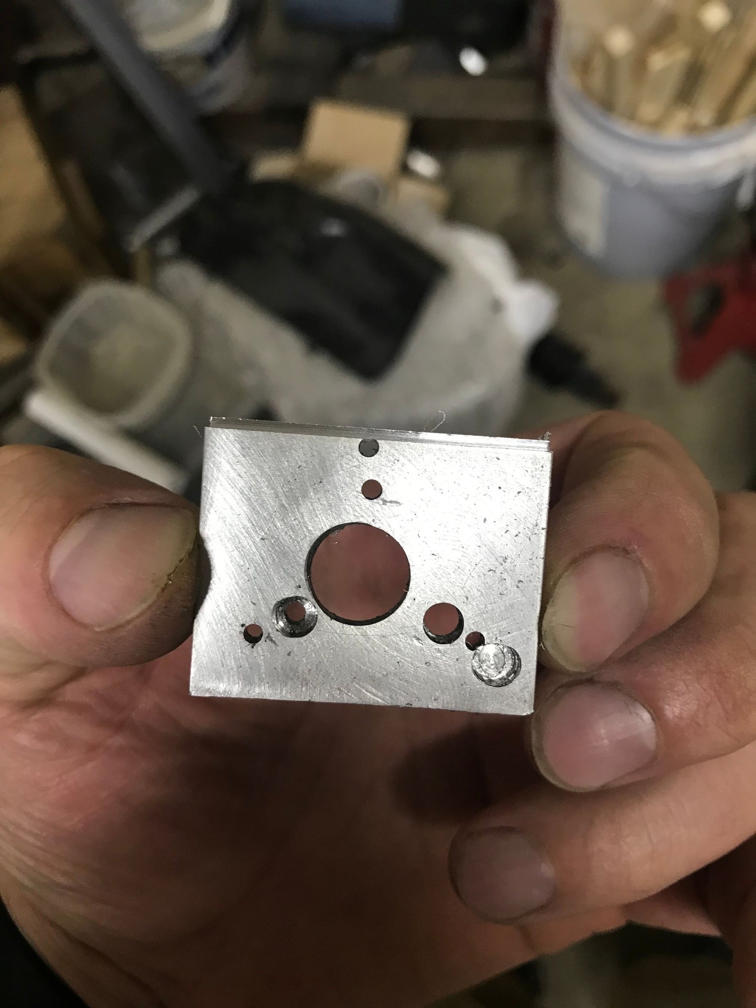

I got a piece of 1/8" 6061 t6 to use for the radial mount. There certainly isn't going to be an abundance of thread left after counterboring, but it appears to me that it will be adequate. The 1/8" is about 2.98mm thick so I am thinking I will do diet version as it is quite a bit thicker than original. The other option is to sand the piece down (dont have access to a mill) to thin it out a bit and just go with original design as posted by ffkiwi. I am not sure how to proceed on this yet, as I only have a drill press and hand tools. The counterbore is my biggest challenge at this point with making the bottom 90 degrees for the screw to seat against firmly. any suggestions?
well counterbores only go down to 3mm screw size generally in any case....in your situation the only option I'd suggest is using an endmill or slot drill to open out the screw hole to partial depth for the counter bore effect. Obviously you would need to clamp the radial mount fairly well-and be careful with your alignment. Considering the tooling you have available, I would suggest using the clearance drill for the screw shank to align the backplate mount under the drill, clamp well, then without shifting anything loosen the drill from the chuck and replace it with the milling cutter or slot drill, and cut the counter bore, then repeat the process for each of the remaining two holes.
are you familiar with FC3 cutters? these are combination end mill/slot drill disposable cutters-which are much cheaper than either endmills or slot drills-and available in a range of metric and imperial sizes. One of these in the right size would do the job-the only two alternatives would be a D-bit.....and you dont have the equipment to make one-or one of those 'fishtail' carbide burrs-if you can find one that matches the screw head diameter. Whatever you use for the job-make sure the drill chuck is really tight-drills are not very good being pressed into service for milling as there is no means of axial limiting the cutter movement in the chuck, as there is on a proper mill.

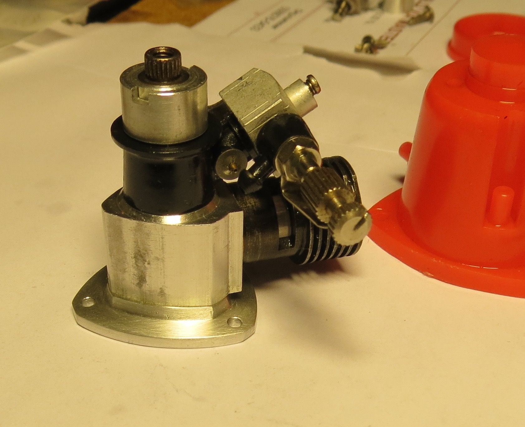

Default Radial mount build
Her is my first try and the final draft. I still need to cut some excess off. The recess holes are 2.24 deep with total plate width of 2.99mm. I’m thinking about thinning the plate out a bit but we’ll see.
