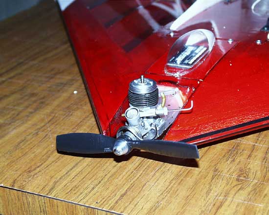

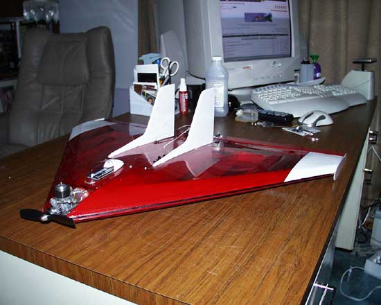

Ok, a little background first. The delta in the pictures below has been flown many times with the Norvel Start Up .061. Non-throttled, cheapest engine on the shelf engine. I've been flying it with a Master Airscrew 6x3. It flew very well. Slow and stable like a trainer. I had my black box in it for a while and it showed 40mph in a straight line. (no dive for speed first) Wednesday I decided to experiment with the prop. I had an old cox thimble drone 6x3 prop sitting around, so I took the scissors to it and cut it down to 5x3. Of course, the black box was not in and it performed spectacular. Just eyeballing it I would claim 75+mph without a dive for speed. The engine was spinning over 20,000rpm after it unloaded in the air. (again, just guessing.) That doesn't seem safe to do with the old plastic props.
Q. Does the increased tip pitch on a cut down prop increase speed and thrust?
Q. Are there safer props to use for this?
Well you have 2 good things happening at once with the cut down Cox I think.Number one the engine must be happier with the 5x3 and number two the Cox has alot more blade area than the Master I'm Screwed props. A Norvel just does not like to lug a bigger prop like a cox TD can. Just my 2 cents. Awsome looking delta you have there!

First a quick note. If you start with a 14x6 prop and cut it to 6" diameter it's still a 6" pitch, provided the blades were shaped accurately you end up with a 6x6 prop. When you decrease the blade area you have decreased the engine load, and rpm will go up with the same power to drive it. In theory, if you increase the rpm by 50% you increase the speed by the same amount. In the real world it doesn't work that way. The larger diameter you can run, the more efficient it will be. This is a generalization ignoring speed, sometimes you can get more speed by decreasing diameter even though the prop is not as efficient as the longer one might be.
I'd be leery of the old Cox props, they were just plastic. For normal rpm ranges they are fine, going to 30K and higher I'd rather use wood or the FRP ones like the MAS and APC.
Now let's get down and dirty. How fast do you want to go, and what rpm do you think your engine will pull? Let's try 80 mph and 40K rpm. Your 3" pitch prop, at 100% efficiency will give you almost 114 mph, real world efficiency of 70% puts you right at 80. Now take that 5x3 and start trimming the blades until you get about 35K rpm static. What? It blew up at 27K? OK, then we need to pitch for 80 at 25K rpm. Believe it or not, just by going to 3 1/2" pitch at 70% we get a little over 80 mph at 25K. Now start trimming the prop again, this time stop about 20K static. If there's enough prop left to get the plane off the ground the engine will unload in the air, and if you do get that 70% efficiency you'll get your 80 mph. But more likely it wont fly at all. Just not enough prop left.
I'd suggest the best way, really, is to get a 5.5x3.5 prop and fly it. Cut it down a little bit at a time between flights, balance it, of course, when you don't get any further improvement either leave it alone, or cut another to the size you had on the flight before. Props that size are cheap enough to ruin one or two.
But I really don't think that Norvel "Start-up" is going to have enough power to get a lot of speed. But I have been wrong before.

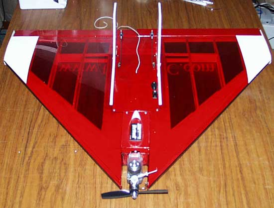

Since nobody said "TAKE IT OFF BEFORE IT KILLS YOU" I'm going to fly it this sunday with the cox.

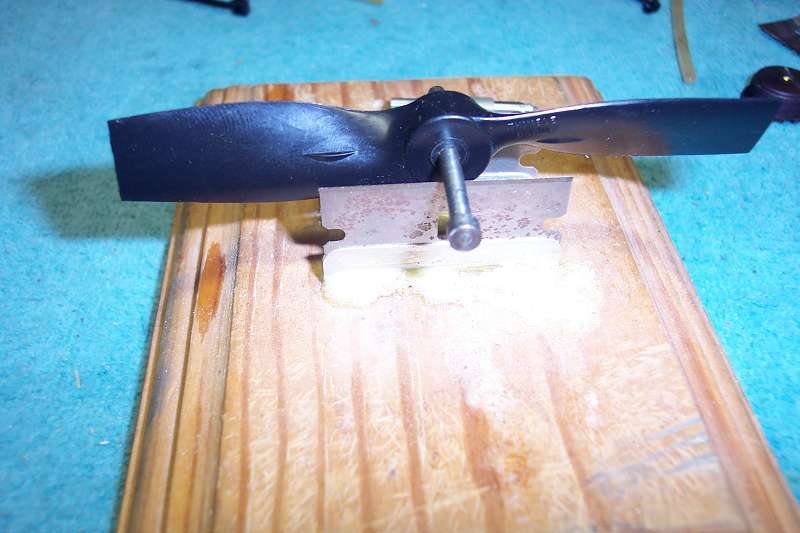

Yep, the black Cox 5X3 is, as Dickie said, truely magic. It works so much better than it looks that it does not get its full due. Years ago, Dan Rutherford took to calling them Rubber Ducky's. It fits.
We have used them in 1/2A C/L Combat for years. Now, most serious C/L Combaters have gone to carbon and glass props, but a Rubber Ducky won CL 1/2A Combat at the Nats again last year.
To get the VAs turning where they need to I cut the tips off. I usually make up a 1/2 dozen props from 4" to 4&1/4" before a contest. You need the engine turning in the 30's in order to not bog in continuous tight loops (at S.M.A.L.L. someone asked what the VA on the CL plane was turning, so I dug out the tach and it said. . . 31,400).
I start the cutting process with a pair of side cutters to get the length close and finish with a single edge razor blade to square the tips and balance the blades.
I have never thrown a Rubber Ducky blade. We abuse them with lawn dart landings, midairs, and such and they "wear out", but seldom do you break a blade off.

Thanks for the pics Larry. I use the same balancing method for small props but as I am an accident waiting to happen I kept my eyes open 'til I found a small, clear plastic box just the right size to glue the razor blades into opposite sides and still be able to close the cover to prevent 'oopses' and leakage of vital fluids. The cover is about a third of the total depth of the box. Had I been thinking I would have glued the blades into the cover giving more room for the prop to teeter-totter without having to grind a relief into the sides of the box. A piece of music wire or drill stem of the proper diameter to fit the prop hole tightly and slot into the box diagonally for storage completes the assemblage.

Dickeybird,
I ordered some 5x3 cox props after getting those low rpm numbers with the 6x3 MAS props. They are not cheap @ 2.69 each from Tower. The new .049 and .061 Norvels should like them too.
I guess my plane was so heavy the last time I tried them, it was never able to get up to speed. I have learned not to use AA alkaline batteries
Larry, I'll have to try that razorblade balance, I have the balancer that you hold between your index finger and thumb and the razor blades will work with that too. Thanks for the picture.
Lynn
