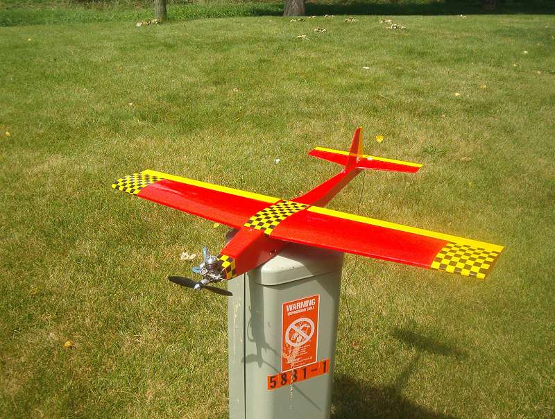

Man that TT.07 must be a DOG! Here's a pic of my Simple 400 with a Norvel .061. The verticle on this one is fine. It won't go vertical out of a hover or any thing but it will hang on the prop for about 3 seconds befor it starts inching back towards the ground.
Rrrag.

Rrrag, You're right, it is a dog! It has no vertical at all. Using 30%, 6x3 prop, ~16 oz., not near fast enough either. Tried a 6x4 and it was slower. The rudder has weird coupling. I could put the Norvel on it, but that won't help the goofy rudder coupling. So, I thought it was time to look for a plane designed to fly better.
