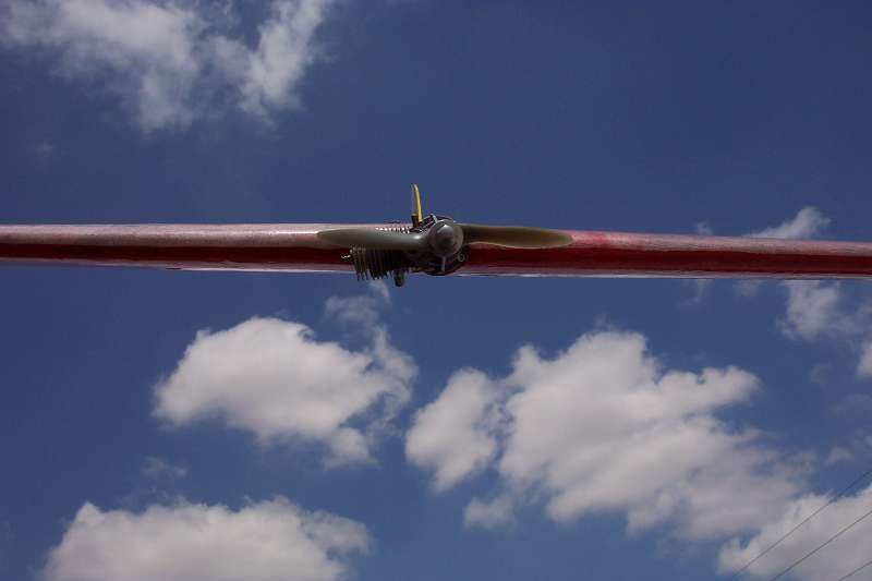

I have about finished a new LH RC and mounted a Cyclon .061 on it.
The plane is 9 ounces with a Hitec 555, two HS-55s, and a 50MaH battery.
The engine is turning an APC 4.2 X 4 34,800 with peaks at 35,000. 35,000 calculates to 139 MPH, disregarding airframe drag and prop efficiency.
So we are going to lose a few MPH there, but if the 4.2X4 unloads in the air, the engine is going to be turning a few more RPM too.
I'm fairly sure I can fly these things at, maybe, 90MPH. The other 30 or 40 MPH may be a bit problematic.
I best start with an APC 6 X 2.

LARRY, you know from your past experience above 100 mph that the faster you go, the quicker the elevator gets, so if you're in the inner hole at the servo arm, and about an inch up on the control horn, you should be just fine. The aileron travel is nice to set up with dual rates if you can, but I flew the MUSTANG with a $50 single rate radio with just low rate throws, like an 1/8" up and 1/8" down. I'll bet you're in for some exciting action!

The first flight on my SIG Little Extra was exciting as I had forgotten to load any exponential. Every time I have tried to fly one of the wings without expo it has been a bout of gross over controlling.
I have this thing set up with -65 percent on both ailerons and elevator and a 50% rate on dual rates.
I suppose I could also put a Fora or Cyclon .050 on for the first flights ... or I could just send ole PIGG an airline ticket or ptulmer a gift!!

I have "removed and replaced" the engine on the LiteHawk RC. All work was accomplished with independent labor under contract.
I removed the Cyclon .061 and mounted a Fora .050 and put a 6X2 prop on as well. The Fora with the 2 pitch should be good deal slower (50 MPH or so) than the VA with a 3 pitch is on my other LiteHawks (80 - 90 MPH).
That should make the trim flights more sedate. I have less trouble finding dual rate switches than I have finding the aileron or elevator trim. At 50 MPH , or so, the trim findin' and trim flight experience ought to be more enjoyable.

Just be carefull of that 6x2, the safe limit is 190000 / 6" = 31,700, and I have thrown blades before APCs' mathematical redline was reached..

I got a couple of flights in with the Fora powered LiteHawk. The first was with the 6 X 2 prop. After that I switched to the Magic Black Prop (a Cox 5 X 3 Rubber Ducky cut to 4 X 3). It was pretty slow on the 2 pitch prop, but nice with the 3 pitch. With the Cyclon .061 and more pitch it will be a bullet. Keeping it aimed during a flight will probably leave little time for political discussion.
I had one trim issue that I think is related to the engine possibly not being properly square with the wing. Right after launch I was way out of elevator trim and it took lots of up trim to trim hands off. But when the engine quit (there is no throttle and, hopefully, every landing is dead stick) the plane pitched up a bit and it took a good deal of nose down in the glide.
I looked it over and it appears the engine is mounted pointed a couple of degrees down.
Since the plane is on the edge of tail heavy, I think I will build a shim out of 1/8" ply and sand an angle in it to get the engine set a zero offset.

LARRY, your approach to getting it dialed in worked pretty well. It will be interesting to see if you end up with a more forward CG liking for RC flying than for CL combat. Have you flown the .020 plane yet?

Today we figured out that towing a F2D streamer is just enough load to make things more pilot friendly. As a bonus there is more to see when the plane tries to disappear too!
Flown the .020 ?
Well, sorta flew it. I still don't have the engine running well, but it was almost calm today and I gave it a try. The plane flies, but there was not enough power and it was right on the edge of a stall, except when it was stalled. I need to get with the engine program and get that figured out. However, the builders are all playing with their competition planes now and I will not be able to get any changes or more engines until the snow flies.
