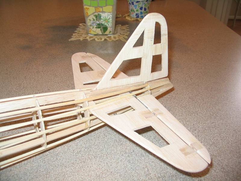

Lotsa work done over the past few months, but not many photos. [
] [:@] Fuselage is done, as are the fin and stab. I'm still thinking that I need the lower longeron in the wing saddle for overall fuselage strength, and so I've built a wood box that keeps the longeron largely intact and lets the aileron servo sit in the middle of the wing for lateral balance.
Although I did some initial layouts for the electronics and tank before I started to build, my theory and my reality seem to differ. Everything fits, but not very well and it won't be easy to secure. The good news is that my weight so far is just above 11.5 oz. I'm going to sheet the body to the end of the wing saddle, and use silkspan and dope for the final finish.
eroc
] [:@] Fuselage is done, as are the fin and stab. I'm still thinking that I need the lower longeron in the wing saddle for overall fuselage strength, and so I've built a wood box that keeps the longeron largely intact and lets the aileron servo sit in the middle of the wing for lateral balance. Although I did some initial layouts for the electronics and tank before I started to build, my theory and my reality seem to differ. Everything fits, but not very well and it won't be easy to secure. The good news is that my weight so far is just above 11.5 oz. I'm going to sheet the body to the end of the wing saddle, and use silkspan and dope for the final finish.

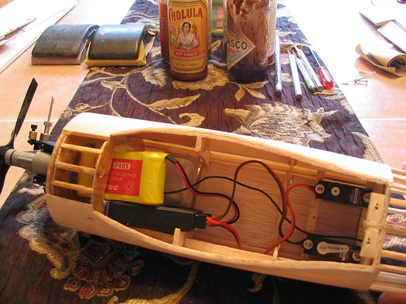

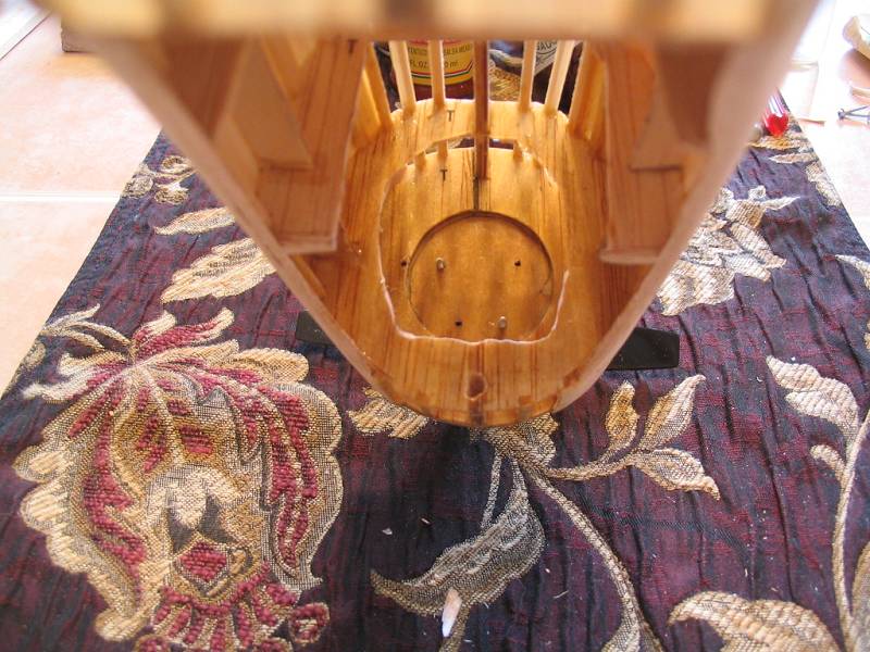

I'm on Christmas break and building time is picking up! I've decided that the "aileron box" is a dumb idea and is causing a lot of unnecessary building and layout gymnastics, so out it comes - Look at all of that room! I do a basic CG check and am surprised to find out that I'm incredibly tail heavy. In retrospect, I realize that the Zero's wing is pretty far forward, meaning that I have a small forward moment arm relative to the CG. Son of beech, Sheet.
So the question is: How much of the gear can I "shove" into the nose? The answer, as it turns out, is "A LOT!" The servos may need to move forward as well, but I'm going to hold off on moving those unless absolutely necessary!
eroc

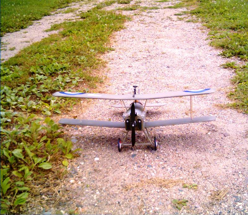

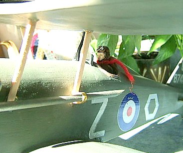

HI guy`s you got me thinking now .It was suggested to me, not to waste my time, on R/Cing, anything from Guillows.[
]I really like the scale looks of these kits.They are a pain,in the southern exposure, to build.BUT they can, be finished up pretty nice.I built the S.E.5A kit for my nephews ,this summer in a free flight version all sheeted in 1/32".The biggest problem with it, was a brand new
LOUSY running engine.IT just wouldn`t pull the plane it ran so bad..That sheeting makes for 1, tough/strong plane.....I was given some Guillows kits, with 3/4 of the balsa missing in them. So I want to scratch build from the plans,,All the plastic,and canopies, is in the boxes still.I want to do up the MUSTANG ,but 1/2 the Drawing is missing..Anybody able to help me out ,with that?? Please p.m me,if you can.. a couple pics
]I really like the scale looks of these kits.They are a pain,in the southern exposure, to build.BUT they can, be finished up pretty nice.I built the S.E.5A kit for my nephews ,this summer in a free flight version all sheeted in 1/32".The biggest problem with it, was a brand new LOUSY running engine.IT just wouldn`t pull the plane it ran so bad..That sheeting makes for 1, tough/strong plane.....I was given some Guillows kits, with 3/4 of the balsa missing in them. So I want to scratch build from the plans,,All the plastic,and canopies, is in the boxes still.I want to do up the MUSTANG ,but 1/2 the Drawing is missing..Anybody able to help me out ,with that?? Please p.m me,if you can.. a couple pics

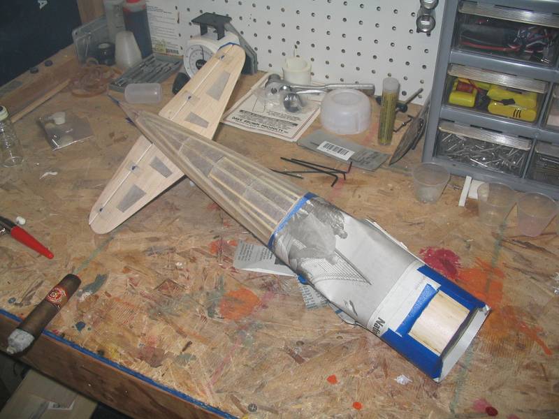

New Year's day turned out to be pretty low-key at my house and I was able to finish covering the Zero. I use Sig's lightweight silkspan and apply it wet using dope as the adhesive. (Just love the smell of dope!) I covered it from the tail forward so that the seams were facing rearwards, and did the fuselage / stab / fin with 9 pieces. I do a dry fitting of the silkspan first, mark the dimensions in pencil, and then cut the piece. Using exact-sized pieces means you have to be careful when applying the wet silkspan - a certain amount of tugging and sliding and rubbing is required - but I've found that I get a better overall fit and a tighter finish as a result. A few areas had "stubborn wrinkles" that had to be rewet and then "encouraged" using a blow dryer, but overall I'm very happy with the results. After each piece dries I put on a thin coat of dope so I'm ready for the next piece of wet silkspan. Once it's all covered I put on another coat of dope, then do a very light sanding so I'm ready to paint.
I bought a Paasche airbrush this summer but never got around to buying a compressor so my Brother has been playing around with it all summer. I found a compressor on sale at Lowes just before Christmas and now I'm dying to try it out. I'm going to use the A6M5 green & white finish with the yellow leading edge. Always thought that was the "coolest" Zero finish. Hope to get the white paint on today, but the green paint is on order so that'll have to wait until next weekend.
eroc

EROC There`s More than enough snow, around here now,The plane was Airbourne, but still have yet, to get a good flight out of HER.[:@]The engine is Running PREMO now ,but I have to repair the plane first, and try again.So yes, it got ROCKED alright..The 2nd vid, shows just how Rocked (concrete),it got..[X(]

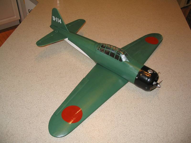

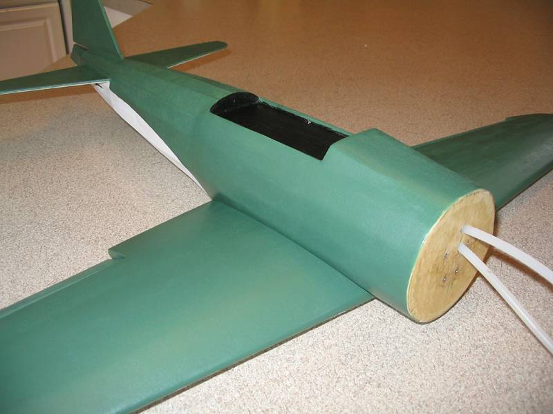

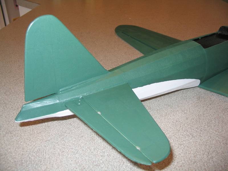

Well folks, I'm pretty much done except for the flying.
Spent the day yesterday making the cowling. I used the 'ole bottom of a plastic coke bottle trick ([link=http://www.rcgroups.com/forums/showthread.php?t=408653]Cool Cowl Trick[/link] middle of the page) and it turned out pretty nice. The hard part was finding a jar the right diameter, and the folks at the grocery store probably thought I was nuts "fondling" all of those jars. They're probably right. Cut holes for the needlevalve and the glowplug, then one for the exhaust. Might need to put a small silicon tube on the exhaust output to route it out of the cowling if it starts getting too messy in there. Really liking the looks of this!
Put several coats of dope on this morning using the airbrush. The airbrush is so easy and painless that I may have to toss my brushes. Wonder what else around the house needs painting... Aftewards I glued on the ailerons and the canopy, then applied the decals. I used the stock Guillows decals but I'm not sure I'm going to keep them - they're pretty underwhelming against the green paint. Then again, painting a red circle won't be easy either. The fuselage decals are WAAAAY too big - the tops and bottoms on each side almost touch each other - so I guess I'll need to paint a red circle after all.
Here are a couple of shots. I still need to put on the yellow leading edge stripe and then wait for a warm, low-wind day. Unlike CP, I like to wait for perfect flying conditions when taking out a new plane, and around Philly that might mean I'll be waiting until March. I'll keep you posted!
eroc

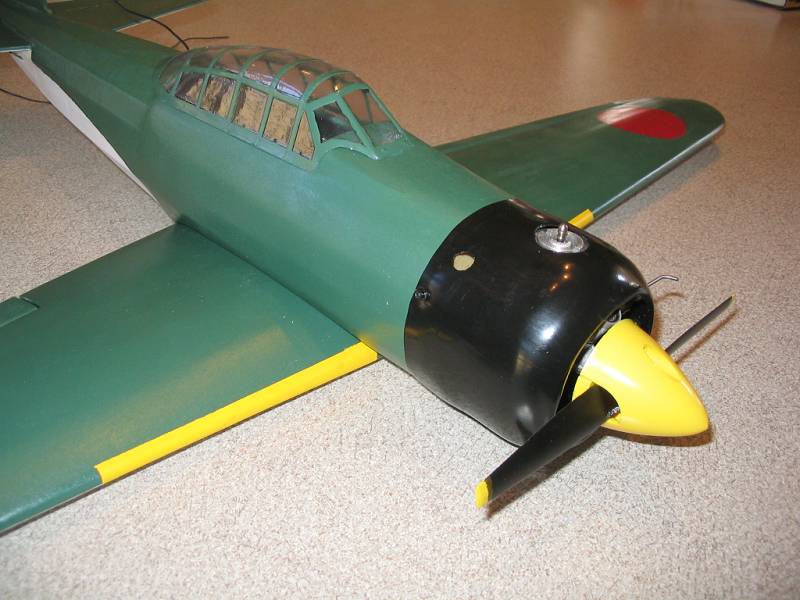

Last touches are done - Cowl bolts, leading edge strip, and insignia painted, spinner attached, antenna pulled through the fuse. Yee ha!
RTF!
RTF!

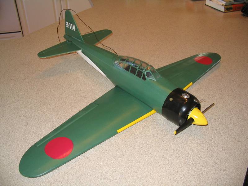

Guillows Zero Conversion - The final chapter.
After waiting all winter and most of the spring for the "perfect" day I finally got one this morning, and decided to take the Zero out for its maiden flight. My Brother brought along his new Herr AT-6 so we got two maidens for the price of one! We both did some warm-ups on our "easy" planes - Jeff on his Q-Tee and me on my .049 powered HOB 2x4 glider - and after a couple of flights we were both ready, although our legs were shaking even before our "easy" planes had landed.
Jeff went first and his T6 went off like an arrow. It flew straight and true, and was very stable. After trimming it out he did a few loops and even tossed in a roll or two. The landing was a thing of beauty and he dropped it a dozen feet from the pit. The T6 is solidly constructed, which Jeff proved a few landings later by flying into the outer limbs of a small Maple tree. The plane spun off the branches and dropped softly onto the ground with no damage. All in all a great plane and a great maiden flight!
The Zero was next and bolstered by Jeff's great performance I fueled it up, checked the throws and had Jeff give it the ole heave ho! After a reading a lot of posts in this forum about the Guillows conversions being dogs, bricks, et al, let me just say one thing - Wow! The Zero took off in a straight line and gained altitude and speed quickly. The .061 Norvel was screaming and the Zero quickly followed suit, and I cranked her down to 1/2 throttle so I wouldn't have to turn her around every 4 seconds! I barely needed any trim - just a little down and a little left aileron - and she was flying hands-off within a few seconds. She flew like she was on rails and was stable and responsive at the controls. The camo paint made following her a bit of a chore but when I buzzed the field a few times it was spot on realistic. (Maybe I'll add some flashing LEDs where the guns should be to make it even more realistic!)
After a few circuits around the field I decided to try a loop, but in the excitement of the whole event I started making mistakes. I forgot to add more throttle and also forgot to get some additional altitude (major DUHs on both points), and she tip stalled, dropped a wing and spun out about 1/3 of the way into the loop. After some frantic work with the controls the Zero finally gave it up and dropped into the tall grass next to the field. Luckily there was only minor damage to the silkspan and to the wing connectors, and I've already finished the bulk of the repairs. It promises to be a fun summer flying this thing around, and Jeff and I will likely have a lot of fun dog-fighting with our WWII birds.
So for those of you who enjoy taking a kit where it wasn't really intended to go, I give my thumbs up on the Guillows conversions. The conversion really isn't that hard if you know your way around the building table, and the Zero flies very well and looks spectacular flying around the field.
