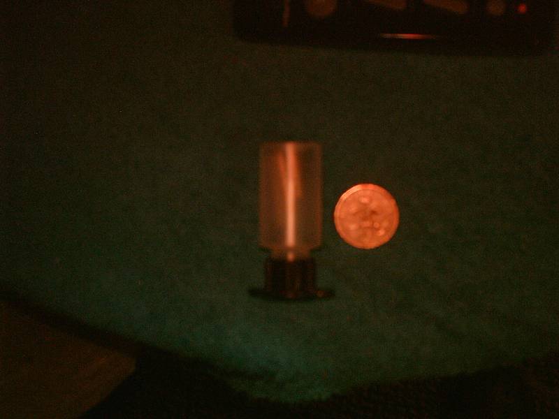

The biggest problem I find with the Sullivan and DuBro tanks is that the stopper is so huge that the clunk line starts half way inside the tank. I like the Hayes 2oz. It has a very small stopper with no rubber, the vent is moulded into the tank so there are no brass tubes. The fuel line that comes to attach between the stopper and clunk is black, very flexible and not silicone. A friend of mine uses them for diesel. They are often used on helis as a header tank - at 3 times the regular price.

Micro, MFA make a 1oz round bottle tank, it's transparent, the top is screw on of black plastic, type of plastic is PE(polythene), I use mine with diesel, the only thing you will have to change is the fuel line, cost £1.19, comes with all the tube-work, Thats a 2p piece for scaling. I got mine in Leeds If you send me £2.50 I'll post it to you and I'll include the diesel pipe for the clunk!

Howabout stuffing a small balloon into the tank, connected to muffler pressure, and draw fuel from say the tank's vent line (fuel is filled outside the balloon).
Clement
Old 06-29-2006 | 01:31 AM
Joined: Sep 2003
Posts: 521
From: Mission, TX
Default RE: fuel pickup nightmare - clunk or solid pipe?
My small diesels use the one oz.shampoo bottles from
hotels. Drill 7/32 holes and cut your black tubing at an
angle to get it started,then pull it thru with pliers. You
may use a clunk if you feel it is needed. Then screw the
lid on,it becomes the rear of the tank.
Ralph
