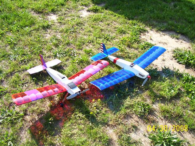

Here are some pictures of my Bee-Tween's. I would like to emphasize what someon e said earlier, that the spar should be beefier. I once had a rough landing and the covering was torn on the underside near the root. I sent it back up and did some radical manuvers and the Rt. wing parted company. Luckily the fields were soaked with rain so it only damaged the wing.

Here's a couple a flying buddy and myself built. The blue and white one is powered by the brushed 380 and the red and white one has the Super Cobolt 400, I like a little more power.

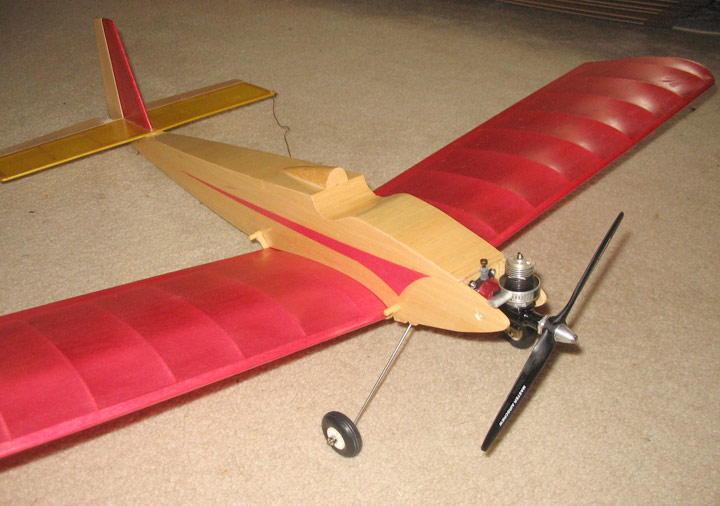

The Nickle was my first sport plane following training with a glider. Mine turned out tail heavy with Cox .049s, probably because I covered it with monokote instead of tissue. It would make a great plane for anyone with anything from a .049 to .15 to try. The build is simple enough to be done with just basic hand tools.
