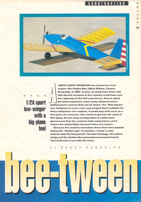

I found this MAN pull-out plan in a pile of old papers. Anyone here ever built Randy Randolph's Bee-Tween? I may have to cut some ribs tonight.

I kept those plans for years and never did build it. I think it's a great looking simple to build plane that would be alot of fun.

'Bee-Tween' plan was included in M.A.N. magazine Nov 1997.

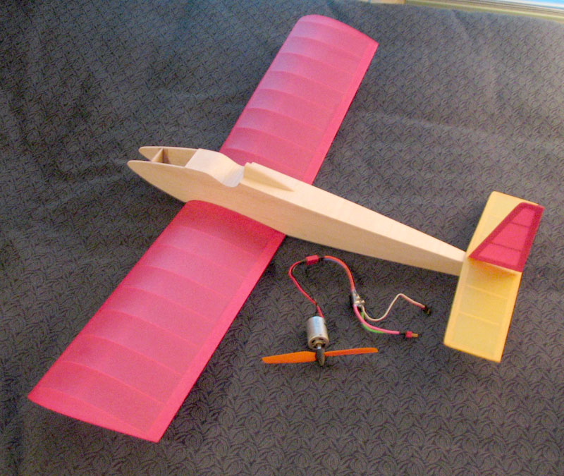

I know I'm going to get booted out of this forum for this. I promise to put a Norvel on the nose when they become available again. Or, maybe that underpowered CS would be just right for this plane.
Anyway, yes Dean. I have a GWS direct drive 400 with a 6x3 prop that I will try in this design.
All I've done so far is water shrink the tissue. A few coats of Brodak clear butyrate will shrink it even tighter and give it a nice glossy, fuelproof finish. I think I'll leave the fuse bare and just dope it so the wood will show clearly; maybe a red tissue arrow down the side to spruce it up. It's such a simple design I feel like it should just have a basic, simple color scheme.

That looks Great! You must have some years of scratch building under your belt or a great attention to detail. My bare balsa frame always looks a little rough, but even the bare balsa looks teriffic!!

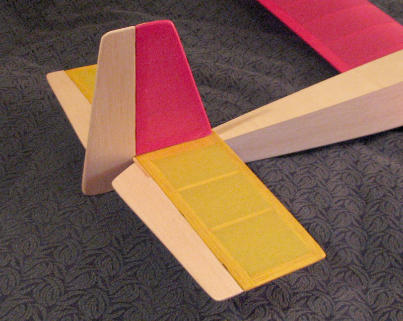

Thanks Dean. The whole thing can be built from your scrap balsa box. It's great being able to build a model without spending a small fortune on hardware and covering. I used the floppy disk hinging method.
rog, I always thought the Mantis looked more like a scaled down Astro Hog, but maybe I'm thinking of something else.

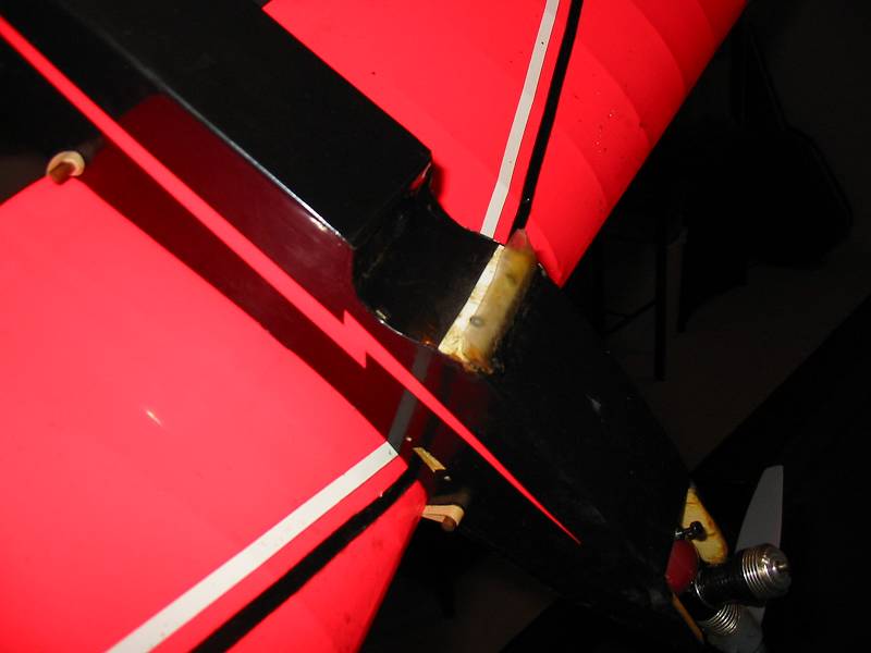

Ask and you shall receive!! This is my first Bee-Tween.. It has 2 Futaba Micro (Back when micros were still 1" square and cost $50 each) and a 4N cell Receiver pack. The Texaco .049 on front did fine.. My dad's has full size servos and performs amazingly well too.. I'll send you picks of my dad's aileron wing when I can get a pic of it.. The second pic is of the nasty cockpit area.. It has not yet lead to fuel soaking, but it is looking nasty and is hard to clean!

Very nice Dean! It actually looks kinda fast. Those lines make the wing look swept back. I like it. The red lightning bolt down the side is along the lines of what I was thinking of. Something just to give it a little zest. Are you hand launching yours? Is it tricky with the wing in the way?

Mine started out with Gear, but it ripped out in a hard grass landing and I found it to be more of a problem. It would catch in tall grass and flip the model over on it's tail. So I left it off and I am happier with it that way. Handlaunching is not to bad. If you are good, you can underhand it, but I don't do that often, or recommend it!! It is odd holding it so far back to launch, but it's not a problem..
THe biggest problem is ripping covering on the bottom of the wing.. I need to add some sort of clear plastic thicker than monokote to the first few rib sections from the leading edge to the spar. Do you know of any good material to use as "skid" protection to put on top of monokote?

Best thing I know that is widely available is the 3M Clear packing tape. It is a bit thicker and heavier than the cheaper other brands but even those would do a lot in that department.
Because it is clear it is hardly noticable as well.
As for the underhand launch you could actually make a skid from 1/8" lite ply and mount it underneath so as to have something to hold comfortably for launches. It would reqiure a little thought as to mounting but it has been done by many others in the past, removable wing or no.

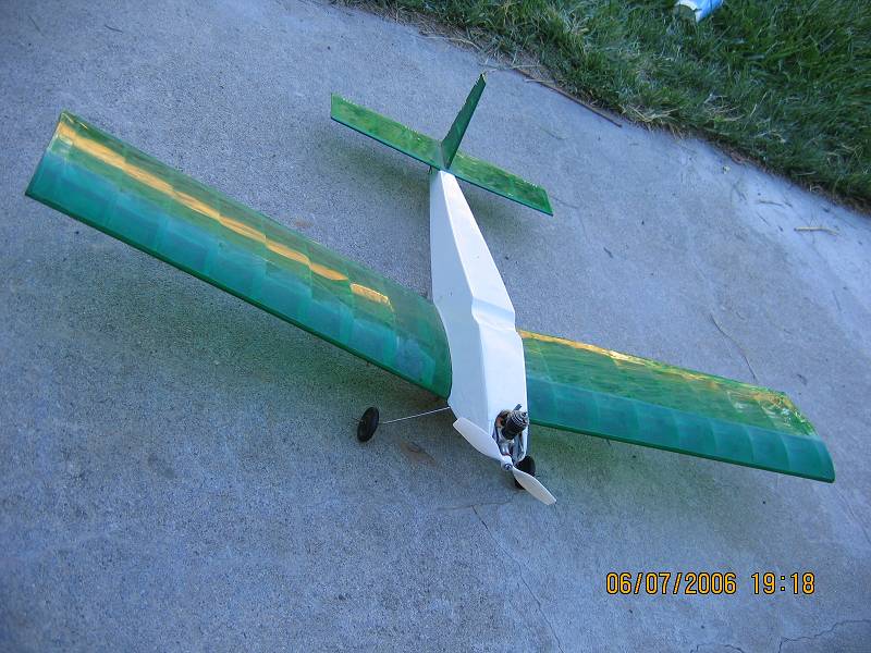

This is my scaled down .020 size Bee-Tween.
I had to add some lead weight to the nose to get it to balance.

WOW! An .020 version! That's amazing! I have never seen anything fly with an 020 other than a hankercheif and a few control line models! What's the wing span and how does it handle?
How Micro did you go on Servos, receiver, and batery? You have my attention!
