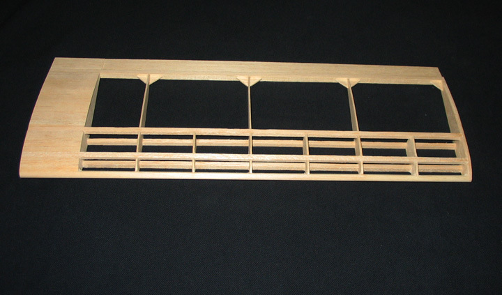

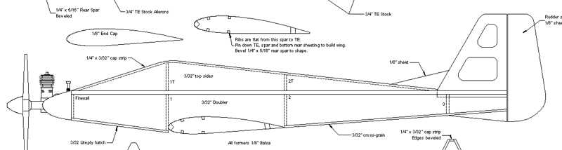

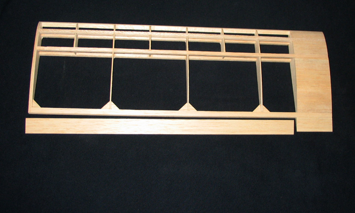

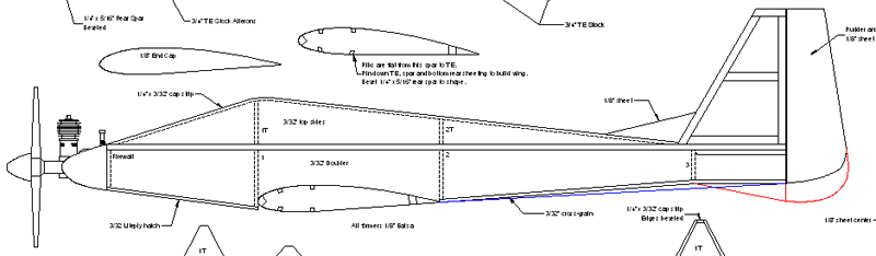

I decided to roll the dice and commit some lumber to this thing I drew up over the last few days. I'm picking the lightest balsa in my stash. I'm going to make this one come out under 10ozs even if I have to carve the engine from balsa.[X(]
One wing half done.

I take it your going to skip the sheer web for sake of weight? Well I like mine with throttle so I aim for an .061. Hmm picture a bulbus nose on that plan of yours... he he he

Thanks, Mr67Stang. Usually I sort of work out design features as I go. I see things in a built structure than don't strike me on paper. Adding shear webs half-way out is a good idea.
skaliwag, what do you think of this? I like the sub-fin better than the blue line, myself.
Remember, this is still a work in progress so I'm all for incorporating improvements that anyone thinks of.
Thanks, David

ORIGINAL: rainedave
Thanks, David
Hi David --
I like the blue line -- and would extend it out to the TE at the bottom of the rudder leaving the rudder squared off. The plane is angular throughout, so I think I would retain that in the rudder outline too.
This is the fun part of the hobby -- you can take someone's plans, maintain the essence of the design and add the esthetics of your own. Are these plans going to be available? (I hope!!)
What are the basic dimensions and what airfoil are you using?

Hi Dave,
Sub fin/rudders take a lot of abuse on landings. I kind of like to continue the bottom fuse angle all the way through to the f/R. They seem to last longer that way. Have you considered a shoulder wing? I think this plane would sure look nice in that configuration. How about cutting the fin and fuse end as one piece? You could just glue that to the pinched together fuse ends.
Nice looking plane though, please keep the updates coming.

Dave,
I've had too much experience tearing off/damaging stabs on my gear-less models. Even when its mounted on top of the fuselage it doesn't take much of a cross wind - or for less skilled pilots than I - to make contact with one wing low (a maneuver named after the famous Oriental aerobatisyst Won Wing Lo) and snagging the stab causing a dramatic halt to forward progress. Wings just aren't as vulnerable as those thin sheets of tail feather.
So, I always put a ply skid back there to raise the aft end as much as my design asthetics will allow. FWIW I always drill a hole towards the back of the skid just in case I want to tie a streamer on.
Are you gonna finish it with tissue and dope?

Thanks, everyone, for all the input. What we've got the makings of here is the potential for a group project!
Every time you read a construction article the author tells you to "kit" the plane (cut out all the parts first) before starting. I rarely ever do that. Because, there's usually some little mod I end up wanting to make along the way.
So, the only thing that's been cut so far are the ribs for the other wing panel. That means I could still put the wing saddle on the top, or, completely re-design the tail.
skaliwag suggested the sub fin. He didn't say why, but I assume since he didn't see dihedral on my plans in conjunction with the tall vertical stab, he was thinking adverse roll (the plans do show a rudder, afterall). That's what proof readers are for! It will have dihedral and I doubt I'll have rudder, just aileron and elevator. Still, it's probably a good idea to chop off some of the fin and add some area down low. I originally had the fuse running straight back to the tail, but when I changed it that "ding" went off in my head, so I stop making changes.
Raymond makes a wise and practical point about how 1/2A planes see clumps of grass the same way a .60-size plane sees a corn stalk (the French called that Existential Phenomenology). So, the ground is a relative thing, assuming our planes have a consciousness (don't they?). The subfin can be liteply and I can cancel out any weight by cutting holes in the elevator and rudder sheets.
Thank again. More updates to come.

The sub fin idea was part the dihedral and part not liking the Reflex Jog at F3.
I like the "Pinch together" method also.
Sorry the pic shouts at you... I don't know how to make it smaller on this computer.

skaliwag, that's the way I'll go. The one-piece, rear post extending all the way down will add a bit of strength over a seperate fin, too. Thanks.

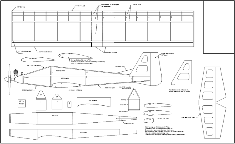

It's starting to come to me that it's the straight, angular forms that bother me. I don't like them. Too '80s or something.
They were driven by an attempt to ease construction with other builders in mind (here comes Sartre, again). That's all getting thrown out.
I'm going back with the concept I originally had in mind before I tried to cut the parts count.

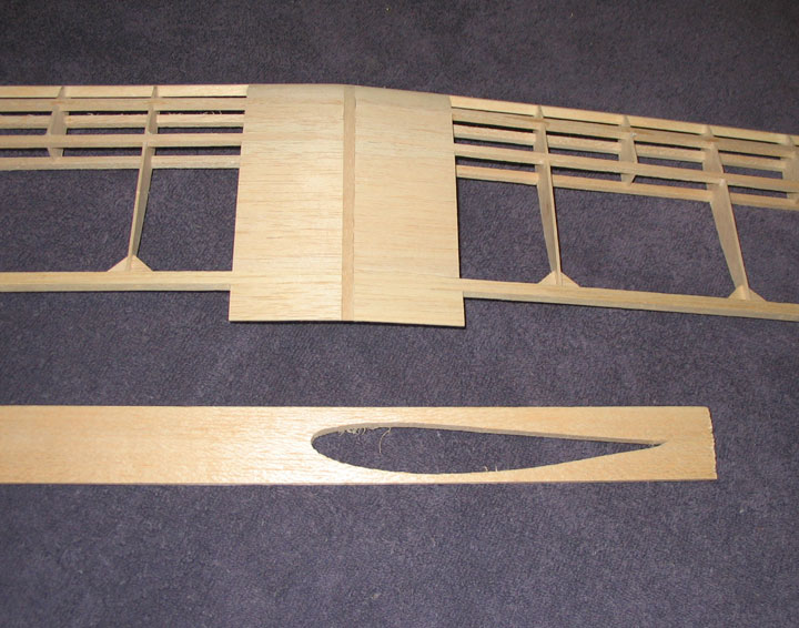

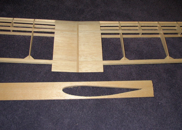

I don't remember what old timer plan I first saw this on, but I use the trailing edge stock method for joining wing halves with dihedral. The piece of TE stock I used gave 1" of dihedral under each tip; just what I was after.
It's a lot easier than trying to glue ribs in at an angle, or trying to sand a bevel on the root.

Dave-
What tool did you use to cut the root out of the TE stock? Telekinesis?
I dont see any burns, so was it a coping saw or are you just that good with a #11?

"What tool did you use to cut the root out of the TE stock? Telekinesis? "
I agree looks like the TE stock was poured into a mold! Nice work!
I may have figure out how it was done. First draw the outline of the root rib onto the TE stock ten cut it out of the stock and place between the 2 roots when done?
Robert

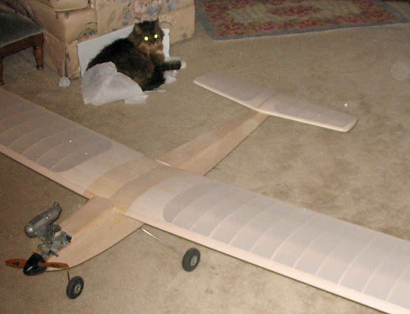

I have a cat with Gamma Ray eyes. I just move her head over the balsa. It works better than laser cutting. (I have a Craftsman scroll saw)

Wow, I see what you mean about that cat.
It completely vaporized the Fin & Rudder off thet plane!

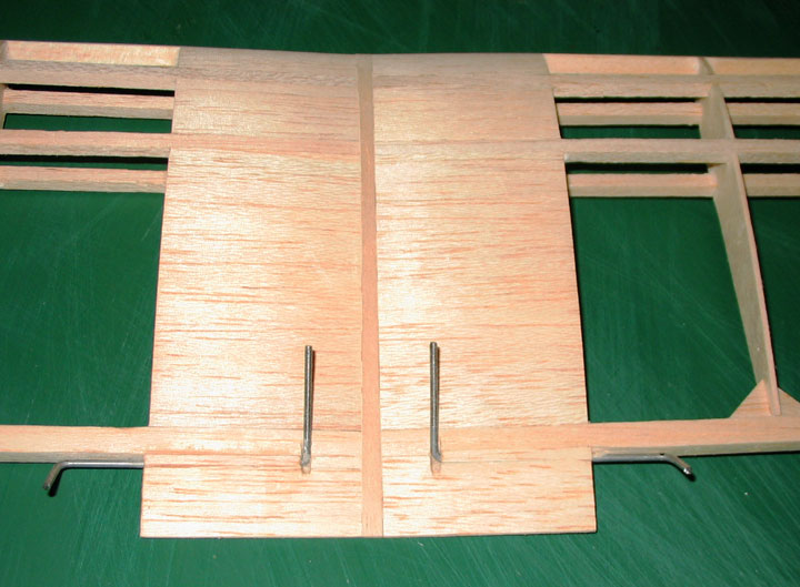

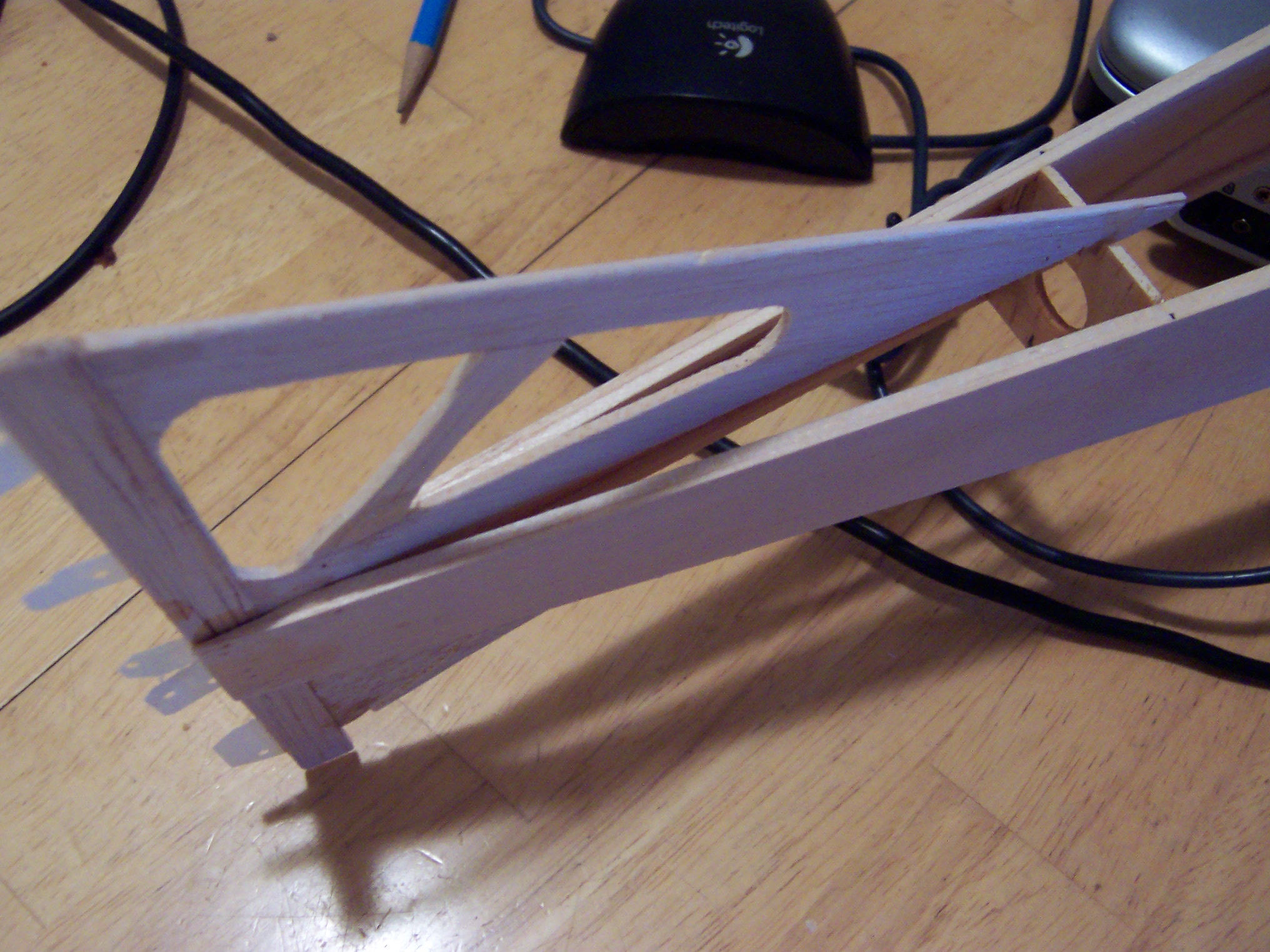

build light, exactly. I just held the root of the wing onto the TE stock, drew around it and cut it out. I glued the piece onto one wing half, sanded the TE stock flush with the wing and glued the other wing onto it. It's really hard to get the halves crooked that way.
I get bored doing things the same way, so for the last couple of planes I've started glueing the TE stock on before installing the torque rods. This way I can get the TE a lot straighter (I always seem to get it crooked when I cut the trough first and then glue it over top of the torque rods). It's not any more work to then cut a groove, drop in the rods and plug the groove with a strip of wood. In fact I get less play in the linkage. It works for me.
