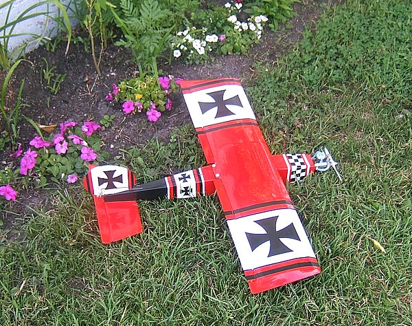

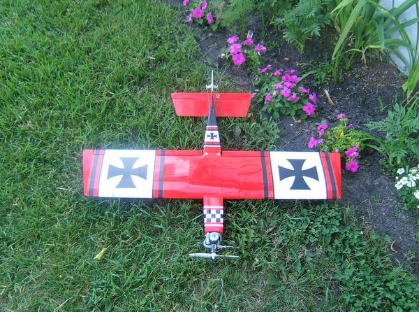

I vote The DNU...Nice to Build.. Aren`t you selling Kits, PT ?

The DNU kits can be found at www.selecthobbies.com along with many, many other nice 1/2a kits.
If Skaliwag is out, I can drop ship one. There's some in the pipeline.

What accessories are needed for the DNU kit?
Old 01-25-2007 | 08:21 PM
ptulmer's Avatar
Joined: Apr 2003
Posts: 4,867
From: Brunswick, GA
Default RE: Need a kit for an .061 engine
270mah nicd
1oz tank
CA hinges
1/2a control horns (one for elevator)
1/2a aileron kit (or 4 2-56 rods to custom make a set)
3x - 2-56 clevis
2x - HS-55 equivalents (3 with throttle, 4 with rudder)
Engine and mount. Since Skaliwags out for a while, I can put together a custom kit for you. The only thing I don't have on hand is a mount and tank.

What kind of covering comes with this? Is the wing a flat bottom? Symetrical? Semi?

Hey, not only do I want to know what covering comes with it, but I didn't get any Maltese crosses with mine either. What a gyp, man! [>:]

Errr... Covering? Eeeek! Wait a minute, I can toss in some doculam! You guys are on your own for the iron crosses. (Maltese crosses are different... I've got one of those on my arm) You guys are a rough crowd! The templates for the crosses are on the plans. Does that count?
The wing is the same as an Ace straight core, but cut down to a more appropriate span. Semi-symmetrical.
