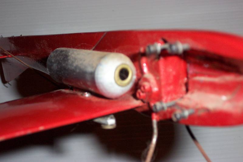

I built a 1/2A Proto back when the Cyclons first came out. I got the Cyclon from Doug Galbreath and it was a rear exhaust version (the only version there was then).
I ran Hazel's props because he had them in higher pitches than we ran in Combat. At that time the Proto record was 110MPH, or so, and I figured it was going to take at least 4" to 5" of pitch to be competitive. 4" @ 30,000 = 113MPH; 4" @ 35,000 = 132MPH and 5" @ 30,000 = 142MPH.
Since the timing is from a standing start you need to go a good deal faster top end to make up for the time used to accelerate.
I think my plane was (is) about 7 ounces. Were I to build another I would shoot for 4 to 5 ounces as I was not getting to speed nearly as quickly as the fastest dudes at the Nats that year. They were turning over a hundred and I was going about 90.
Here are some dusty shots of the plane. Toad, note how the mounts are notched for the Cyclon. I used a stiff, thick nacelle to make up for the rather thin mounts where I notched them.

I've never tried it before, so this is my first try, thank you for the pictures, it helps alot. I like what you did for the mounting, the thought of modifying my Cyclon case was causing me to lose sleep at night.

Cool Larry, thanks for sharing.
On Jim Bookers web site is a picture of how someone built a proto using a Profi which has a radial mount. There is always a way without having hack up the engine.
Looks like you used a bladder tank of some kind or was it straight pressure?

I probably should start over on my plane, larry's looks like it would kick mine into trainer status.

Toad, it had a canopy. Look at the first shot. There are some remains of a flat plastic canopy that was in a slot where a rudder usually lives. On this model I put the rudder on the bottom and the canopy on the top.
Graham, I used a bladder made of KT20 tubing and had it stowed in an aluminum cigar tube.
I just wiped off the dust and weighed the airframe and it is 5 ounces. For a really quick first lap, I think 5 ounces ought to include the engine. But at that weight the takeoff could be exciting dealing with the torque.
