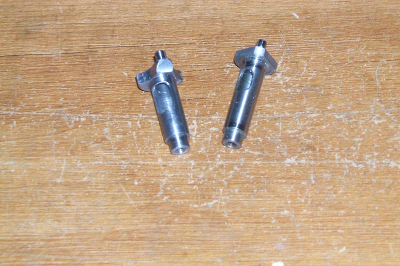

I decided I should get off my lazy fat butt and get to building my engine. It is going to be an .061 bushed to meet the pylon rules here.
I started and almost finished the crank today. This is the rough form, everything is a bit oversize so I can polish and fit after heat treat and grind.
Some details, The journal is .3125 dia with the passage bore at .228, the pin is .137 dia. the counter balance is way thicker than the std Norvel crank and the over all length is shorter than the Norvel. Timing on the widow is 36 deg after BDC and 64deg after TDC the window is .375 long, The edges of the window were left with a .015 flat as per common practice on high reving speed engines (not sharp)
the crank on the right is a Norvel crank for comparison.

ORIGINAL: Toad
Any idea what the AP crank is made of? Good quality steel? Hardened? Would it respond to being hardened and tempered? I know the Norvel cranks are pretty tough. I usually temper Cox cranks before I build an engine but I was wondering if the Norvel cranks would be better off if they too where tempered in the same way.

The Sharp edge thing, I go with the flat so I dont worry about cracking, I have found no rpm difference, but that is relative anyway.
The steel on this one is 8620 (oil quench) Very easy to machine in annealed state
I made another out of S7 steel. air hardening. I heard good results of it, The stuff is difficult to machine though in the annealed state.
As far as the material on the AP crank, I have no idea, THe norvel's measure 57-60 crc so I know their stuff is good. I never tempered them softer. (cant go harder)
I have no clue what material the norvel is either.
Having fun

ORIGINAL: Toad
Having fun

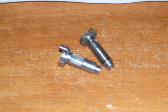

I did that relief on a precision tool grinder called an "Ewag"
It is an exspensive machine (swiss) that is used to make carbide cutters, reamers, custom cutting tools. I bought a wheeel for it to cut high speed tools. I use that wheel to grind the cranks. The machine is at work, Wish I could afford one for the garage lol (about $150k)
I first tried cutting the Norvel cranks with carbide, didnt even touch it
Any thing that will remove the material is ok, the main thing is to not go below .220 in dia and DO NOT get the steel hot! If any part of the crank turns straw colored or blue while cutting, you can bet Rog's last dollar, that the crank will break in flight. (loss of temper/hardness of the crank, the metal turning colors means you are too late)
This mod to the engine will give an incredible increase in rpm all by it's self. If I were to use a cut off wheel in a dremel, I would chuck the crank in a drill press, lathe, or cordless drill, low rpm, and use alot of water and take your time so you dont heat it up.
The idea is weight removal and surface area relief for friction in the case. Make sure you leave about .150 at the front for bearing and make sure you dont relieve too much towards the opening for the carb, I mark the crank while in the case, through the ventrui, I draw a line on the crank where the front edge of the venturi window is. Take out the crank and stay .020 or so in front of your mark so you dont open the relief into the venturi passage.

Did the increase in rpm come from the reduction of bearing area or from reduced weight (or a bit of both) ?
I was reading some old issues of Speed Times (the newsletter of the North American Speed Society control line stuff) and there was a note in one of the motor modification articles that you should demagnetize your crankshaft after you have finished working it over. Makes sense, any magnet in motion will induce a current in any nearby metal which in turn is power and in this case would be lost power as the rotating crank would have to overcome any back emf. A simple tape deck demagnetizer like those sold at Radio Shack should work.
I wonder how much difference it would actually make. It is one my list of things to try, magnetize a crank and then run a motor for a baseline, then demagnetize and run again within a half hour or so such that conditions dont't change much; and compar the results.

Well, by what Wayne Trivan did, he was a big advocate of turning less mass, check out his prop balancer, I did the same mods and wow that works, so I figgure the same principle works on any rotating part, less mass means less power to keep it spinning, more mass would help in the tourque game though. For my purposes, I like the rpm game, and the light crank by itself paid me back bigtime. In the norvel, I think it is a 50-50 deal between mass and friction relief.
