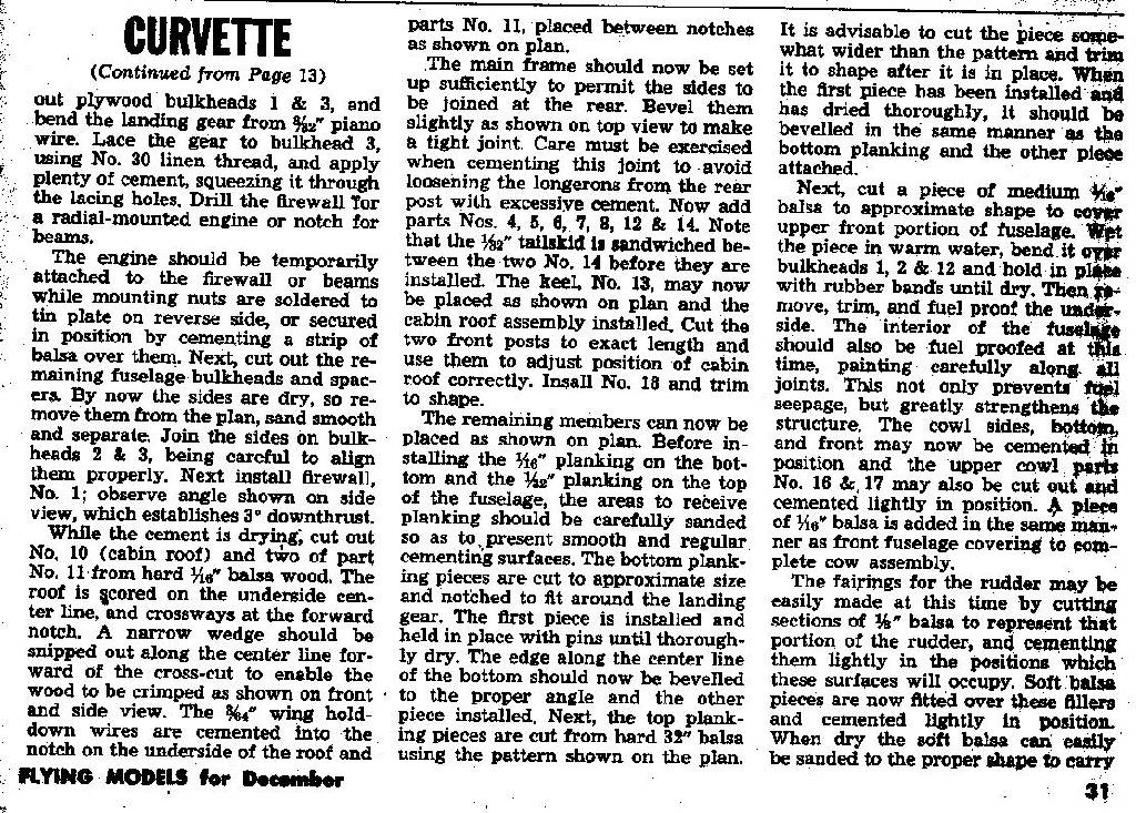

It's been 50 years this month since this was published; an interesting Laumer article on home made retracts.

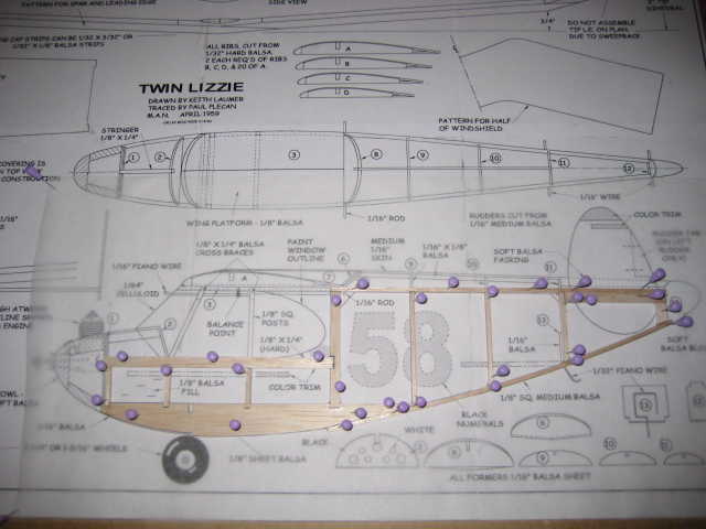

I'm starting to build a Twin Lizzie. Is this thread dead ?
Old 02-09-2011 | 08:21 AM
  #245
Joined: Feb 2003
Posts: 3,215
From: Murray, KY
Default RE: Keith Laumer
Not if you'll post some pics and build comments. The Twin Lizzie is a classic little plane.
andrew
Old 02-10-2011 | 01:19 AM
  #246
Joined: Sep 2007
Posts: 266
OK then, but my Twin Lizzie is gonna be free flight. I have a brand new Pee Wee 0.020.
I've downloaded the tiled plan and glued together the pages.
I've cut out some parts drawn on the plan and glued them onto cardboard.
I am now in the process of cutting out the balsa parts.
This is going to be a slow build.
Paul

Old 02-15-2011 | 02:52 AM
  #247
Joined: Sep 2007
Posts: 266
I am now building the fuselage sides.

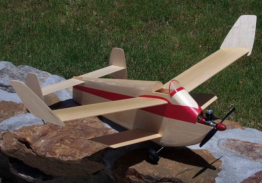

A Little Red Twin I built a few years ago. Yes, it is a FF. Tough little plane and the cute factor is high as on all of Laumer's designs.
Old 02-15-2011 | 05:42 AM
  #249
Joined: Sep 2007
Posts: 266
Cute, really nice, well built. [8D]
Does it fly well ? Doesit requirea lot of space to fly ?(It's my first FF plane).
Old 02-15-2011 | 04:42 PM
  #250
Joined: Oct 2004
Posts: 207
From: Little Rock, AR
The Little Red Twin flys okay. It is not a slow flying plane. Build it light and warp free. Limit your engine run.
