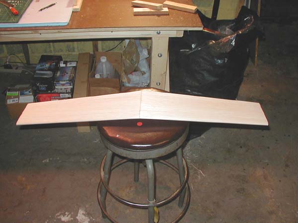

I won't give up on the pro-bond, if nothing else, I can use it with my SPAD's, those SPAD guys love that stuff. If you run over the Coroplast with one of those "wood peckers" and punch a million tiny holes in the coro and then use the probond, the foam goes up in the little holes and makes an unbelievably strong bond.
I am really happy with the Super 77, the key is letting it set up for about 5 or 6 minutes before putting it down. It has worked great for me and now that all of the big sheet pieces are on the wing the curves are true and everything is sticking well.
Guys, I love foam wings, I do, and these 1/32 sheeted ones are just so great. The amount of work that it cuts off of building is immence and I really thing that they are as light, if not lighter than the built up ones. These ones that I am working on now came out about half as heavy as the first set I made. A lot of that has to do with the foam itself being lighter, but I think that I haven't gobbed epoxy all over them also has something to do with it.
All I have left is to glue the cap strips, and the wing tip pieces, both of which I am going to use epoxy for, then I'll sand it all up. glues then in the center and be donew with it. I'm not going to put a leading egde on these, it might be a mistake in the long run, but it just looks so good now that I don't want to mess it up.
More pics will follow...

I have been using ProBond for sheeting now for a while, and here is my technique. Most recently, I used it on the Caliente wings, the Caudron, and the new SuperCaliente wings.
Prep the sheeting and cores like you would with any method. Lay out the skins and run a bead of glue down the middle and around the edges. I then use a .010 mylar scraper/spreader to spread the glue around. Make sure that the skins are thoroughly coated with the glue and then scrape all of it off with the scraper. When you have finished, place the skins in the husks with the cores and weight them down overnight and through the next day.
When you pull them from the husks, the wing should be completely glued. It does not seem to hurt to lay the bare wings (minus husks) on a flat surface for another day to allow them to cure fully.
Some other things I picked up along the way-
Whatever you do, don't spray any water on the skins or cores to aid in adhesion. There is enough moisture in the air and the skins as they are to help the glue along. Adding moisture just results in overfoamed glue and recurrent warps... (don't ask me how I know)
If you use thin skins, especially skins made from 1/32" contest balsa, you may want to put waxed paper on the husks before you put the skins and cores in place. This will prevent you from having to cut the husks off the finished wings.. (again, don't ask me how I know...)
Cut your skins oversized and sand the edges back to the core with a razor plane and t-bar sander. Any glue overrun should be easy to sand off.
You can use ProBond if you intend to do skin hinges. It does hold up.
BTW, the Caliente wing is 3/8" thick at the root and sheeted with 1/32" balsa. It was internally reinforced with glass cloth. I used the method above to skin the wings. During the autopsy after the crash, I found that the wing actually only broke in one place that was 12 inches out from the center section on the right wing. The center section was not touched, and the skins are all still fully bonded to the foam throughout.........
One other thought- I just found out that 3m has changed their formulation of 77 spray. The new formulation apparently contains acetone which will melt foam core wings. If you have a can of the good old stuff, use it sparingly. They do have a non-acetone formula available, but I have not heard of anyone using it.

The good news it that 3M makes another spray adhesive called 78 which is specifically designed for insulation foam, which wings are usually cut from.
http://www.3m.com/reclosables/html/insulation78.jhtml
3M 78 also has an equal or higher peel strength and temperature resistance than 77.
http://www.3m.com/reclosables/pdf/Ae...rodSummary.pdf

You're not kidding on that, I am dreading finishing this plane because then I'm gonna have to cover it
When you had that "Name That Plane Contest" one of my names was the Lightning Bug and I liked it a lot, when the "Lets have a Design Contest" came up I knew that I had to keep it.
M/Aero - thanks so much for the help with the probond. I am making quite a stink about these foam wings lately. It's just that I have a few old kit's that have them and it is important to me that I don't mess 'em up. I got the Simple Mustang to practice and as that was happening this contest started and in getting the special cut foam cores for this I got one of Bipe Flyers Firefly.
Now in addition to not wanting to screw up my original Hobby Shack 1/2a Super Sport Trainer or my real Ace R/C Upstart, I want to do a nice photo essay for the Firefly.
I am really happy with how the wings came out, that "D" tube method works really good. Here is a shot of the top,
