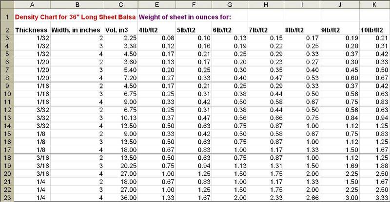

Old 02-29-2008 | 04:20 PM
Posts: 1,293
From: Crystal, MN
Default RE: Balsa Weights
Here is one I cobbled up on my lunch hour.
Now, will someone check my math?
Could be helpful for picking sheets at the LHS.
You will need a good scale though!
Dave
Show your work for extra credit:
There's 1728 cubic inches per foot, 1 lb/cu foot = .00926 oz/cubic inch.
And now I see I listed it as pounds per foot SQUARED instead of CUBED, DOH!
The numbers are still valid though, just a little off on the description.
I KNEW I'd regret posting this.

Old 02-29-2008 | 11:03 PM
BMatthews's Avatar
Posts: 12,432
Received 28 Likes on 24 Posts
From: Chilliwack, BC, CANADA
Some fast and dirty calculator work on the 1/32 x 2 shows it to be good. I guess we can trust you and your 'puter....
OK, now give us a version where the oz are converted to grams, smartypants....
(meanwhile Bruce rushes to print the chart and get it ready for laminating into a wallet card....)

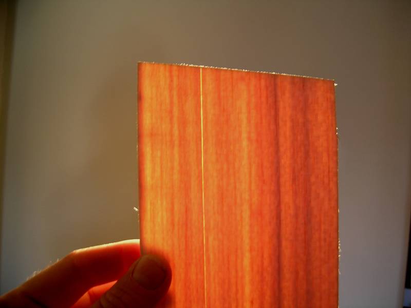

balsaworks's Avatar
Joined: Dec 2004
Posts: 157
From: Stockholm, SWEDEN
ORIGINAL: Remby
Weigh everything now, never used to. Really helps keep the weight down, no question.
True words.
A good scale is indispensable if you want to grade your balsa, and build stronger, lighter planes. Nowadays there are incredibly cheap and accurate electronic scales that will weigh fractions of grams.
It pays off to play with the balsa bits in your hands, and bend them in various directions to get a feel for the stiffness. It’s easy to compare the stiffness of sticks and sheets of same size by bending in your hands. Sheet stiffness can be measured by holding the sheet on end on a scale and pushing down until the sheet buckles. Once it buckles the reading will be more or less constant and it will give an indication of the stiffness of that sheet.
The density of balsa can vary wildly not just between trees, but also within a block, or a sheet.
A strong lamp is helpful to check for hard and soft streaks in balsa sheets.
The photo below shows a 1/16th sheet with a calculated density of 7 lb/cu.ft. The more translucent areas are probably 5-6 lb, and the darkest streaks on the right side could well be over 12 lb.
It´s entirely possible to take an 8 lb, 1/8” x 4” x 36” sheet , slice up 30 sticks, and get sticks that vary from 6 lb to 12 lb with not a single one at 8 lb.

Old 03-02-2008 | 02:58 AM
Joined: Jul 2005
Posts: 1,605
From: Upper HuttWellington, NEW ZEALAND
Think about it folks-it would be not just odd-but downright suspicious if a sheet of wood stripped DID give strips all the same density. Remember that sheet came from a block, and was cut either tangentially, radially or at an angle through the annual growth rings. For the density to be identical through the sheet, the growth rate would have to be constant regardless of the year, the time of year,the actual weather and season, and regardless of the orientation of the tree. That's not just a big ask-that's a biological impossibility!
'ffkiwi' (wearing his scientist's hat!)
