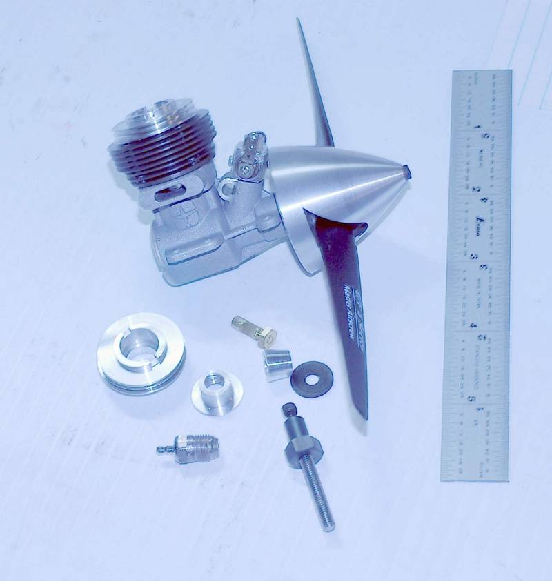

Second picture is a Norvel V7 converted for airplane use. Required making a brass cotter to hold the CS 061 throttle in place, split tapered collect and prop stud and nut to take an MP Jet 40mm aluminum spinner plus a turbo plug button and a modified standard Norvel 074 head. The picture shows all the little bits and pieces I made up for the conversion.
On the same 10% fuel noted above, an OS P3 turbo plug and Graupner 7x3 nylon prop - 16000 with a 6000 idle. This is after about 6 ounces of fuel. Two things I did notice, the fuel nipple of the CS 061 carb does not hold the fuel line very well and was prone to coming off and the engine runs with a bit of a wet nose. Now, the wet nose observation may simply be the fuel nipple leaking and I mis interpreted what I observed.

Just a note on the CS carb. I found a fule line a TowerH which is 2x4 mm (if I remeber correctly) and that had a very nice fit. Also an airbleed screw can be fitted but it is a bit tight. Just drilling a small whole though will help with the low end.
On a converted TT07 I've tried OS#P3 and P7, I found the P7 a bit trickier to start on (colder) but it ran nicely once running. Can't decide which one to use yet...

As for the V7 I am working on a similar project-but for F/F rather than R/C so I will be trying to see how big a bore venturi I can get away with, and simply use a smaller spinner on the 4mm prop shaft a la Cox. I'll make up something similar to a Cox Conquest venturi for it ultimately-after I've tried a few different diameters out. I have a turbo 074 head from Ronald Valentine plus a std plug adapter from Mecoa, so a lot of plug experimentation is on the cards. The V7 seems to be fitted quite well, and not as tight as some of the Revlite AMEs-and sports a bushed main bearing as well. I was a bit chary of the clutch plate housing but it seems to hold OK and with the front face knurled should make an acceptable- if not very elegant- prop driver. I think it will be quite potent on a Master 7x3 or APC 6.6x2.9!

I have two more of these V7 engines and will be making one up for control line use. I will probably use the prop driver from the AP15 as the back end diameter is the same diameter of the V7's crankcase's nose (for lack of a better descriptive name). All I will need to do is make a split collet to fit the crank and the ap15 prop driver. Incidentally there is about 5 to 10 thousands clearance between the crankcase and the back side of my split collect that mounts the spinner (ie the crank move about .005 to .010 in and out with the split collet, spinner back plate, prop and the rest of the spinner are mounted ). I used a phenolic washer from my stash of TD 049 parts as a washer between the split collet and crankcase front end so that I could if need be use a starter without worrying about wearing away the front of the crankcase. Haven't needed to use a starter yet so far 2 to 3 flip starts. I can see where you could use the clutch plate bit as a prop driver but as you say - not very elegant. Yes, it has the makings of a potent motor for FF use.
