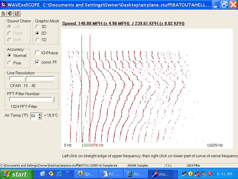

What is interesting about the speed is we're [lackadaisically [sm=redface.gif]] assuming that the airframe is allowing 100% efficiency out of the prop. What I need to do is look at the Wavoscope again and plot the rpm doing it that way.
I had to change the glow plug after that flight, what you see in the film is the engine running like a model diesel after the element is gone.
MJD, I look at 2 consecutive waves and jot down the coming and going freqs, then take the difference and the average of the 2.
Looking at the 2nd pass just now and it looks better than the first. Last time I had it out it was only doing 115-120...most likely it could have been different fuel.
