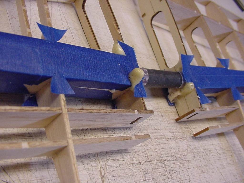

Some pictures of finishing the stab skins, cleaning up the socket installation and gluing the bottom skin to one panel. When sheeting with the jigs it's best to use a piece of poster board between the skin and jig, this will help reduce any denting of the skin during the pressing of the skin/frame assembly. Also use a sheet of plastic between the jig and frame otherwise the two could be glued together. After about 4 hours for the glue to set the second panel will be pressed using the same jigs.
Dave Snow
