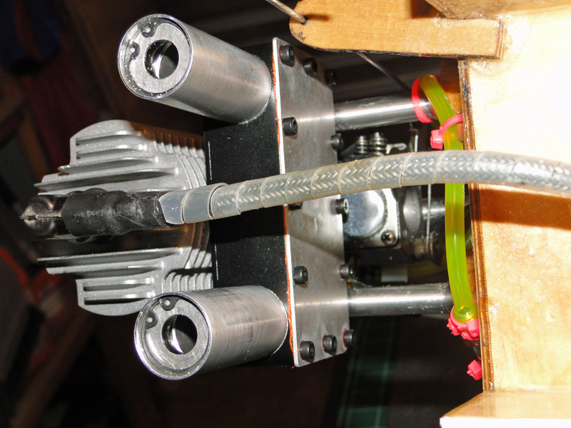

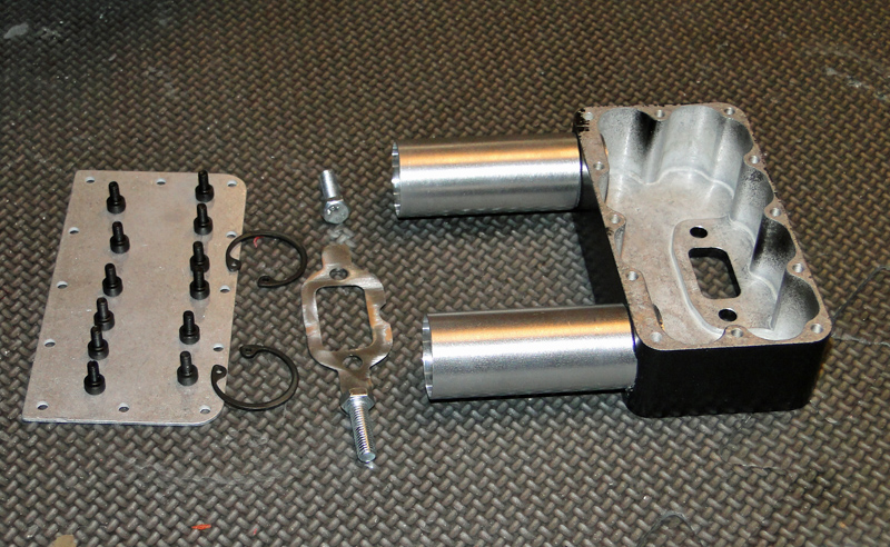

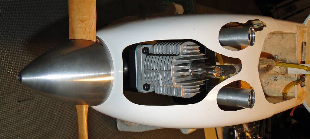

Hi Guys,
I just put the New Style CNC muffler on my Syssa, and I took a few photos. I knew you guys in this Syssa thread would want to see it up close. Liked the hex-head bolts. Didn't like that there were no Nord-Locks with it. I used Ultra Copper sealant for the seal between the engine and the muffler, and the Permatex Hi-Temp LockTite # 27200 (I think) for the bolts. Cleaned the threads out with a 10-32 tap, Acetone, and then spray alcohol to make sure there was no grease left in them. There are a TON of those little bolts for the back plate. Hard to get to some of them, I was tempted more than once to remove the engine to install this. Do I think it's going to work well?
Yes.
I'll let you know!
~ Jim ~ [8D]
