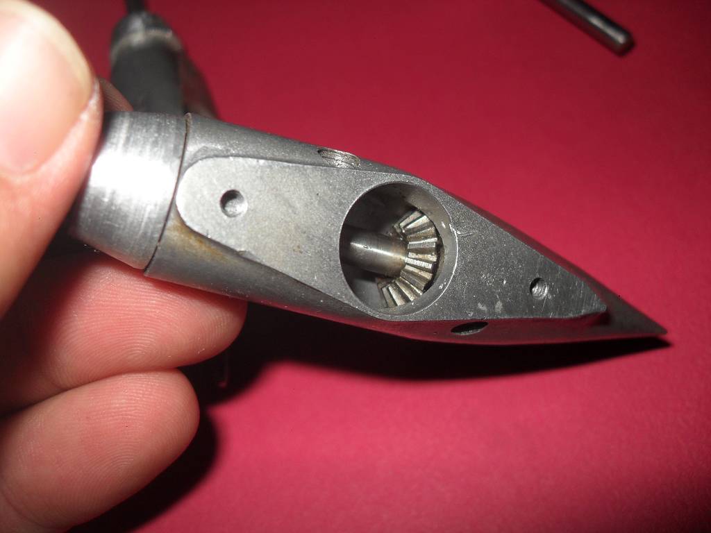

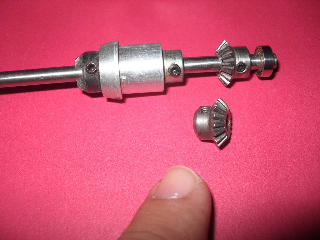

I was unable to save the gelcoat on the hull deck so I regelcoated it after alot of sanding it turned out great a little buffing and i'll be done with the hull till painting the colors and stripes. The bad news is the pair of amps outdrives I bought got lost in the mail, so back to square one if anyone sees any for sale please let me know. I need a pair. also can the rotation on them be changed or do I have to by them left and right.
Thanks Chris
you can take a outdrive and make it counter rotate . but you have to be careful taking them apart . the best way is to heat them up in the oven to break away the glue . DO NOT use plliers to pull it apart .. [:@] all you have to do is flip the gear the other way hope this helps
