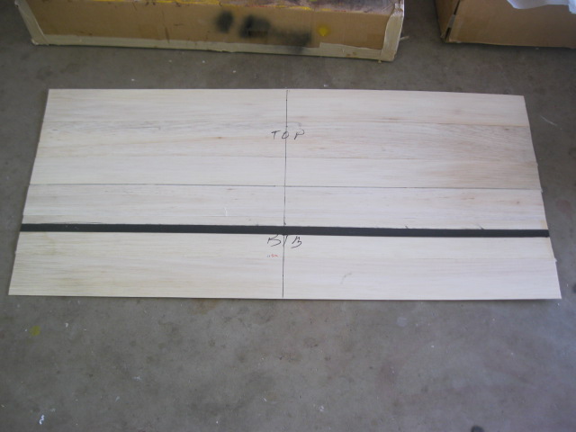

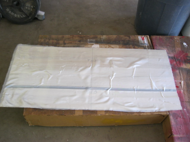

Here are pictures of getting ready for vacuum bagging:
I use a layer of 1.6 ounce glass inside the sheeting to provide strength and a thin trailing edge.
I piece of vertical carbon fiber sheer acts like a spar.
A 3/4" wide piece of 7 thousandths carbon fiber is located on the bottom of the wing between the cores and sheeting.
