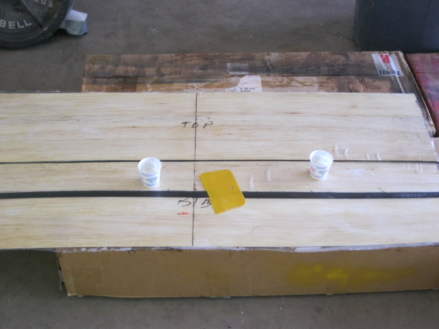

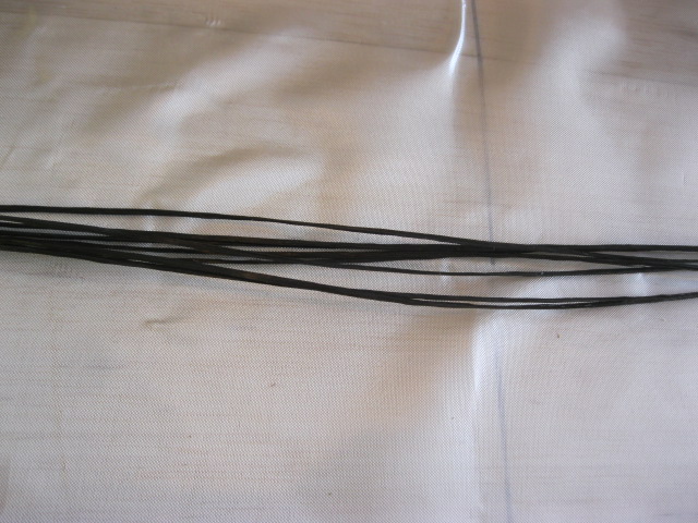

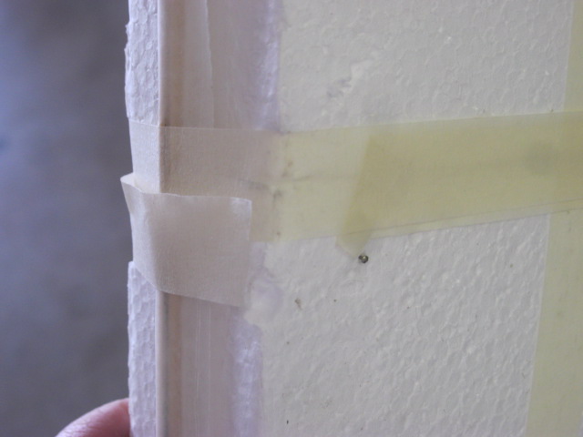

A carbon fiber leading edge is fabricated using several pieces of carbon fiber tow.
Finishing epoxy was applied to the carbon fiber tow and vertical sheer.
Approximately 1 ounce of finishing epoxy was then mixed a side of the wing. This was drizzled on and then spread with a plastic squeegee.
The other side was done the same way.
