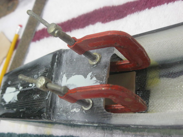

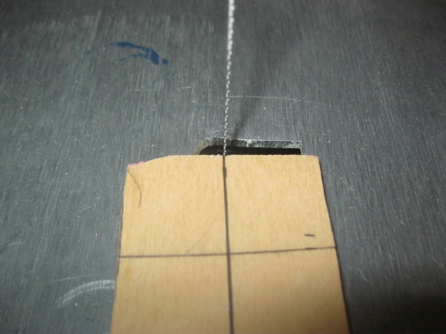

Earlier, some test holes were drilled to check the location of the wing dowel pieces. The holes are where the plywood pieces are glued.
The rear blocks and landing gear blocks were glued in place with medium CA.
The front blocks didn't attach flush to the provided 1/16" plywood plate and therefore were glued in place with Shoe Goo.
