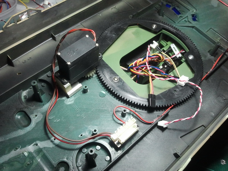

Modified Turret rotation with servo standard !!
It 's speed up
Open cover servo.
Cut stopper
Solder it out.
Remove VR center servo
Follow the picture.
Disassembly stock rotation gear.
slot center gear for servo shaft
install gear and lock on servo
Below on picture and Finnish
