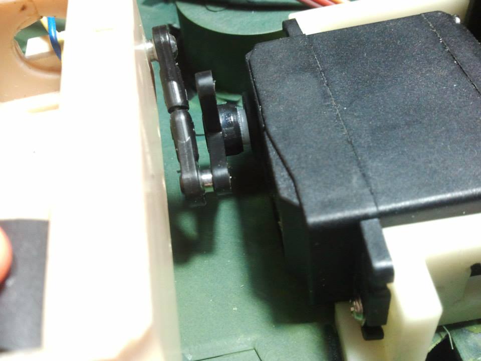

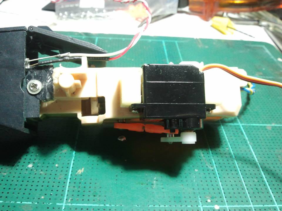

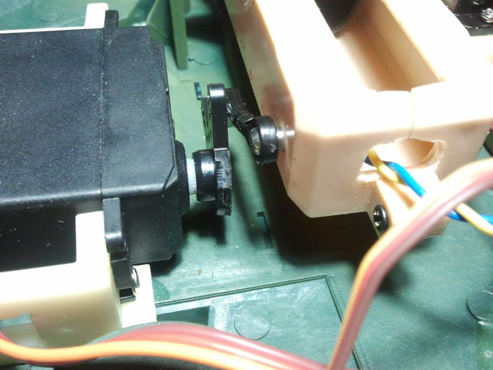

Hello commander!! this manual for modified gun recoil servo for Leopad2A6. It easy to work Let do it!
User the stock BB gun unit from Tank.
disassembled BB Gun unit follow this
Cut it.
Disassemble barrel and cut all rib to smooth.
Use scissors to make a hole so big and smooth.
Inserted into the barrel and make sure it does not jam.
Use Antenna from henglong cut about 60mm.
Use cylinder air gun from HL cut it and dill hole for antenna
Assemble the gun and then glued a stroke.
Install support servo ball link and link rod for helicopter follow the picture and finish.
This example gun servo elevator it Up and down to -5-+15 degree
Video
http://www.youtube.com/watch?v=3_yJDsopzF8
