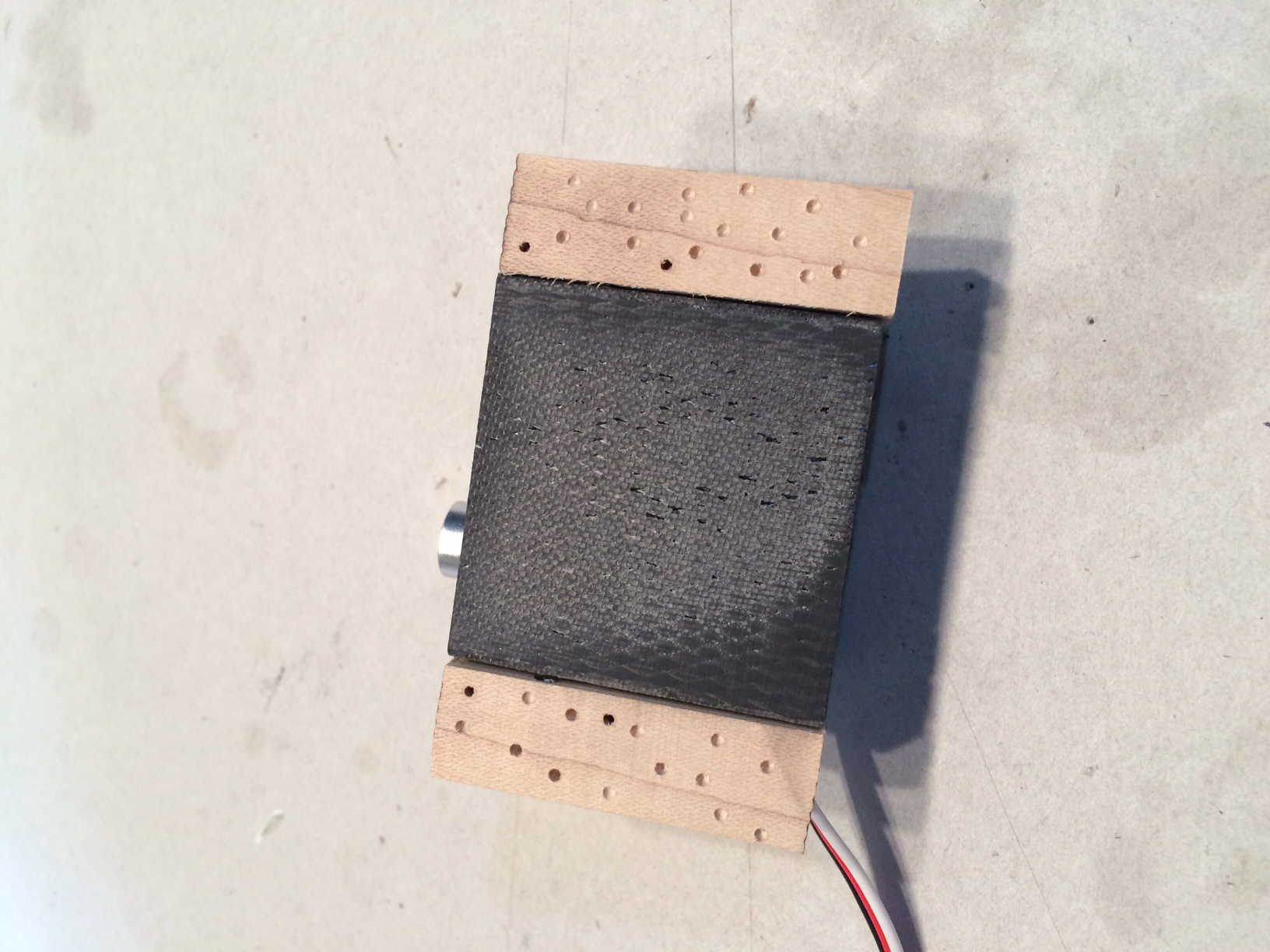

I've started with the stab and elevator while I await for some parts for the fuse.
Overall quality is excellent. Light, strong. Appears to be top shelf material and craftsmenship.
The rudder servo mount needs installed. It fits the Futaba HV BLS servo perfectly. It had a very light and neat way to mount it to the servo holder but I modified that to something more traditional by adding some maple blocks, 3mm x 30 mm bolts, and a ply strap. The servo arm is a 20 mm thin Futaba servo arm mounted on the second arm out for max ATV/throw. I did have to open up some of the vertical former to allow for the servo arm.
I also added a dowel in the main rudder alu tube for long term durability. Next, I added 4 ply corners and button head screws to attach servo covers vs tape.
Finally, to connect the rudder servo at the fuse junction I had to dremel a small hole in the vertical former that supports the main alu tube to pass the servo extension wire up into the round hole at the base of the rudder. This is not shown, unable to get a picture.
