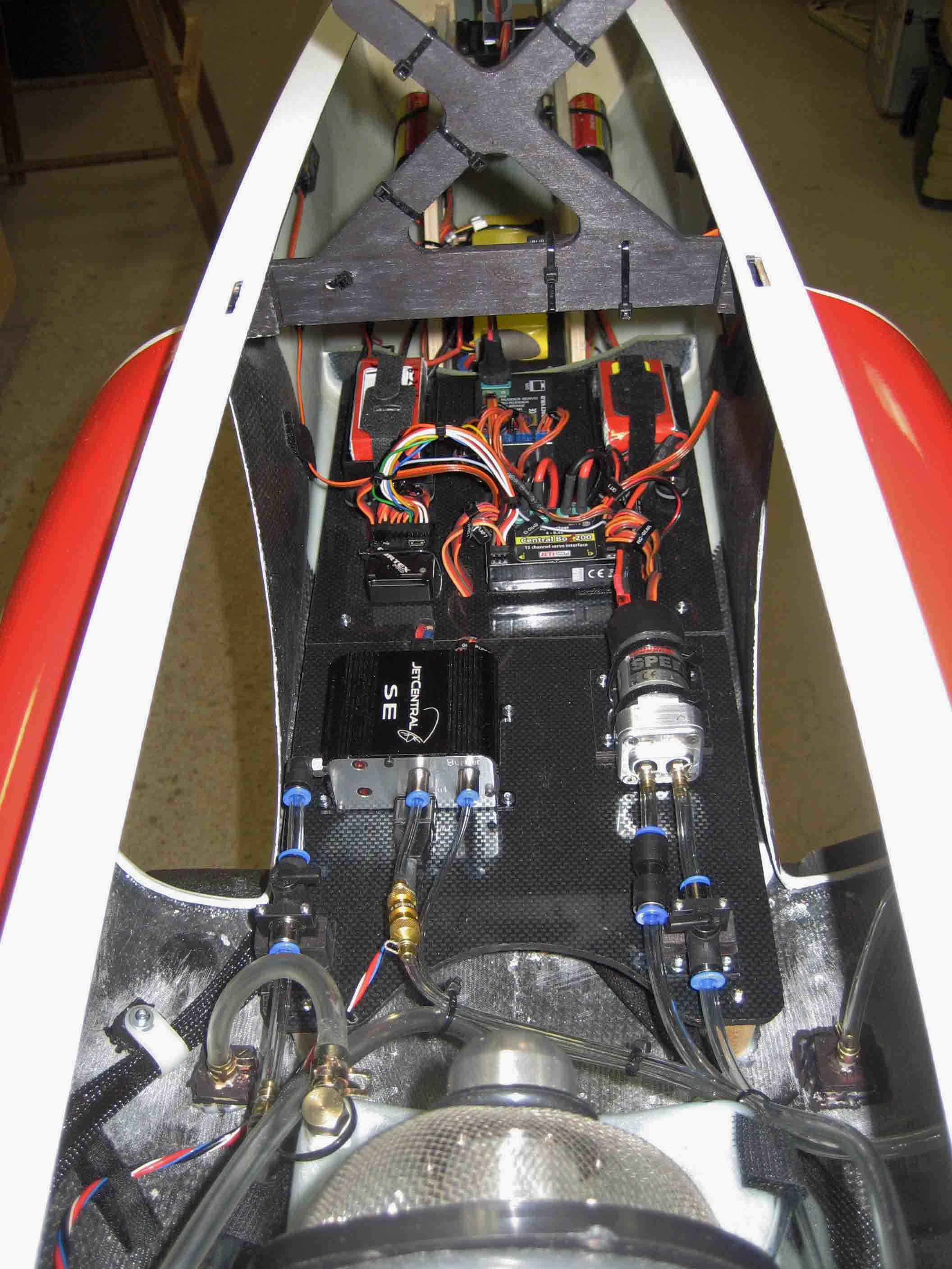

Old 04-30-2017 | 01:05 AM
  #80
Ragz's Avatar
Posts: 2,629
Received 7 Likes on 4 Posts
From: Nagpur, INDIA
Is this model completely made up of CF? I can see most of the pics here have a carbon fin and lots of carbon on the body and wings.. whats the deal?
I can't speak for the "standard" Natrix but I ordered mine with the carbon fiber upgrade and it has lots of carbon fiber from near the front of the canopy opening all the way back. The vertical fin is also all carbon. I made sure to put my antennas forward and above the carbon areas. These pics show a little of what I'm talking about.
