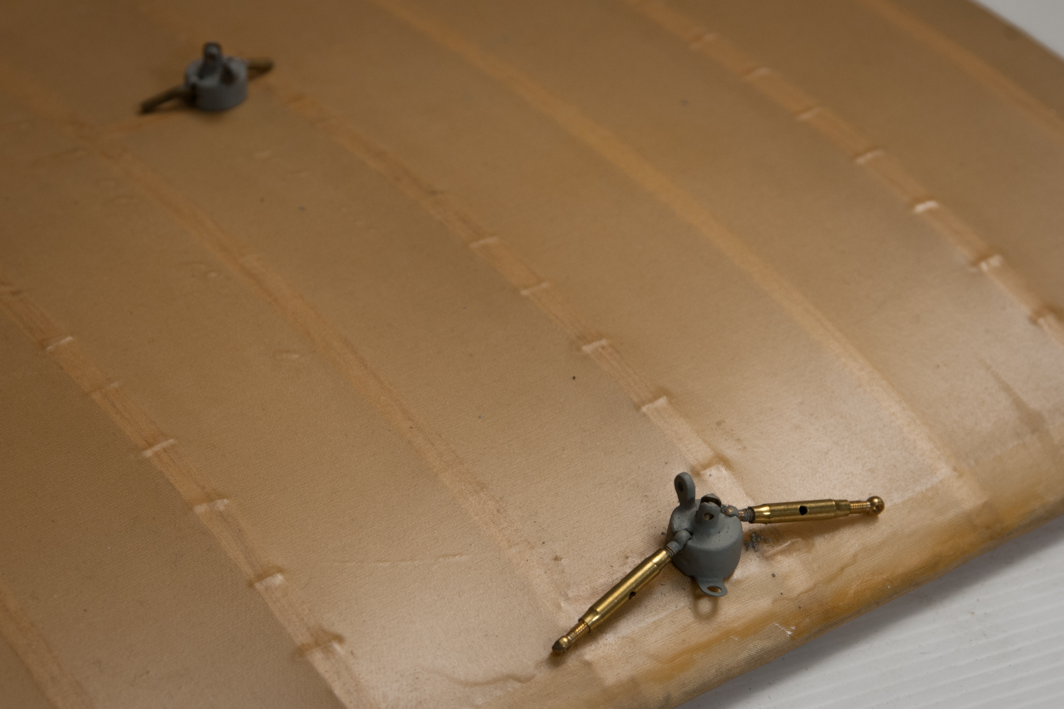

Here's what I'm working with. I've got very scale attachment points for the flying wires (using turnbuckles) and very scale attachment points for the struts and that outboard rigging. The attachment point on the cabane is more practical and offers more possibilities. I did find one problem with it however. With the top wing panels in place, the wires wouldn't clear the root ribs, unless I attach the left wire to the right hole (and vice versa). That wouldn't be too bad.
