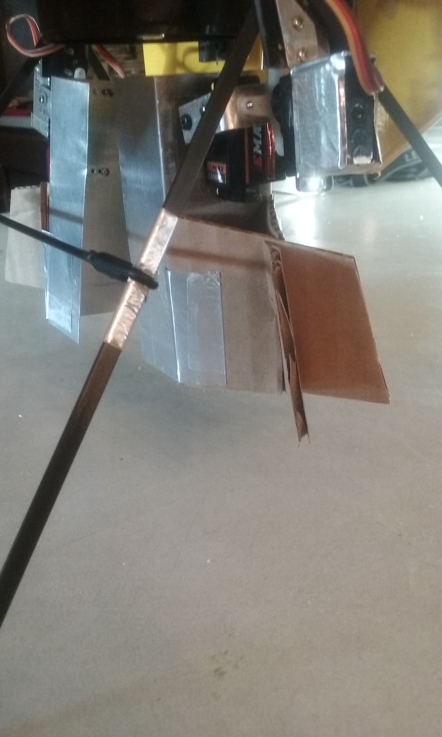

At this point, where I am dealing with all kinds of problems from servo alignment to resonance, I am judging myself for trying to achieve this hard task one more time.
As opposed to 1 design which I was able to successfully take to horizontal flight and back, I had 5 or 6 different designs that were not successful. And I may be on the route to another failure with this one. Well, at least I made a humanoid fly vertically and can live with not being able to convert into a flying jet…

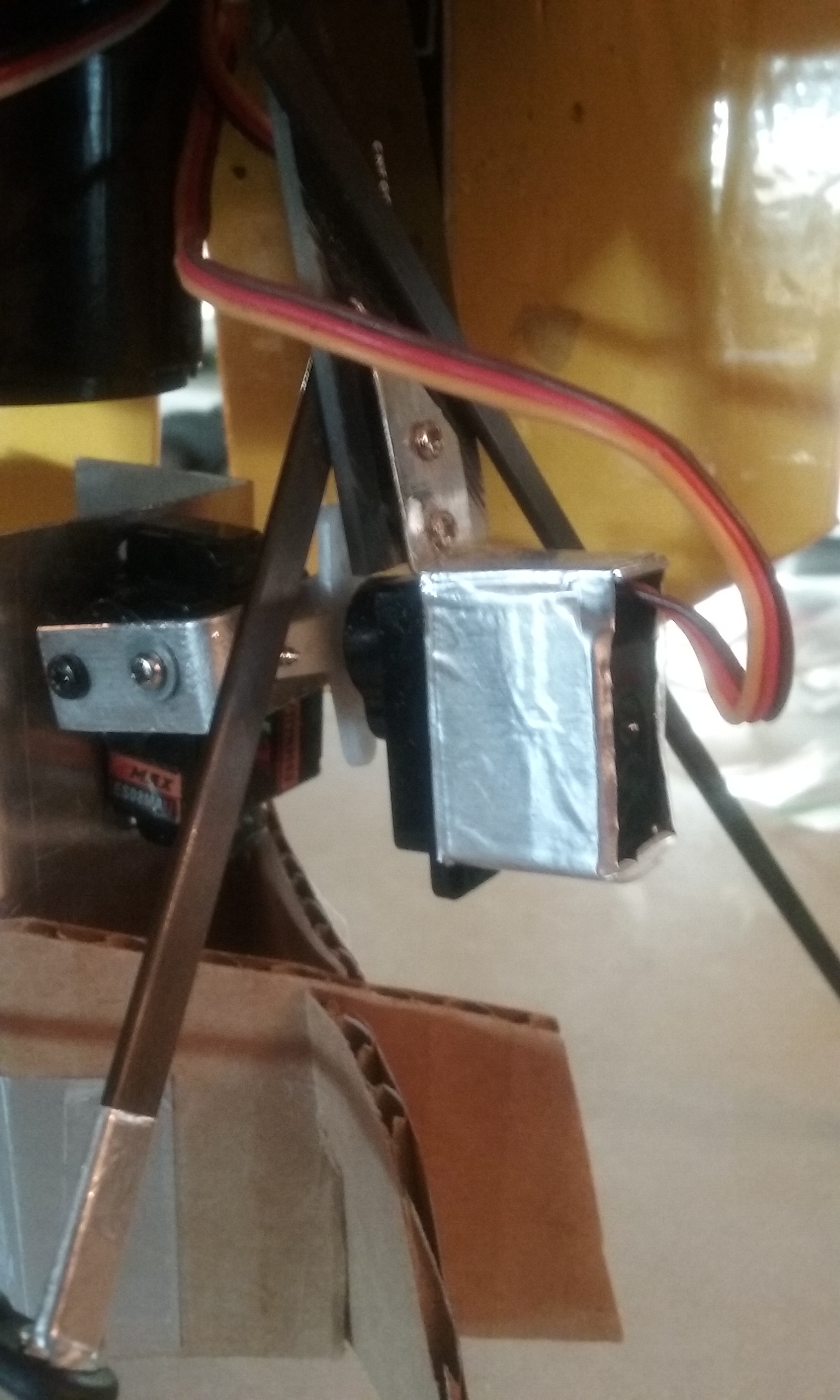

I am learning a lot with this though. For example, the design didn’t like me to make the servo connections sturdier and whole structure was caught in a resonance shake in the air. So, a flexible aluminum sheet bracket is holding the servos, which got rid of that.
I tested many designs for the rudder/elevator and came up with the correct design which doesn’t disturb the horizontal flight. I also changed the canopy to a smaller version that I really liked… Pics attached.
One problem that I don’t have a solution for yet is that while transitioning, the yaw response is horrible. The unit is barely responding to full stick input. I had this problem with my first unit that I kicked the project off with, which utilized a similar thrust vectoring design. I believe the response will start coming back when it gets closer to horizontal, but then I need to keep the unit straight until I get the yaw response back. Will it still be in sight???
I also need to raise the center of lateral resistance, based on the response that I am getting from the unit…
Very tough project. Hope I don’t end up collecting debris from the field one more time.
