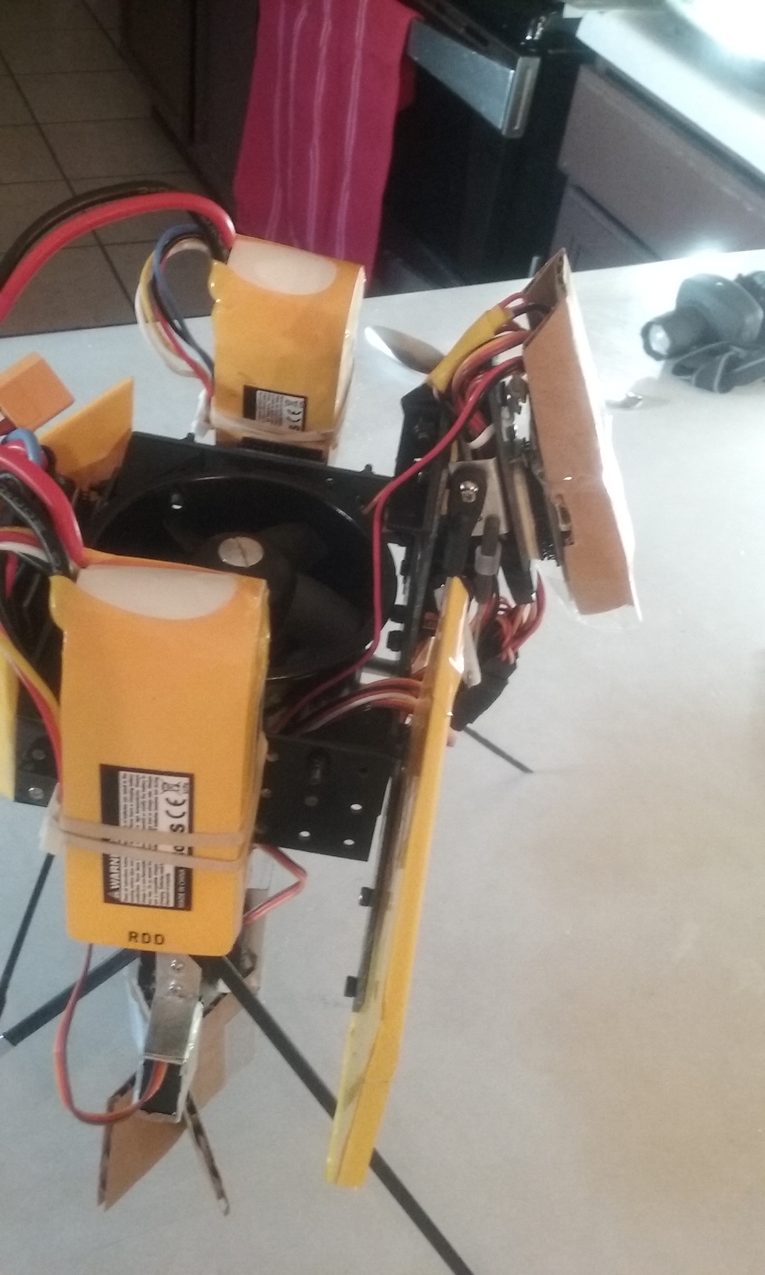

Installed the new metal gear servos. They work great. They warm up a little too much but I need to keep the volts up to feed these 5 servos in continuous action.
Installed the first wings to test, which I already had waiting in my junkyard. I am a little concerned with the wing area being small but I will keep the attack angle a little high and see if that compensates. If not, I will need to change the landing gear design and install larger wings.

I broke my rule and tried multiple things together. Servo change along with aerodynamic changes. As a result, it took me a while to pinpoint the problems. Finally, figured it out and had a good flight.
The fact is that the elevator/rudder combination on the legs didn’t sit well. Because of the nozzle design, they got into the airflow and disturbed smooth operation or the nozzles. Also, the servos turned out to be more responsive than the old ones, which caused me having to operate with the lowest P value in the history of Monos.
Now, since I need the elevators and the rudders in horizontal flight, I will need to come up with a solution which will not disturb vertical flight.

This is the first flight that I tested the transformation in the air. 25-30% into the transition, the unit started to lose balance. I think the reason is the lack of tail input. So, I had to find a better design for the tail wings, which will not disturb the horizontal flight by disturbing the nozzle air flow.
I put the pictures of the new design below.
My other observation was that the unit speeds up very quickly during transition. So, I hoping to be able to control it at a distance that I can see it, when the aerodynamics are suitable for the transition.

At this point, where I am dealing with all kinds of problems from servo alignment to resonance, I am judging myself for trying to achieve this hard task one more time.
As opposed to 1 design which I was able to successfully take to horizontal flight and back, I had 5 or 6 different designs that were not successful. And I may be on the route to another failure with this one. Well, at least I made a humanoid fly vertically and can live with not being able to convert into a flying jet…
I am learning a lot with this though. For example, the design didn’t like me to make the servo connections sturdier and whole structure was caught in a resonance shake in the air. So, a flexible aluminum sheet bracket is holding the servos, which got rid of that.
I tested many designs for the rudder/elevator and came up with the correct design which doesn’t disturb the horizontal flight. I also changed the canopy to a smaller version that I really liked… Pics attached.
One problem that I don’t have a solution for yet is that while transitioning, the yaw response is horrible. The unit is barely responding to full stick input. I had this problem with my first unit that I kicked the project off with, which utilized a similar thrust vectoring design. I believe the response will start coming back when it gets closer to horizontal, but then I need to keep the unit straight until I get the yaw response back. Will it still be in sight???
I also need to raise the center of lateral resistance, based on the response that I am getting from the unit…
