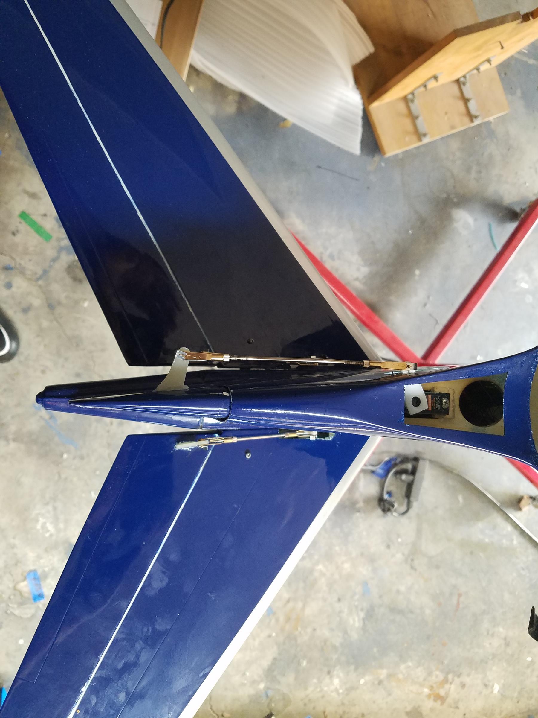

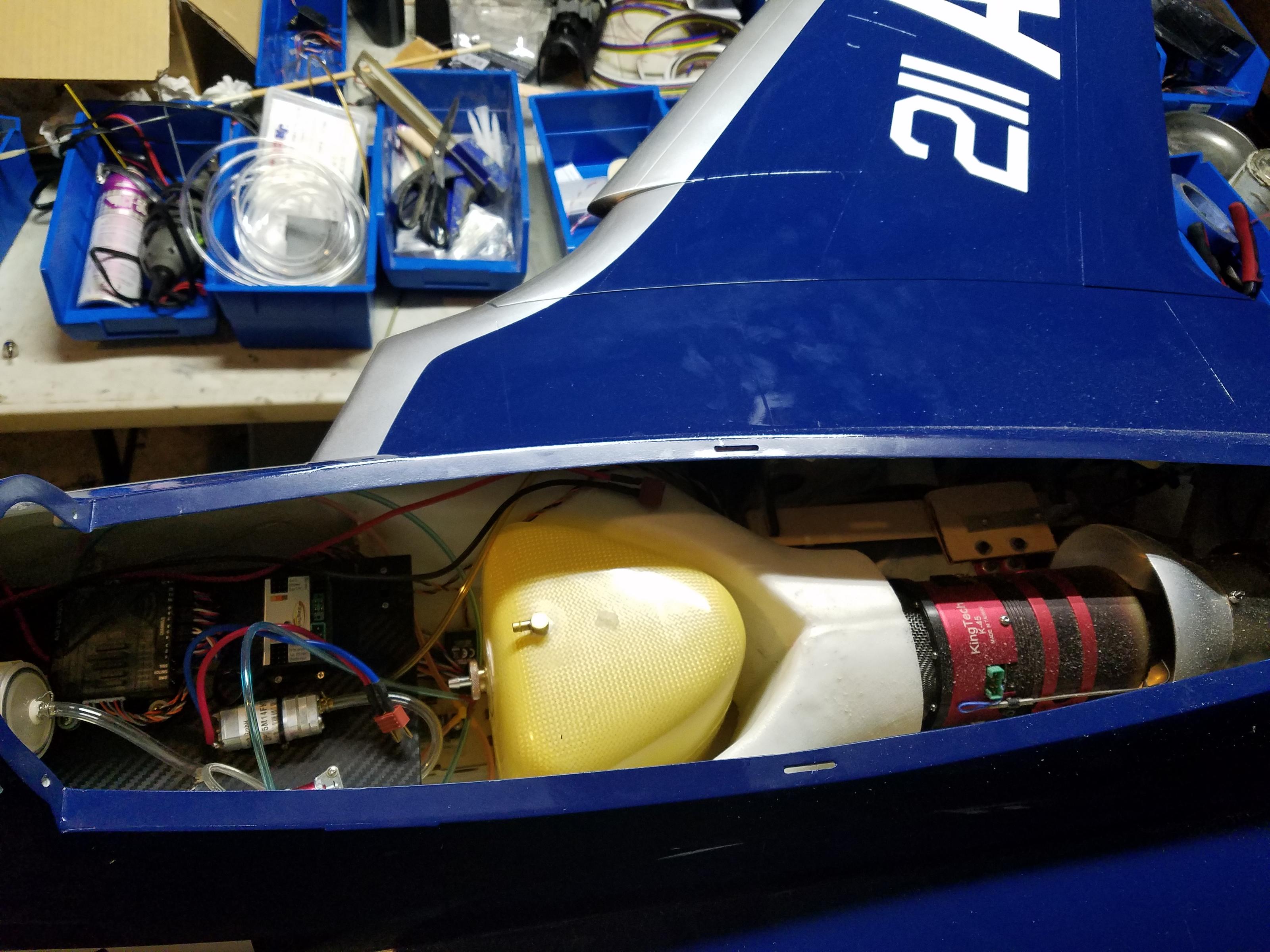

Been cranking on the plane for a little over a week now and its about ready for maiden. This plane can easily be built in 2 weeks of doing a little in the evenings.
Used all power box wire because of its heat resistance. All custom made servo leads so I don't have connectors all over the place.
Used spektrum mini servos in tail and for nose steering.
Fuel tank is done using BVM Kevlar tank fittings kit. I don't take any chances with the fuel system. Because of the shape of the tank the clunk looks like it has a chance to suck onto the sides depending on orientation. So I cut an extra slot in the bottom of the clunk so it won't slow fuel flow down.
