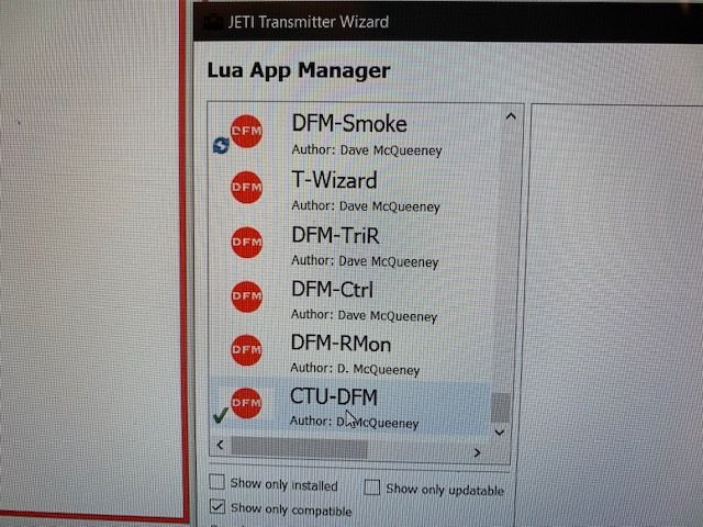

I did some more learning today and found out I miss understood the Lua app manager in Jeti Studio. I'm a little slow on how all the cool stuff works!
Here is how you download the Lua app for the Xicoy telemetry adaptor.
Go to Jeti Studio and connect your transmitter
Under Tools select Transmitter WIzard
In Transmitter wizard select Lua App Manager
Scroll to the bottom and select CTU-DFM app and load it into your transmitter. The XIcoy telemetry adaptor must have the latest firmware to display the turbine status messages. Enjoy and good luck!
